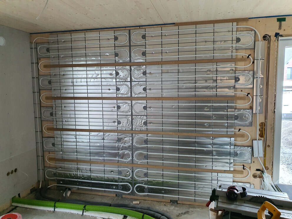

Just as an idea, here is a picture of my currently installed wall heating system. The system can also be installed on the floor. The total system height is only 2.5cm (1 inch). On top of that, dry screed (Fermacell boards) can be laid directly, plus tile, resulting in a total thickness of about 6–7cm (2.5–2.75 inches). Additionally, there is no water exposure like with cement or anhydrite screed, and the installation is completed quickly. DIY installation is also easily possible.

Just as an idea, here is a picture of my currently installed wall heating system. The system can also be installed on the floor. The overall system height is only 2.5cm (1 inch). Dry screed panels (Fermacell boards) can be laid directly on top, plus tiles, resulting in a total build-up of about 6-7cm (2.5-2.75 inches). Additionally, there is no water exposure as with cement or anhydrite screeds, and the installation is quick. Doing it yourself is also possible with some effort.
Yes, this would roughly be the alternative to a hydronic (water-based) underfloor heating system. With an electric underfloor heating system, we would still need our radiator to warm the space, and the electric system would be used mainly to warm the tiles, since our tiles get very cold. Ideally, an electric underfloor heating system with the lowest power rating should be chosen to avoid high energy bills. However, I still prefer the water-based underfloor heating system.
