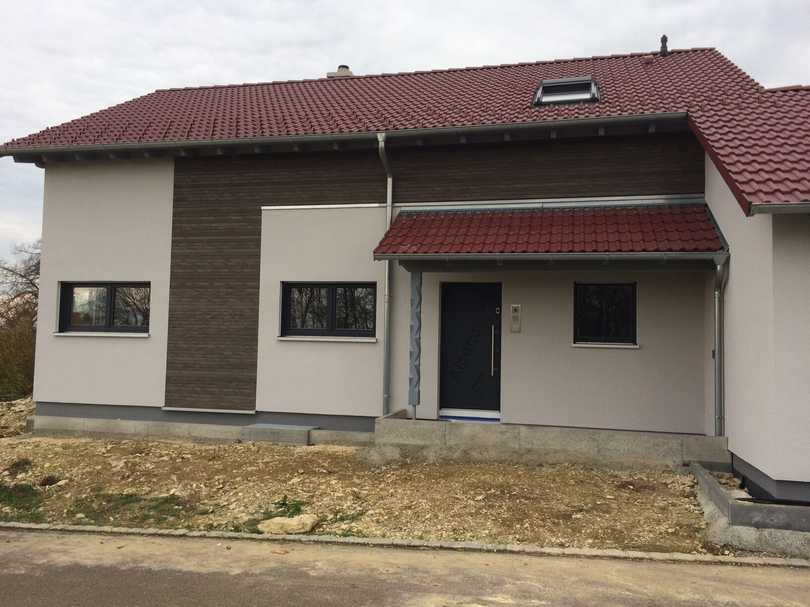

I also can’t imagine that an attached wood cladding would look good. It’s just an attached “board cladding.” For our wooden facade, it was important to me that it is flush-mounted.
Modern single-family house with red tile roof, brown wood cladding, and entrance area.

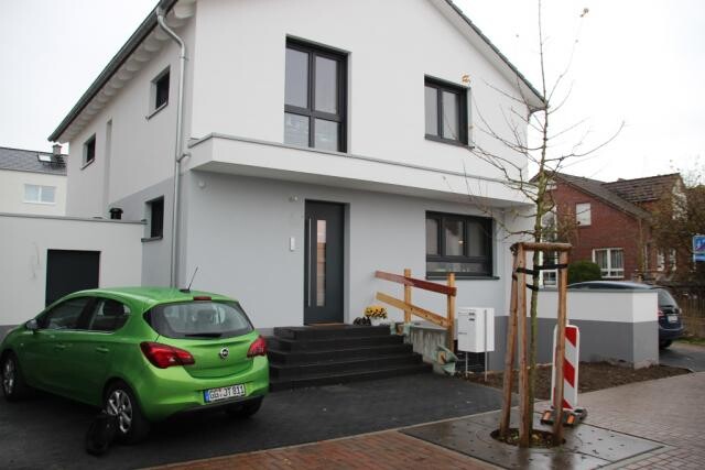

Here are two pictures of the project. We had considered cladding the light gray area beneath the entrance canopy with wood. In the end, we decided not to do this during the house construction, but we are now thinking about adding it later.
Vorderansicht eines zweigeschossigen Einfamilienhauses mit Giebeldach und Treppe
Moderne weiße zweistöckige Hausfront mit grauen Akzenten; grüner Pkw vor Treppenaufgang.

The problem here is probably the reveals, which you don’t want to leave plastered, and then it gets tight...
