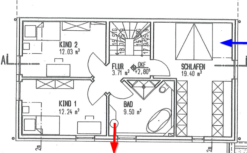

If it turns out that the solutions mentioned above are not sensible for acoustic reasons, I have also considered an alternative with separate supply and exhaust units in different rooms. As far as I can tell, these unidirectional units are often quieter and also have a higher standard sound level difference.
(Furniture placement in the floor plan does not correspond to reality :-) )
Would such a setup be practical in a typical semi-detached house floor plan? And could the bedroom door remain closed permanently in this case?
