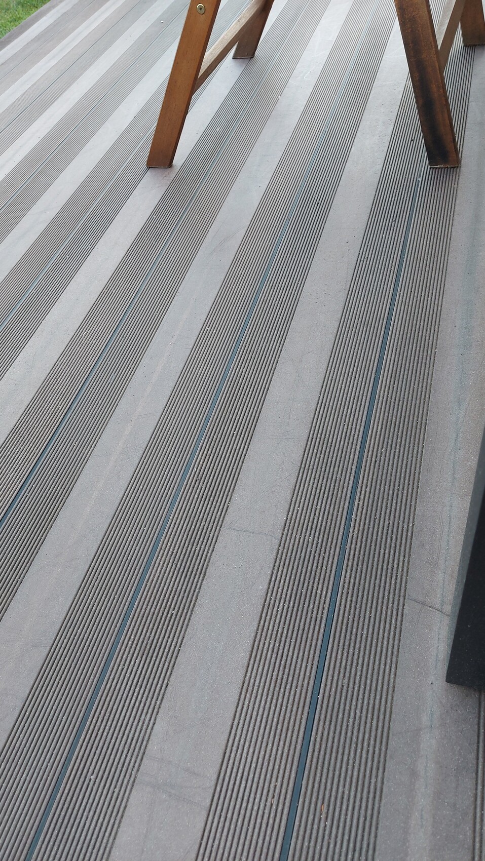

So far, I haven’t found any WPC decking boards that I liked and that at least resemble wood in appearance.
I’m a bit surprised by the experience with the table since Resysta, among other uses, is employed as decking material for pool areas in hotels because it is supposed to be very durable.
