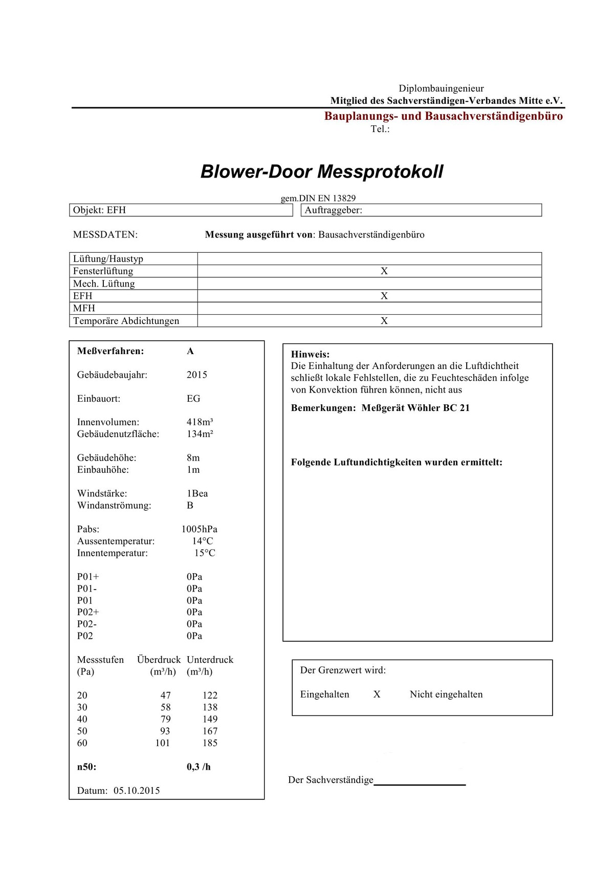

Still, I’m surprised by the 0.3 reported by @Basti2709.
The larger the house or apartment, the easier it is to achieve low values because the air change rate is calculated based on the total volume. How big was the house, @Basti2709? That was the measurement result... I have removed all personal data.
