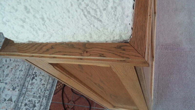

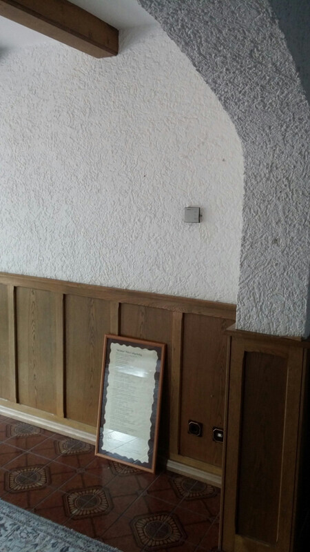

I’m new to the forum and hope you can help me. I’m moving into my grandmother’s old house soon. The wall plaster there is a bit problematic. Up to about 1 meter (3 feet 3 inches) high, the walls are covered with wooden paneling, and behind that is only a thin base plaster. Above the wooden panels, the wall was coated with a very thick rustic plaster, which has apparently been painted over several times by now. I’ve attached two photos so you can get an idea.
I definitely want to re-plaster the entire wall.
Now I’m wondering if I should remove the rustic plaster throughout the living area (perhaps using a grinder?) or if I could simply plaster over the rustic plaster. Is it even possible to plaster directly over rustic plaster?
If it is possible, I would have the problem that I’d need to apply a noticeably thicker layer of plaster on the lower part to bring the entire surface to the same level.
Do you have any advice for me?

This looks like well-crafted paneling. Would it be an option to replaster the upper part and paint the paneling white?
Polle 196728 Oct 2014 08:14If you want to remove the paneling and plaster over it, you need to keep in mind that you won’t be able to get a seamless transition; the joint edge will always be visible. Otherwise, you would have to remove all the existing plaster to achieve a clean finish. From my point of view, I would paint the paneling, possibly remove the upper edge, or do as described above.
