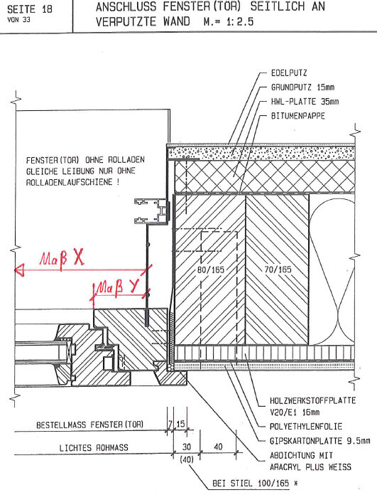

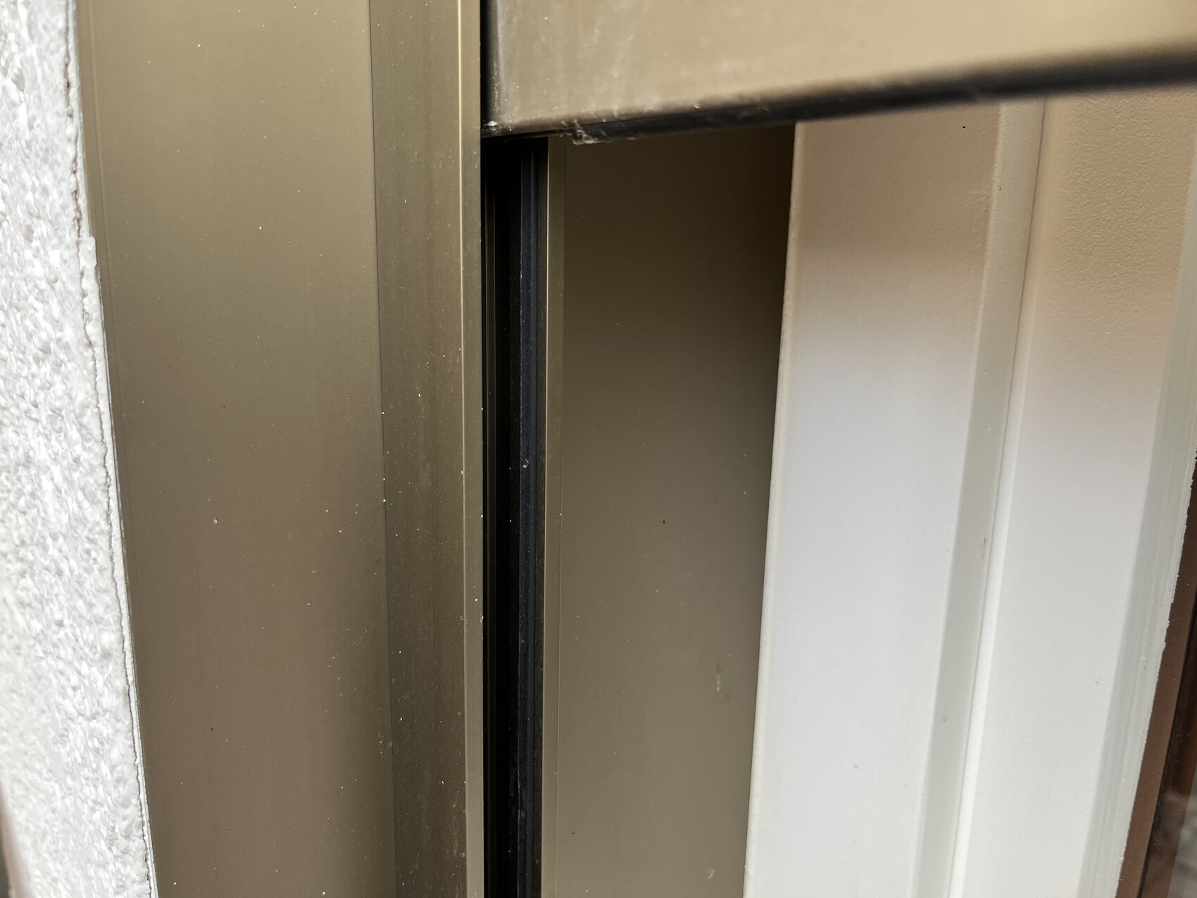

Issue 2: The existing windows have an outer reveal and roller shutters that are to be retained. The window companies we have spoken to so far say this is possible but of course cannot guarantee it. However, I am concerned that either the reveal will be significantly damaged or the whole installation will be done in a makeshift way and in no case come close to the original condition in terms of quality, sealing, or appearance. Does anyone have any idea if this can even work together with a wooden-aluminum window variant and such a reveal?
Close-up of a brown door/window frame with an open gap and dark interior
Technical drawing: cross-section of a window/door in a wall structure with insulation and coatings.
Technical section drawing of a mechanical component with grooves and dimensions in mm.
Grateful for any advice...

It is a WeberHaus timber frame house. WeberHaus would also handle the work but currently has no availability for the foreseeable future, so we have to go through third parties. Their statement is that the windows can be removed from the inside without damaging the reveal. But how will the new windows be properly installed and sealed afterward?

Wow, from when exactly? That must have been "before my time," I don’t recall any metal-clad reveals.
But how are new windows then properly installed and sealed?
That’s exactly how I see it, with the same concerns. I would pass this question on to the architect.

Oh, from when exactly? That must have been "before my time," I don't recall any metal-clad reveals.
The construction year of the WeberHaus is 1994 with original windows.
I see it exactly the same way, with the same concerns. I would forward the question to the architect.
One we haven't had or needed so far... :-(

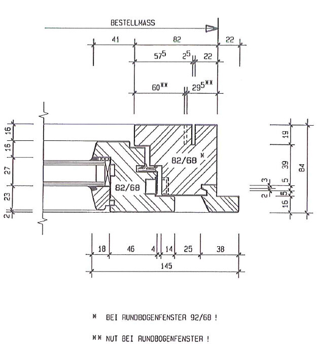

Hello, the drawing above was very helpful to me – thank you very much.
Are there also cross-sections from the top and bottom (windows and doors)?
Thank you in advance.
