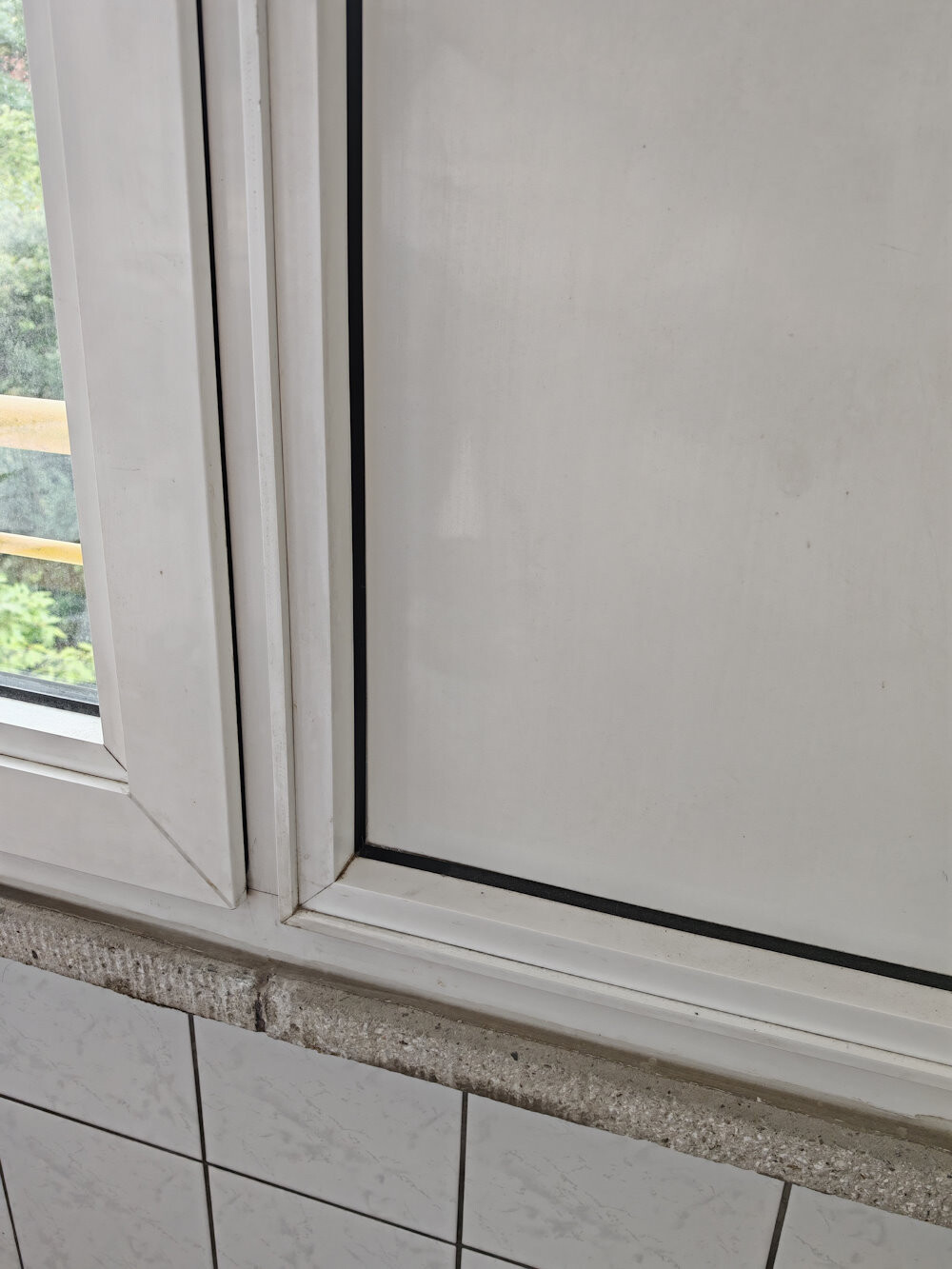

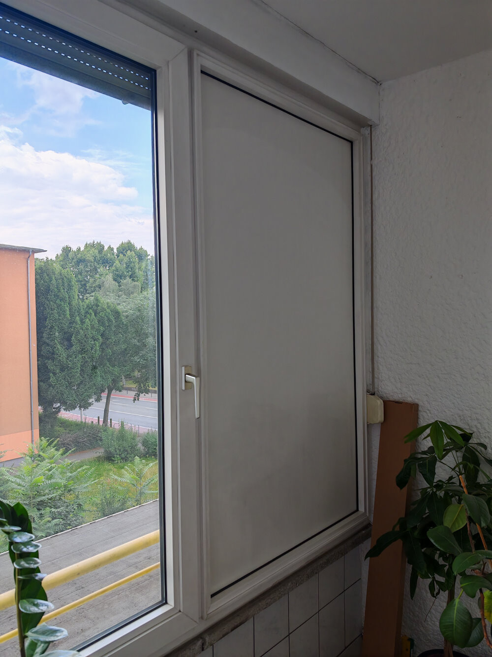

I recently moved into an apartment and have a fixed window panel in the conservatory that is currently filled with a plastic sheet.
I would like to replace this with a glass pane. However, I first need to remove the plastic element.
Here is my problem: Since I don’t know how the locking mechanism works, I have been unable to remove the panel.
Therefore, I’m asking for tips on how to replace the pane or how to open the trim.

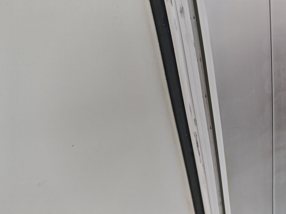

I have already tried prying off the side strips, but they seem to extend behind the plastic sheet and don’t appear to be standard glazing beads that can simply be removed from the front.
I would appreciate any advice, including videos or search terms I could use. Unfortunately, I don’t know the window manufacturer, model, or the name of the locking mechanism.

from the inside
Closed window with white roller shutter inside; view outside of trees and street.
from the inside
White window frame with glass pane, below a stone window sill and white tiles; green visible outside.

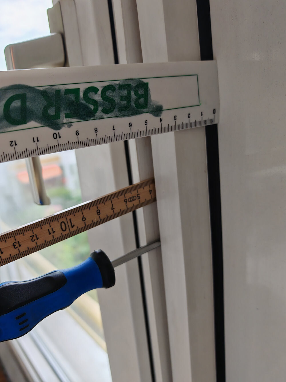

from the inside (while attempting to pry off the strips)
Close-up of a window frame with tape measure (inches) and screwdriver.

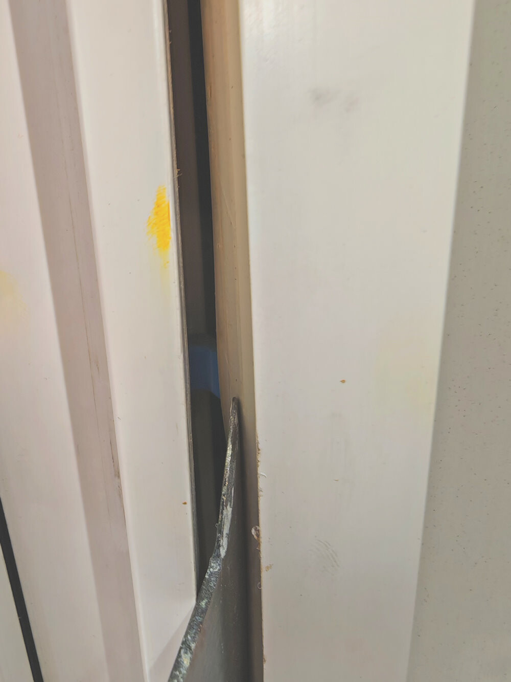

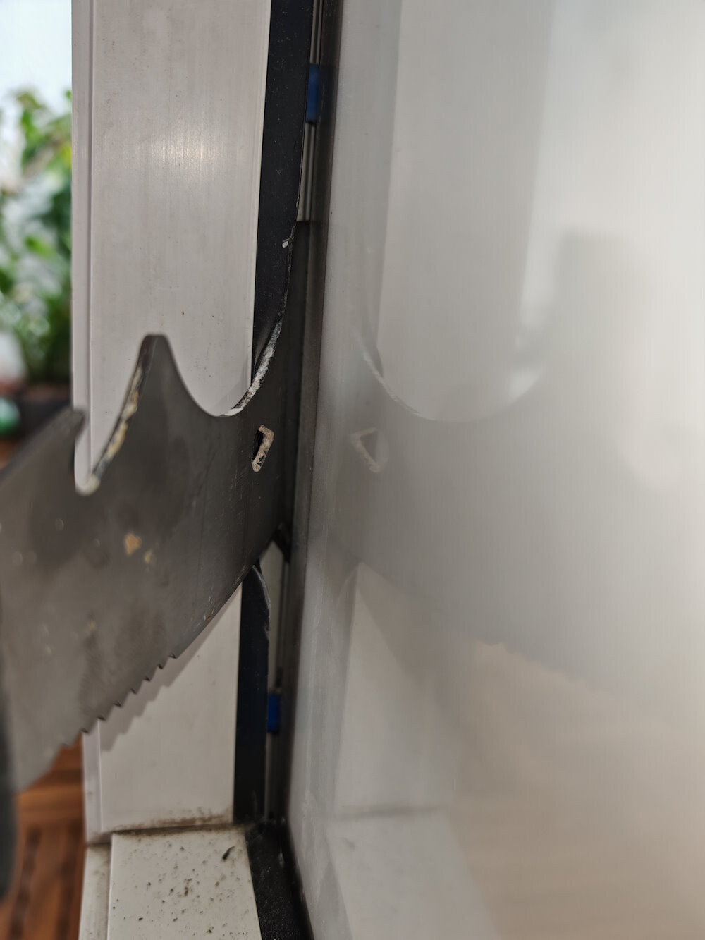

Thank you. Unfortunately, another issue has come up. Unlike most other videos, I seem to have these blue locks. Does anyone know how to remove the glazing beads? Do I need to pay special attention to these locks?
I also have to use a lot of force to remove the glazing beads.
Close-up of a gap between white door frames; yellow paint spot, metal tool visible.
Close-up of a coarse-toothed saw blade in the gap between white frame and smooth surface.
