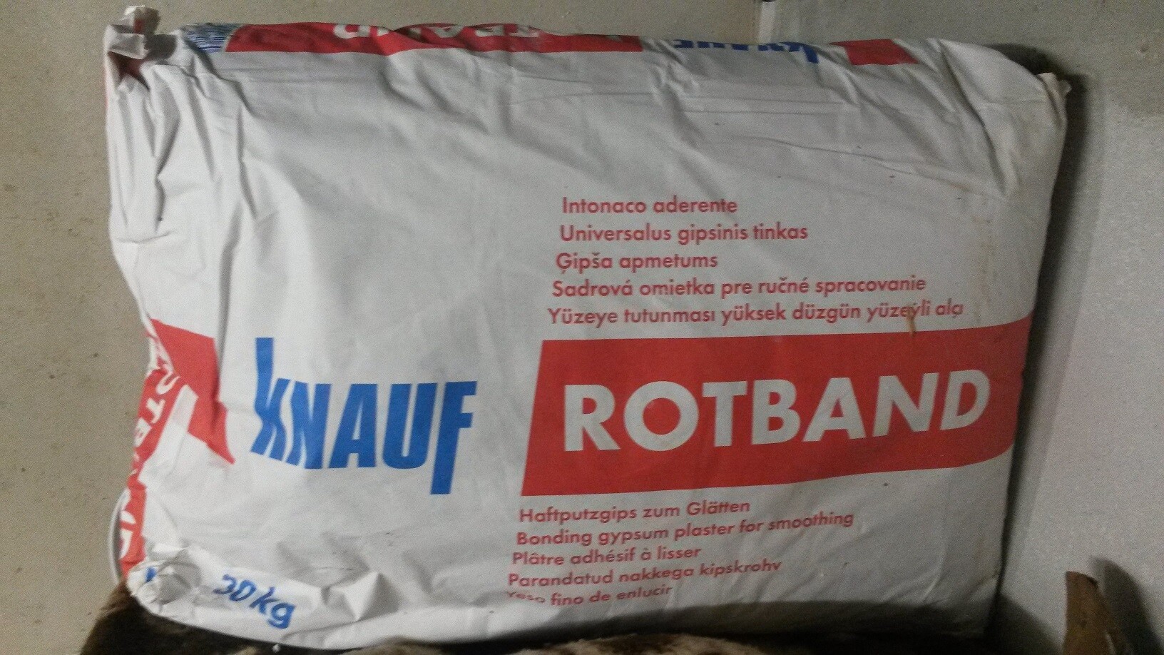

In our case, the plasterer applied a thin layer (a few millimeters) of plaster (Rotband?) over the entire wall and then re-textured it completely. For about 10m² (108 ft²), the skilled plasterer took less than 2 hours, and it looks like new...

What is red heat damage?

Gartenfreund16 Dec 2016 05:36Just search for Rotband, not Rotbrand.
Peanuts7416 Dec 2016 07:39Why is your mason going crazy? Besides, I thought it was just the toilet â how big can the room be then??? Rotband is a bonding plaster; I donât see any other option if you want to make sure nothing is visible afterward.

What is Rotband?
