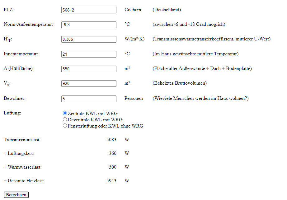

jens.knoedel16 Feb 2024 17:53jx7 schrieb:
Desired heat pump:
- Modulating heat pump
- Capacity smaller than before (3–12 kW)
- Hot water tank larger than before (165 liters)
- Passive cooling function
- Electric heating element for emergency operation
- Connection for the 10,000-liter (2,642-gallon) basement pool (max. 31°C (88°F)) possible (currently connected via low-temperature heat exchanger to the heat pump) If you hadn’t just started the last thread and already had a borehole (for passive cooling), my advice would have been:
Take a weekend, buy a 7 kW monoblock today (which will then be delivered early next week for under €4,000) and connect it.
But a brine-to-water heat pump is a bit more complicated, and you’ll have to plan for delivery times and tradespeople availability. Difficult situation.
Let’s first look at your heating load calculation:
- Postal code unknown
- Building envelope area unknown
- Desired room temperature unknown
- Type of ventilation unknown
==> I roughly estimated everything
==> I therefore see a 5 kW heat pump for you, possibly a 7 kW one that modulates low enough.

Thank you very much for your response!
Here are the missing details!
Postal code (ZIP code): 55257
Building envelope area: unknown
Desired indoor temperature: 22.5°C (72.5°F)
Ventilation: Mechanical ventilation with heat recovery
Allthewayup17 Feb 2024 07:32@jens.knoedel
