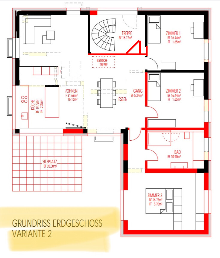

We (24 years old female & 29 years old male) want to renovate a house inherited from his parents. We have already had several discussions with the architect and are now interested in your opinions. The exterior walls of the house will remain and will be partially extended. The attached images show what is new (in red) and which walls will remain (in black).

What do you particularly like? Why? Bedroom and living areas separated
What don’t you like? Why? No guest bathroom on the ground floor
Price estimate according to architect/planner: 430,000€
Preferred heating system: air-to-water heat pump
The spiral staircase is already present in the house and must remain for cost reasons. The architect, however, wants to renew it and highlight it through the large entrance area.
We are very curious to hear your thoughts!

kaho674 schrieb:
Sorry, I really don’t like this. If I need to use the bathroom while watching TV, it’s a shorter walk across the yard than through the house. That long narrow corridor seems like a waste of space to me. It’s also not really clear what the starting situation is. Maybe you could redraw the current layout, because if I remove all the red parts, there’s no house left. It would be best if you included measurements, then we could experiment a bit. 🙂
Does the kitchen have to be in that back corner? How flexible are you?
I find everything reasonable with the existing structure and the new parts.
And the distance from the sofa to the toilet isn’t actually that long. It only seems that way 😉

I find everything makes sense regarding the existing structure and the new parts.
And the distance between the sofa and the toilet isn’t actually that long. It just seems that way 😉
With that mega mouse corridor? Mmmh.
kaho6747 Dec 2017 13:09
Ok, I just converted this huge hallway into a smaller one and rearranged the furniture. I think it works better this way. The kitchen with the window would need to be redesigned, I just copied it in here.

kaho674 schrieb:
Okay, I just changed that large mouse path into a smaller one and rearranged the furniture. I think it works better this way. The kitchen with a window would need to be redesigned, I just copied it in.
Thank you for your input. We would like to keep the entrance area with the spiral staircase open. Is your suggestion still structurally feasible? We would already have a post or something similar in the living room anyway.
7 Dec 2017 14:01
kaho674 schrieb:
Ok, I just converted this huge mouse path into a smaller one and rearranged the furniture. I find it better this way. The kitchen with the window would need to be redesigned; I only copied it in.
Honey, the shortening was already suggested [emoji2] That’s why I’m responding.
I also like your suggestion, but what bothers me is that the kids would have to pass by the guests in the evening.
You always have to choose the lesser of two evils: I generally don’t like hallways, but if they’re necessary... well, that’s how it is.
I think there are nice lighting solutions that can turn the negative into a positive. Also, a nice wall for a picture gallery [emoji2]
