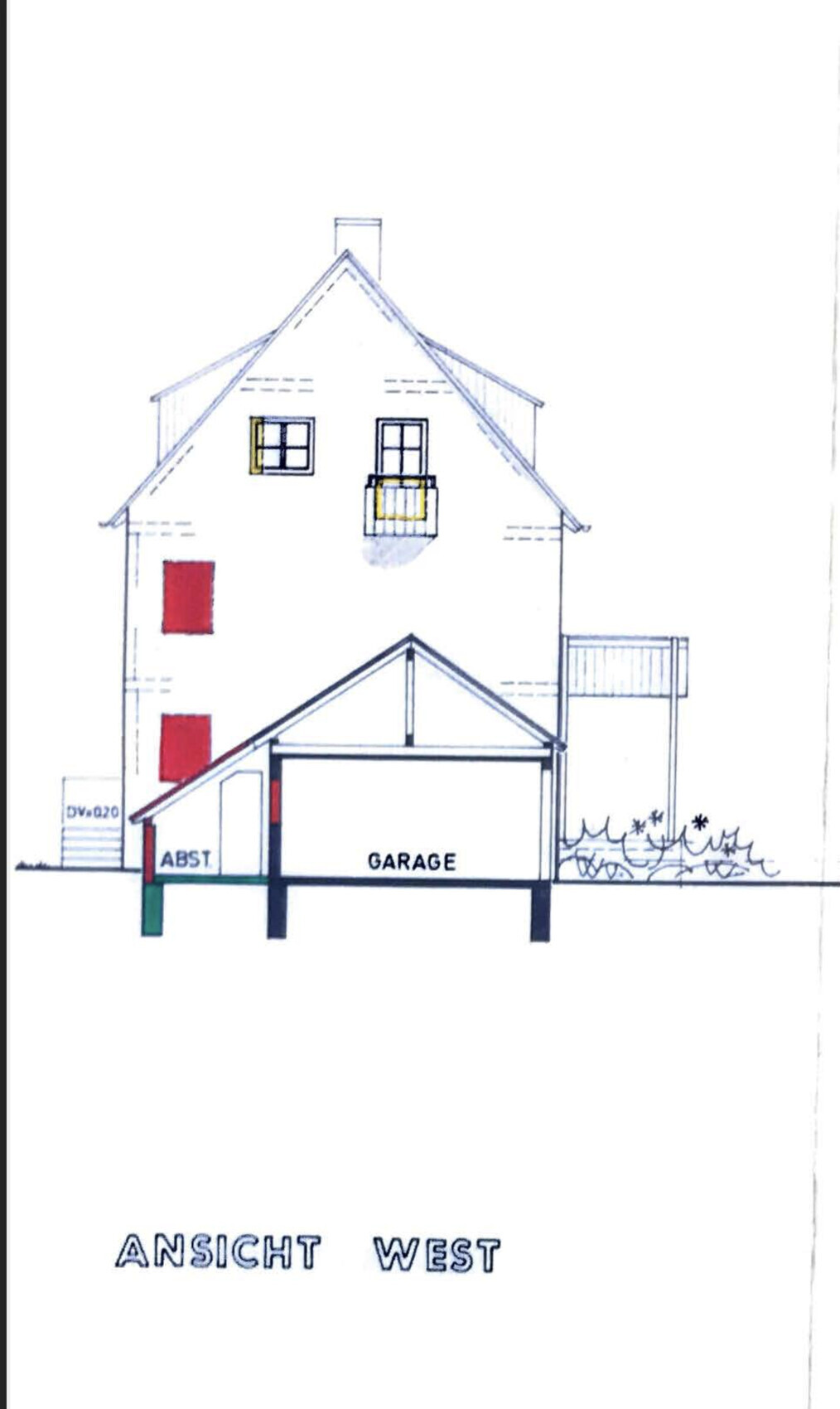

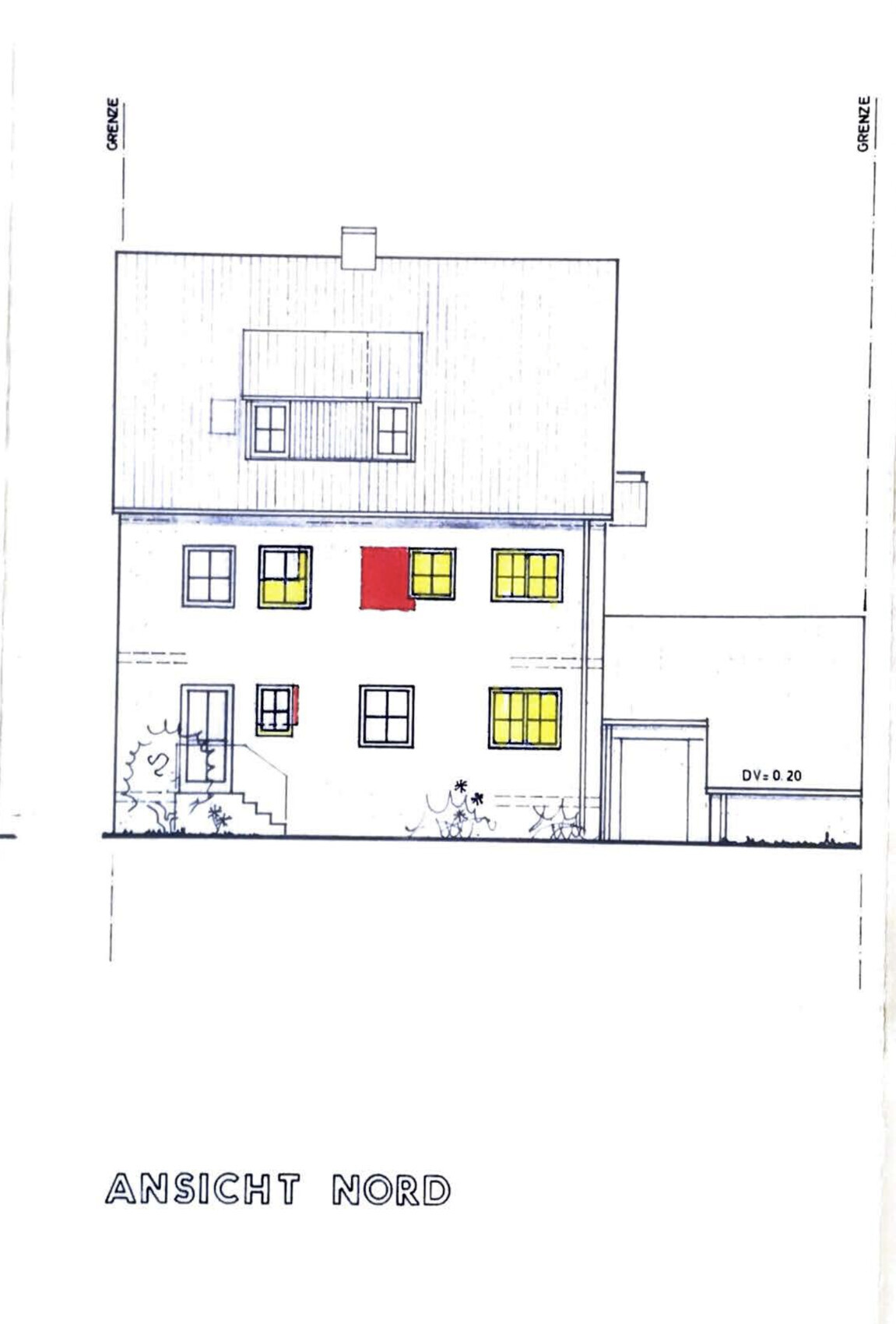

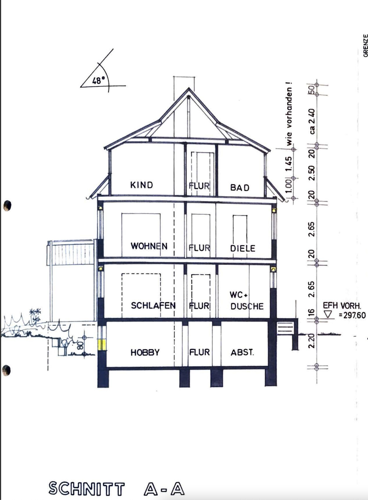

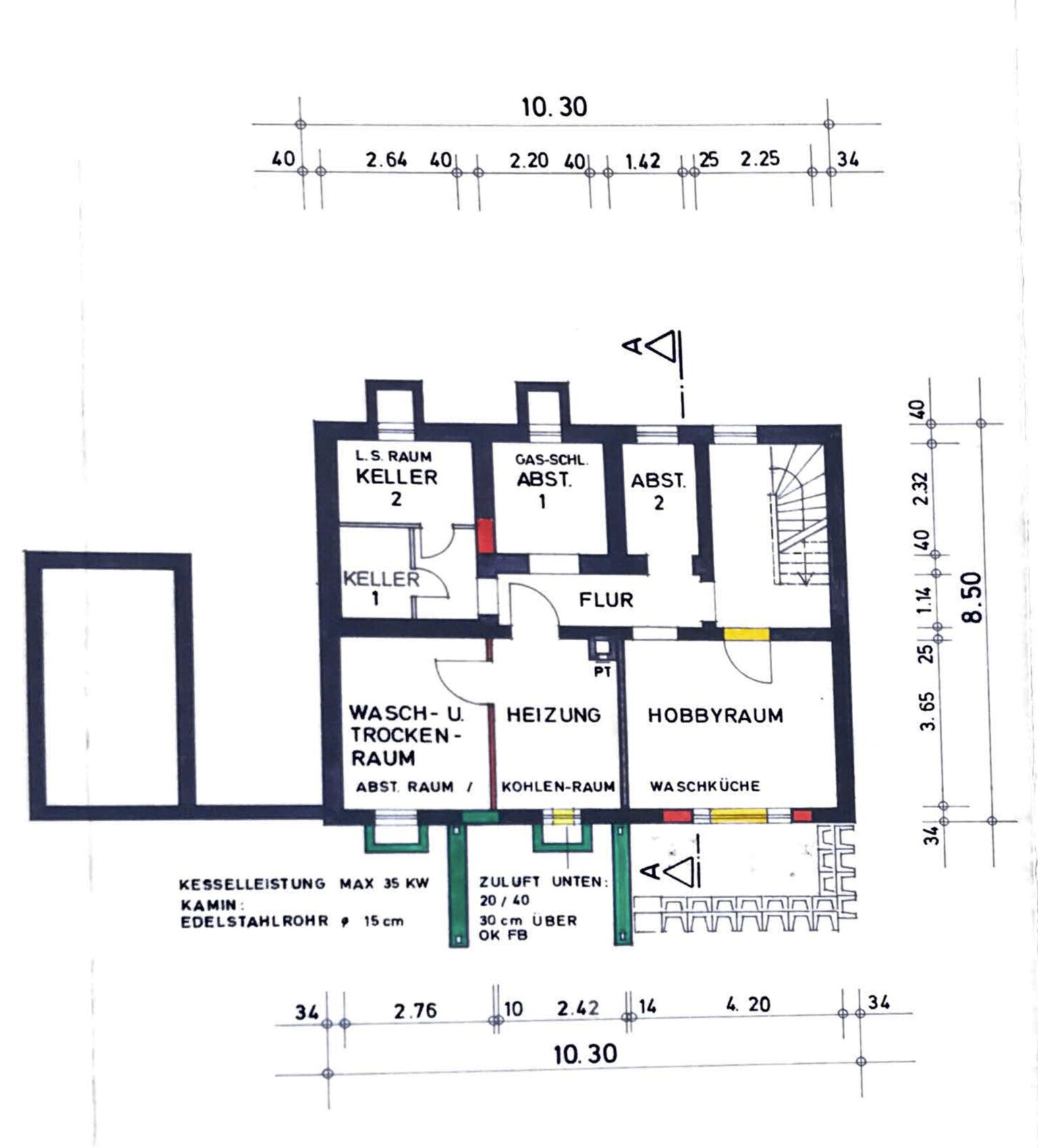

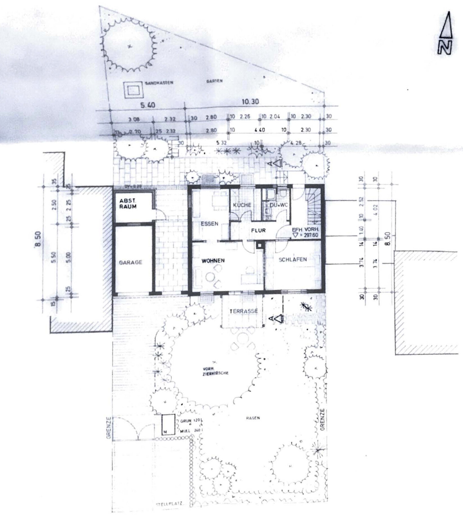

The best we have are the plans from the 1989 building permit application, which were never carried out. I have attached them, [...] (I need to split the plans since unfortunately no more than 10 attachments are allowed..) 1) Who created the drawings in posts 6 and 7 – do they represent one of the Elfmille designs or all belong to the 1989 plans (and were the latter ever approved)?
2) Is the 1989 plan author no longer active and without a successor firm; what was the reason for the project not being realized?

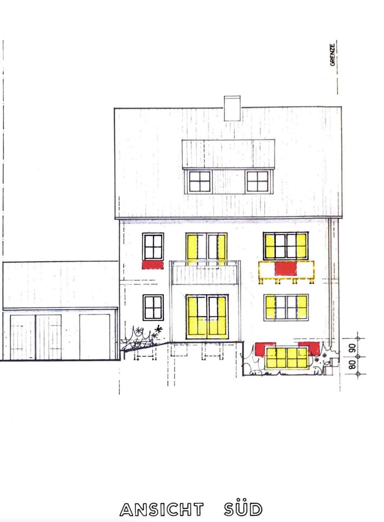

cryptoflam30 Jan 2022 20:1311ant schrieb:
Spent eleven thousand without having received a structural assessment – how does that even happen? *scratches head and shakes at the same time* Yes; unfortunately, I would now attribute this to inexperience and naivety. The architect apparently thought she could work with the old plans.
1) Who created the drawings in posts 6 and 7 – do they represent the eleven-thousand-dollar plan or the one from 1989 (and was the latter ever approved)?
2) Is the 1989 plan author no longer active and has no successor in the office; what was the reason for the project not being realized? Post 6 shows the current plan status and was created by the general contractor’s wife.
Post 7 is the approved but unrealized building plan from 1989. At that time, the plan was already to convert the house into a multi-family dwelling, but my mother-in-law’s father passed away unexpectedly, so the project was not carried out.
The architect from that time passed away in the early 2000s and the office was closed.
cryptoflam schrieb:
The architect apparently said she could work with the plans from back then. If these were properly prepared and nothing has changed since, it might save the effort of taking new measurements. I find a wall thickness of 34 cm (13 inches) worth clarifying, as to which wall structure it corresponds.
cryptoflam schrieb:
Post 6 shows the current plan status and comes from the general contractor’s wife. The new dormer widths might be eligible for exemption. In principle, I consider replacing rooms with special boundary privileges by rooms without such privileges as not approvable. My assumption is that the house is attached on the right side (from the plan view) to the neighboring house as a semi-detached house (?), but not a terraced house (?), so a boundary setback must be maintained from the neighbor on the left side—depending on the federal state, usually 3.0 or 2.5 meters (10 ft or 8 ft) or more. However, here the entire previous 5.4 meters (18 ft) boundary setback is occupied by living spaces that do not have boundary privileges. If I were at your building department, I would probably go on break every time I saw you approaching. A certain level of professionalism must be expected from those authorized to submit plans to the building authority.
How many parking spaces are required in your area? I see two, but often 1.5 parking spaces per residential unit are required. Why don’t you move the carport a bit to the right? As it is now, if two cars are parked there, you won’t be able to access the garden gate.
Does your neighbor have a basement? If not, dealing with drainage might be tricky.
The issue with the setback from the property line, as mentioned by 11ant, has also caught my attention. Has this already been clarified with the building authority / planning department?
