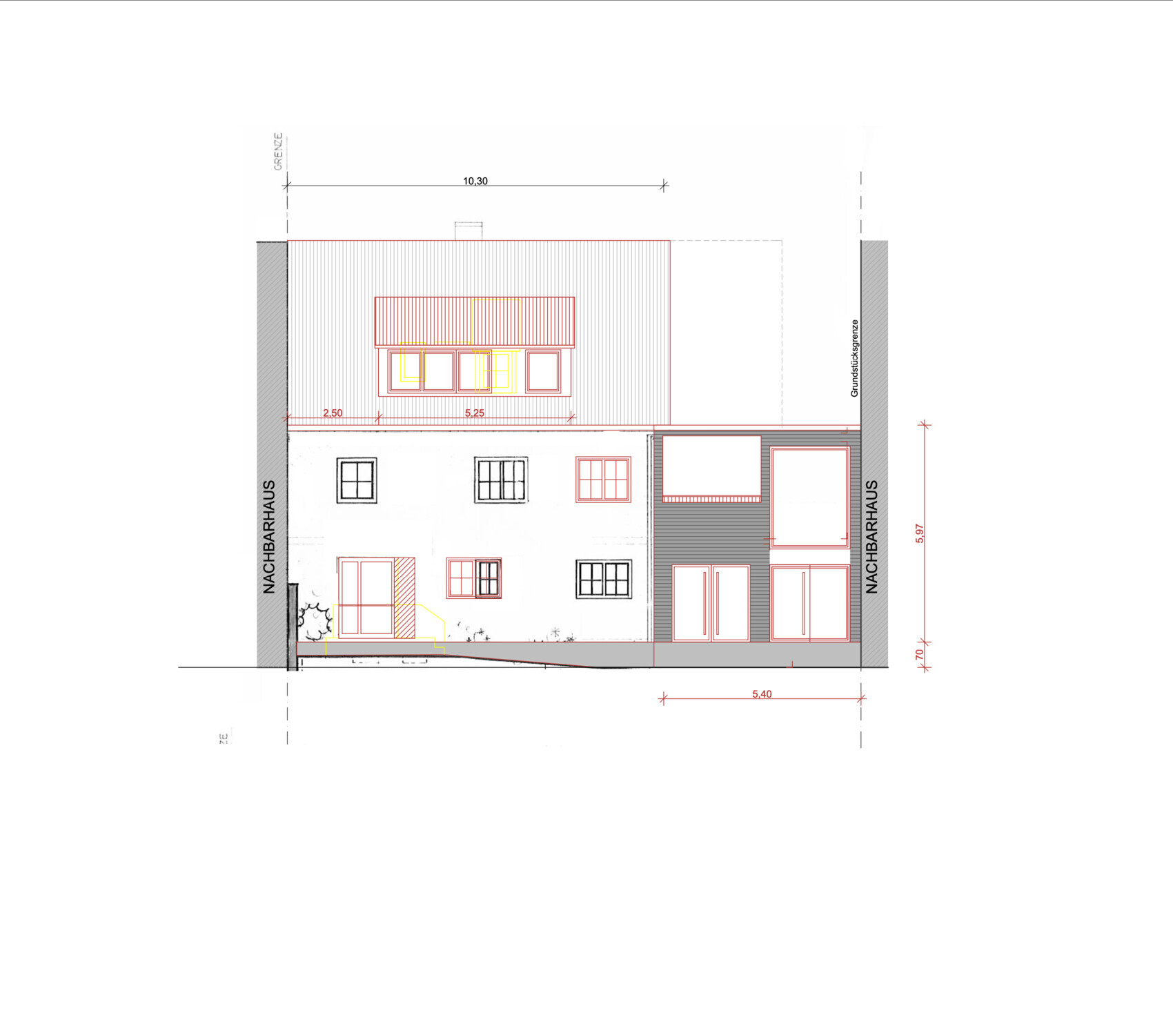

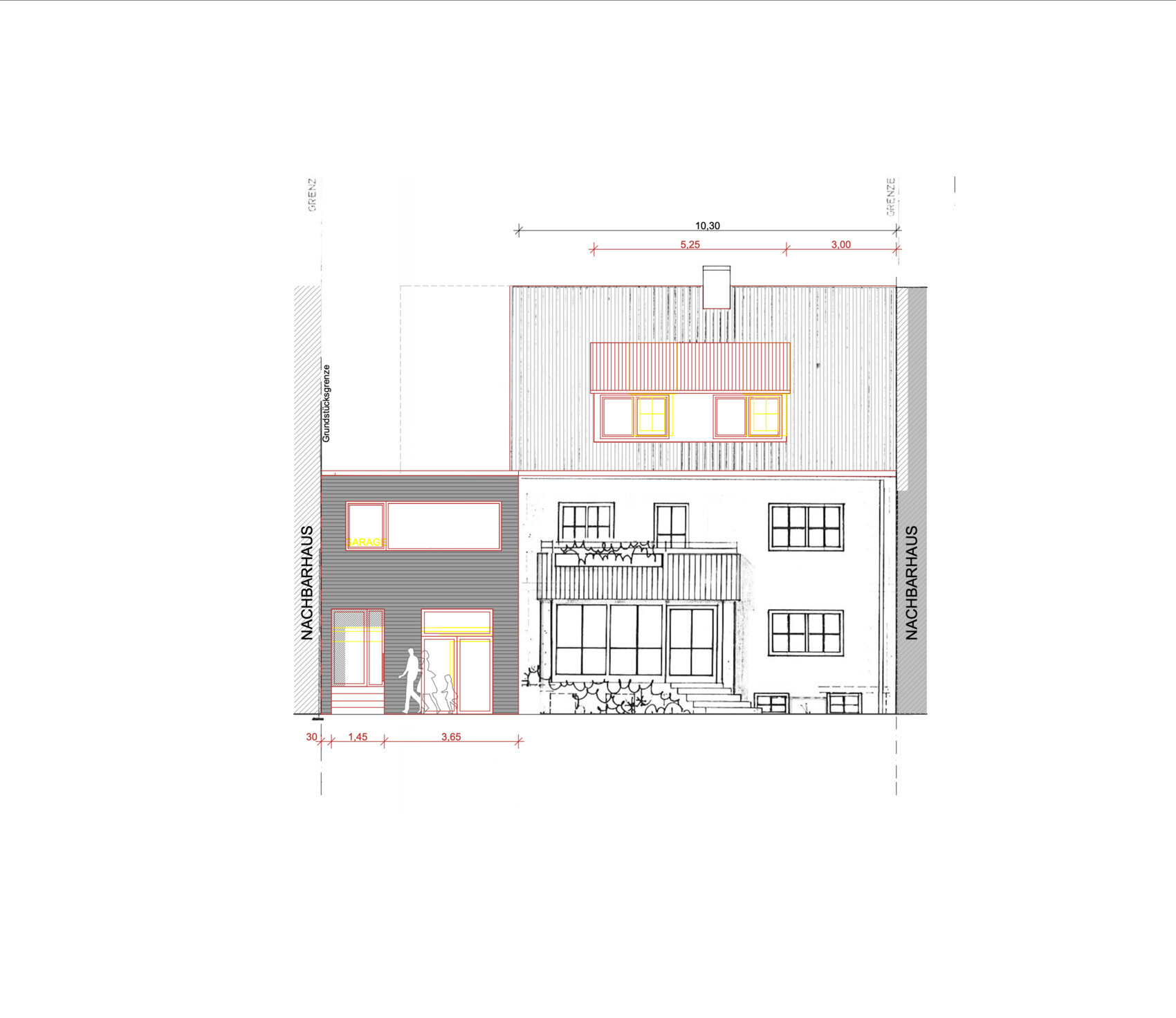

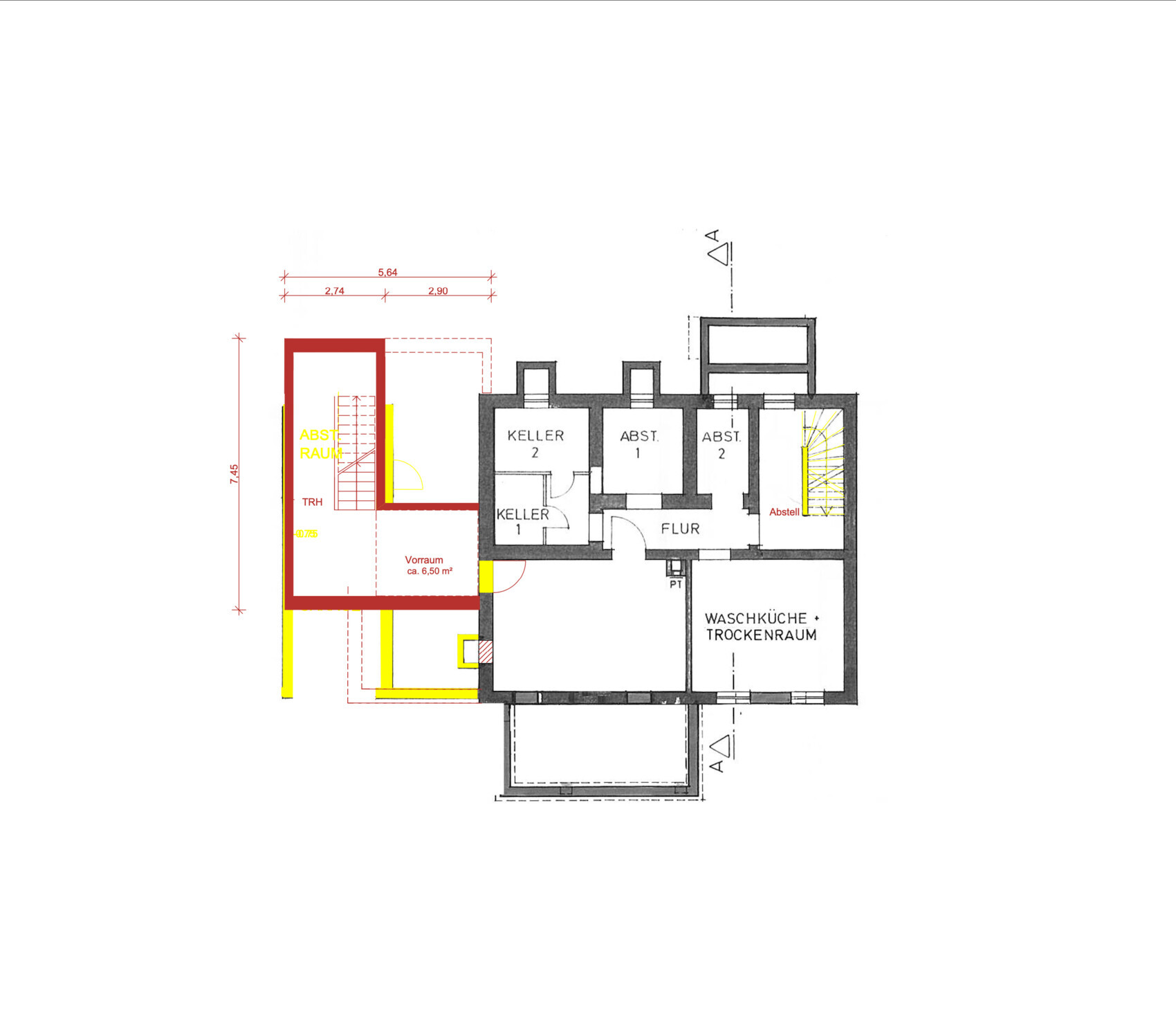

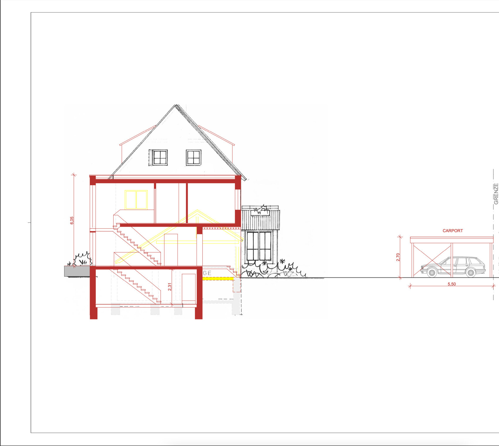

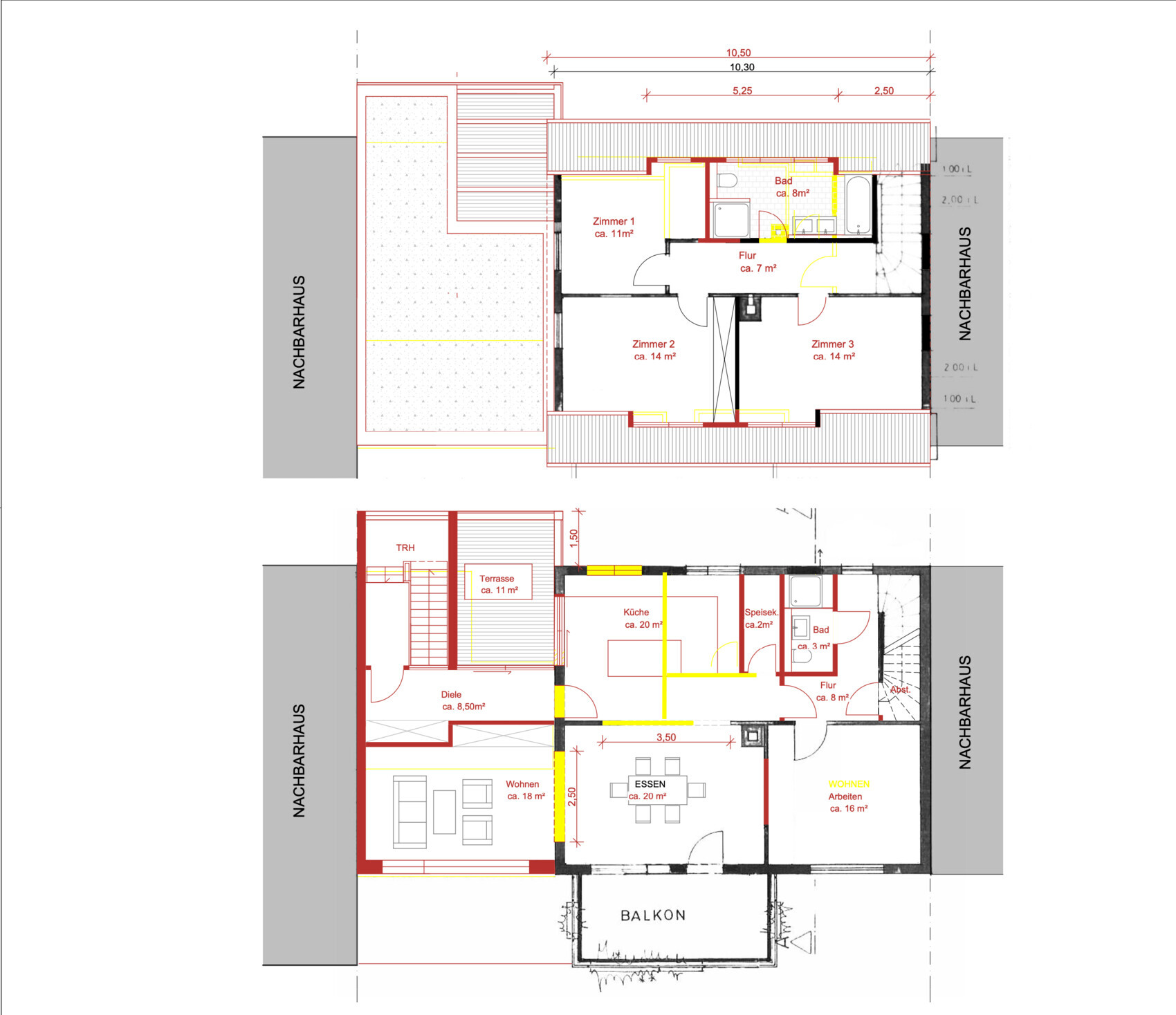

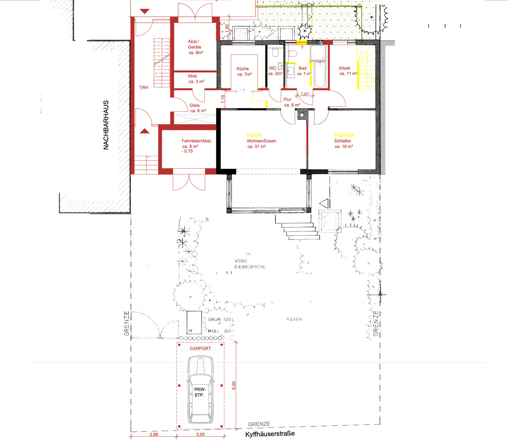

At least with all the mis-, roundabout, and off-the-mark planning, you should have enough material to at least show the as-built plan here, so that people can make a qualified assessment of what might be possible. Please upload the following—preferably as individual images, not huge posters, and preferably not as PDFs—all current as-built floor plans and a cross-section, as well as at least the latest renovation design.
As far as I know, my mother-in-law doesn’t have any current as-built plans. The best we have are the plans from the 1989 building permit application, which was never implemented. I have attached these, but I am also asking around in parallel.
Regarding the plan status,
on the 1st floor unfortunately some walls that need to be demolished (and thereby supported) for the kitchen are missing. I have manually added these so you can better visualize it.
(I have to split the plans, unfortunately I cannot attach more than 10 files.)
Architectural plan: side view of a house with extension, roof and terrace
Architectural cross-section through a two-story house with basement, stairwell and carport.
Floor plan of a house with kitchen, bath, WC, hallway, living/dining area, bedroom, carport and garden.

Basement floor plan with cellar 1, cellar 2, storage rooms, hallway and laundry room.
Two-story floor plan of a house with kitchen, living room, hallway and balcony
