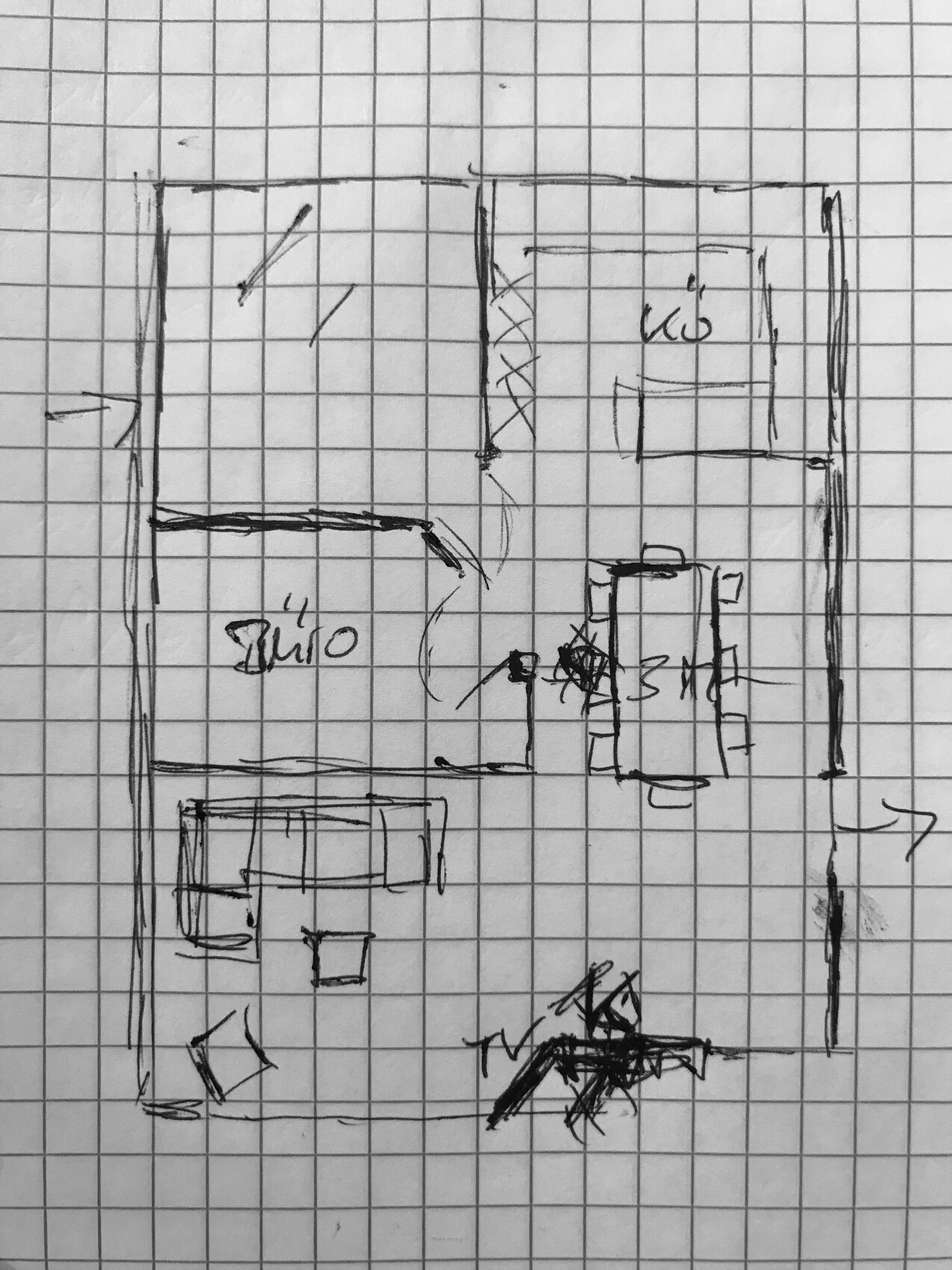

Looking at this plan:
Wouldn’t it be better overall, in terms of spatial layout, to keep the kitchen where it currently is (the original location), but open up the wall, then arrange the walls as shown here, and place the office centrally to the left side of the plan—that is, in the upper part of the living room as an 8sqm (86 sqft) rectangular space positioned horizontally? The missing window in the exterior wall could be compensated for by adding a strip window along the longer wall just below the ceiling.
This would create a chill-out area, a large dining space in the center, and a separate kitchen.
The kitchen would also bring natural light into the room.
https://www.hausbau-forum.de/attachments/Küche-hochschrank-Anbau-trenner-Eingangsbereich-331566-1-jpg.35773/
Wouldn’t it actually be better, in terms of spatial layout, to keep the kitchen where it originally is, but open up the wall, then arrange the walls as shown here, placing the office centrally on the left side of the plan, as a separate rectangular space of about 8sqm (86 sq ft) in the upper part of the living room? The missing window in the exterior wall could be compensated for by installing a strip window below the ceiling on the longer wall.
That way, you’d have a lounge area, a large dining area in the center, and a separate kitchen.
Natural light would also flow from the kitchen into the room.
What do you think? Could you please sketch this? I can’t quite visualize it right now.
