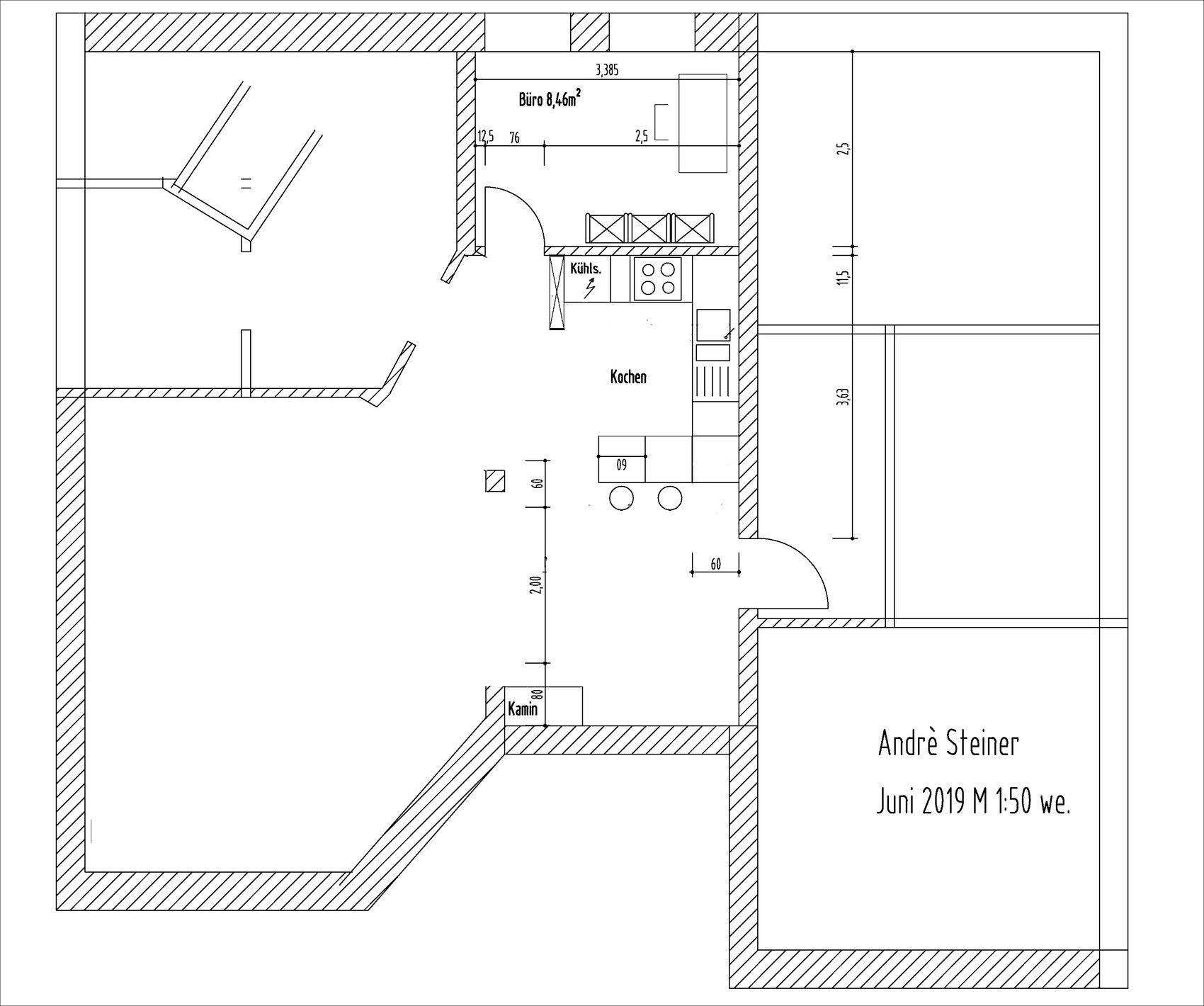

So I have decided to exclude an extension or expansion for now. That means I would like to get the most out of the existing floor plan.
What do you think? I have now arranged the kitchen in a U-shape. I am also considering adding a divider to the entrance area so that the kitchen is not immediately visible. Should the cooking area be positioned differently?
I also don’t think I need to leave 60cm (24 inches) from the wall for the steel beam; I’m estimating 30-40cm (12-16 inches), but the structural engineer should confirm that.
How would you arrange or furnish the living and dining areas?

Is this enough for a kitchen? There’s barely any countertop space between the sink and the cooktop – and that’s the main work area. Only one tall cabinet. The peninsula is just 60 cm (24 inches) deep.
And I don’t think you can reduce the walls as shown.

That’s not a tall cabinet, but a divider from the entrance area. The workspace is where the stools are. Yes, it’s not much, but I don’t see how it could be better.
The peninsula is incorrect; it would be 80 cm deep (31 inches).
Why do you think the walls won’t work?

I would omit the divider. It’s unnecessary. Is the door an arched opening without a door leaf?
I would extend the island all the way to the support and keep it generous. Also, raise it to approximately counter height so that around 1.20 m (4 feet) remains in the middle.
The space near the fireplace will probably only fit a small table for four. Possibly consider a round, extendable table. Or place it against the interior wall of the living room.

Tall cabinet = to the right of your partition wall = probably the refrigerator
Try moving things around yourself in the living room... I don’t think you can find a good sofa/TV arrangement there.
And the dining table, as Yvonne mentioned, doesn’t fit below the kitchen peninsula at all, since that area is the passageway to the private rooms.
