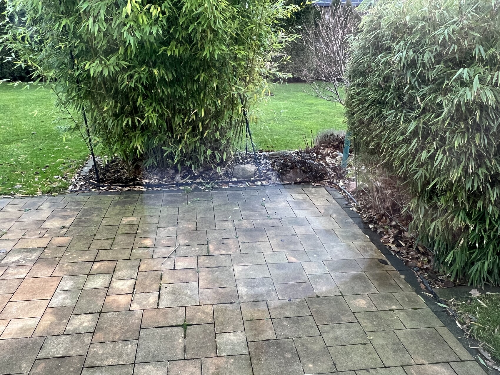

I am planning to renovate my old terrace by replacing the old patio slabs with new ones and edging the terrace with curbstones (currently, there are no curbstones). However, I am facing two challenges where I would greatly appreciate your advice and experience:

- Issue with bamboo and rhizome barrier: Right next to the existing terrace, I have planted bamboo that is contained by a rhizome barrier (see attached photo). My concern is that when dismantling the old terrace, the bamboo together with the rhizome barrier might shift towards the terrace. Additionally, I see a problem supporting the new curbstones with a concrete collar because the bamboo’s rhizome barrier is located directly beside it. How should one proceed in such a case? What techniques or tools do you recommend to ensure stability and keep the bamboo under control?

Just make the terrace a bit smaller, or move the edging stones slightly inward. That way, you'll have room for a backrest on the side facing the bamboo. The gap can be filled with soil later.

Many thanks for your responses @Philfuel and @WilderSueden! That already helps a lot! I also really like the idea of making the terrace a bit shorter.
Do you have any suggestions on how to support the bamboo rhizome barrier while digging there? To make sure it doesn’t collapse? Or are there any other tricks? Since once it’s pushed out, I probably won’t be able to push it back in again.
I’m imagining something that could be clamped in place and then adjusted with a screw mechanism or similar… then I would gradually work on the back support in sections and let it set before continuing with the rest (or something like that)?

motorradsilke11 Feb 2024 15:17What kind of root barrier is that? We also have bamboo contained by a barrier, but it’s a 2 mm (0.08 inch) thick membrane, and the roots have grown through it completely. Nothing would change if you dug up one of the four sides.
If you’re worried, drive some sturdy metal rods (reinforcing bars) into the ground beforehand to hold it in place.

If you’re worried, drive some sturdy metal rods (reinforcing bars) into the ground beforehand to hold it back. Exactly, it is a 2 mm (0.08 inch) thick sheet. The bamboo was planted inside it 4 years ago. It’s possible that nothing will happen. But the idea with the steel rods is great! That’s how I will try it. Thank you so much, you have really helped me!
