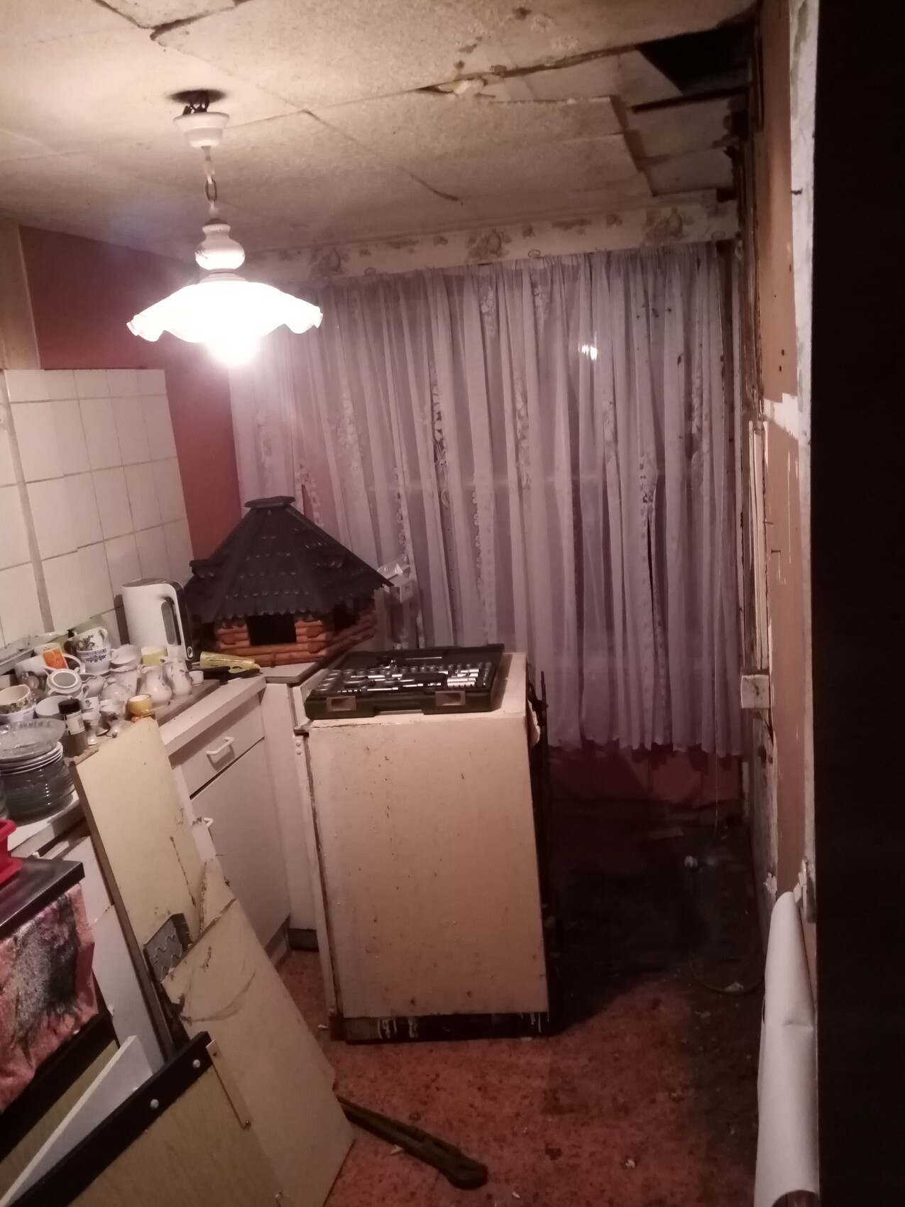

Image 1 = right wall
This is where the kitchen unit will be relocated later; it makes sense since this wall has no windows.

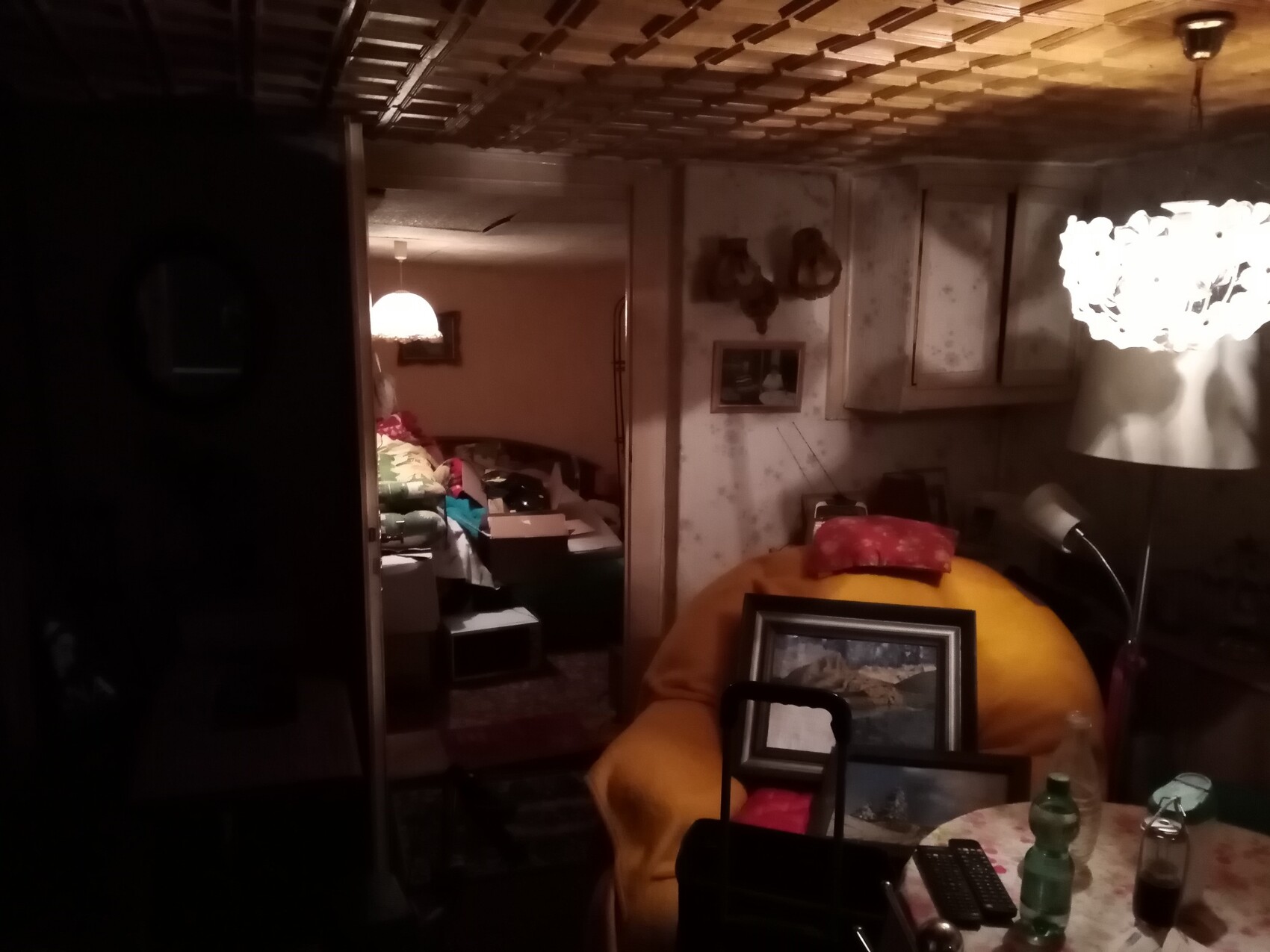

Image 2 = transition to the rear room
The electrical panel will be moved to the back room, which will later be the workshop.

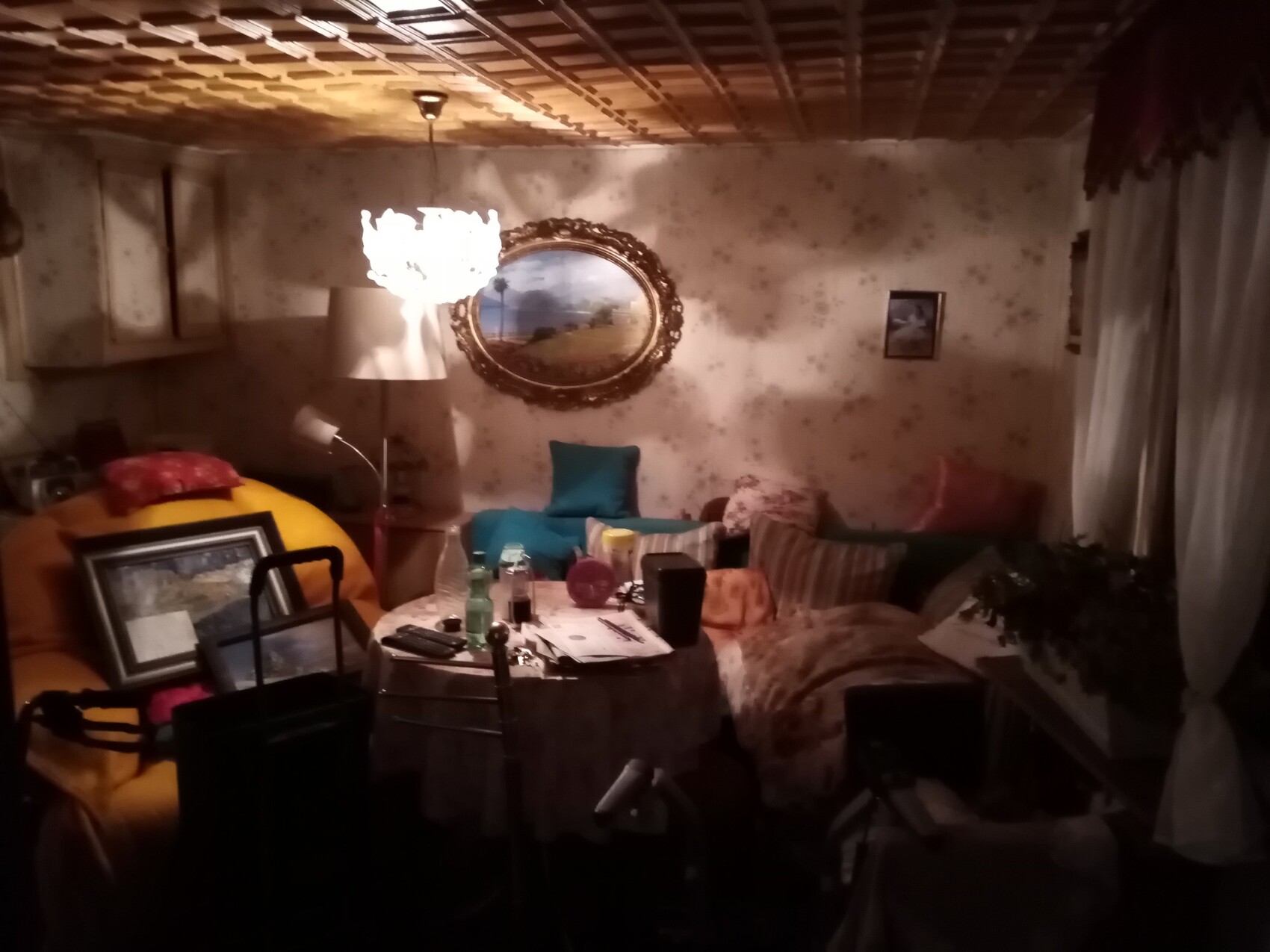

Image 3 = kitchen
The window in the rear wall will be removed, there will be a sofa bed placed there later, and the right wall is the mentioned partition wall, which will also be removed.
Two windows will be installed in the left wall to brighten the room.

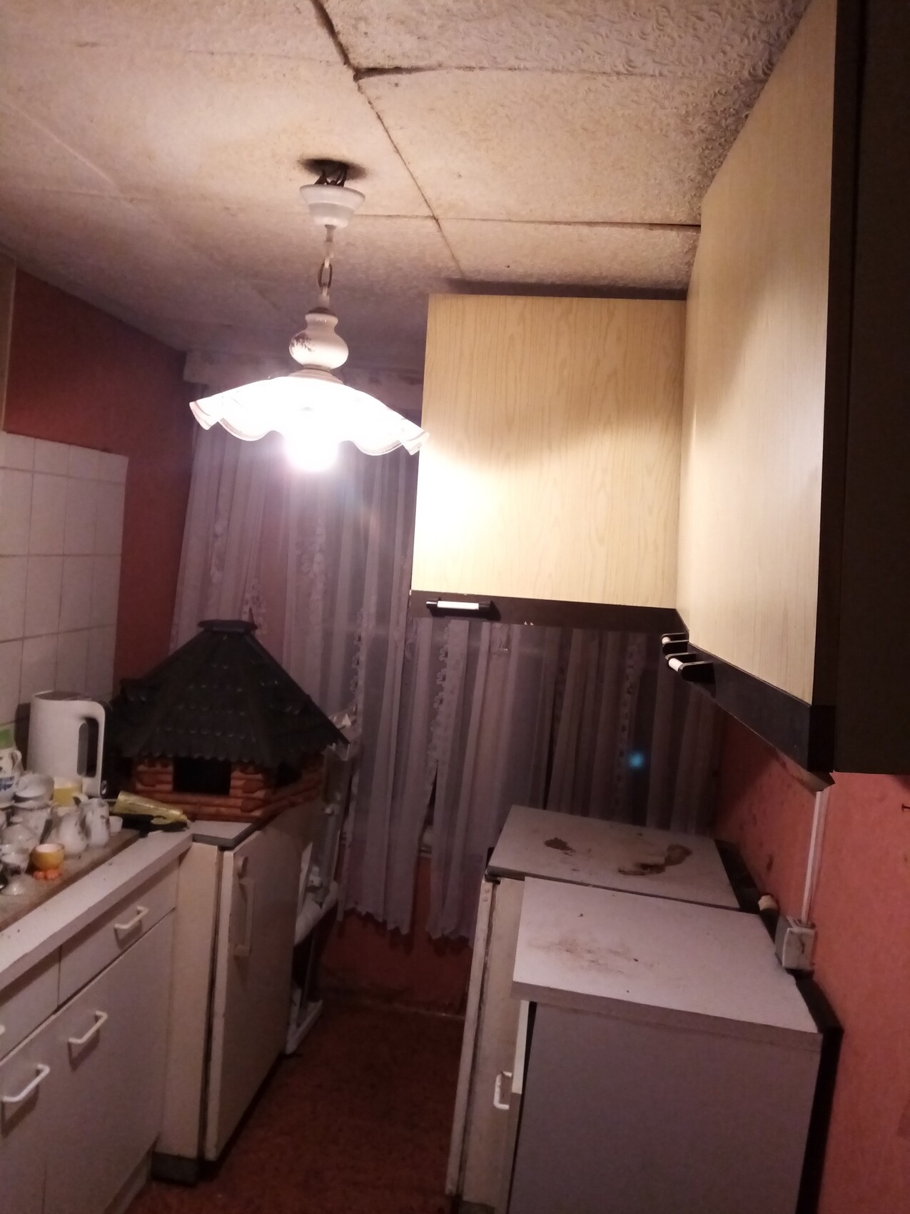

Image 4 = kitchen
I already started emptying and dismantling some cabinets today.
Image 3 = kitchen
Image 4 = kitchen

Buchsbaum20 Dec 2023 07:04The first thing I notice here is the lack of ceiling height. For me, that would be a deal-breaker, meaning demolition and rebuilding. In the long run, that will certainly be more cost-effective.
If it’s an original Bungalow kit like B24, 30, 36, etc., there isn’t much you can remove from the walls—the wooden trusses on top hold the structure together. The more boards, panels, and walls you take out, the faster the bungalow will collapse.
So, just tidy up, paint, and let grandpa keep living there.
An extension doesn’t make sense because that would require new exterior walls and a completely new roof on top.
Build a shed for your plans instead.
