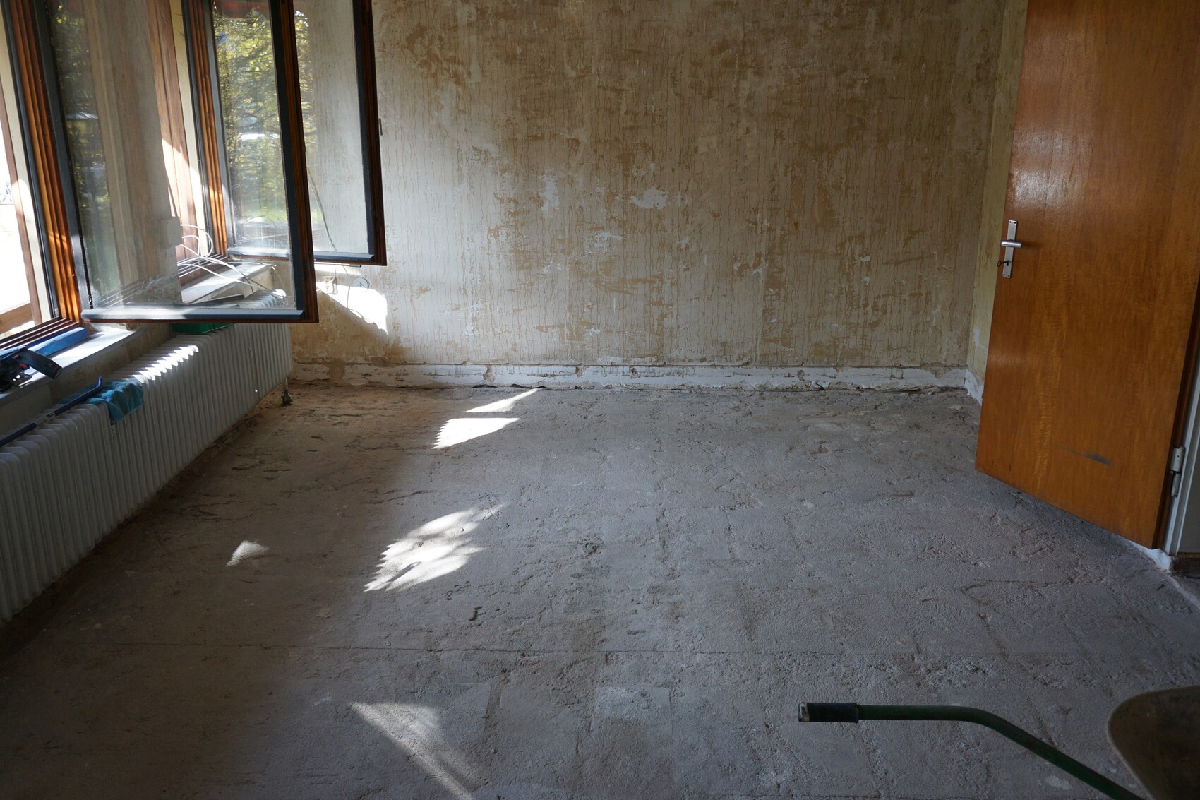

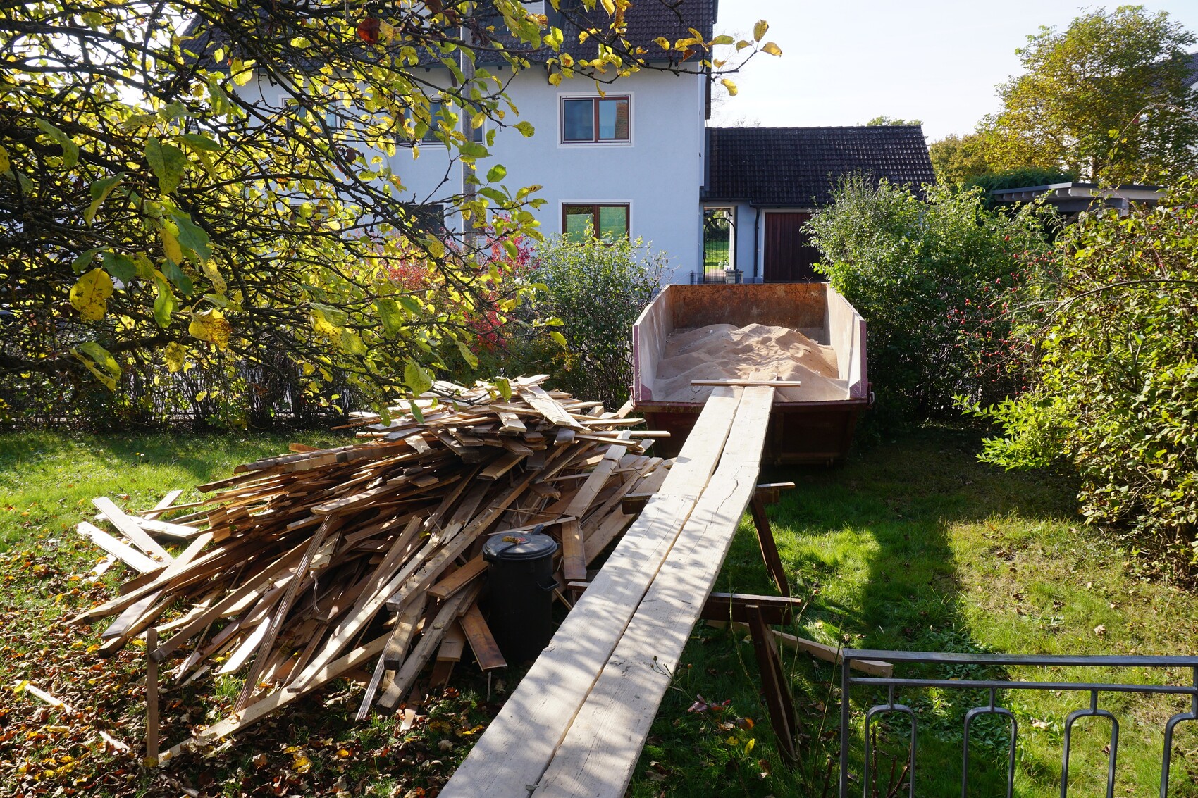

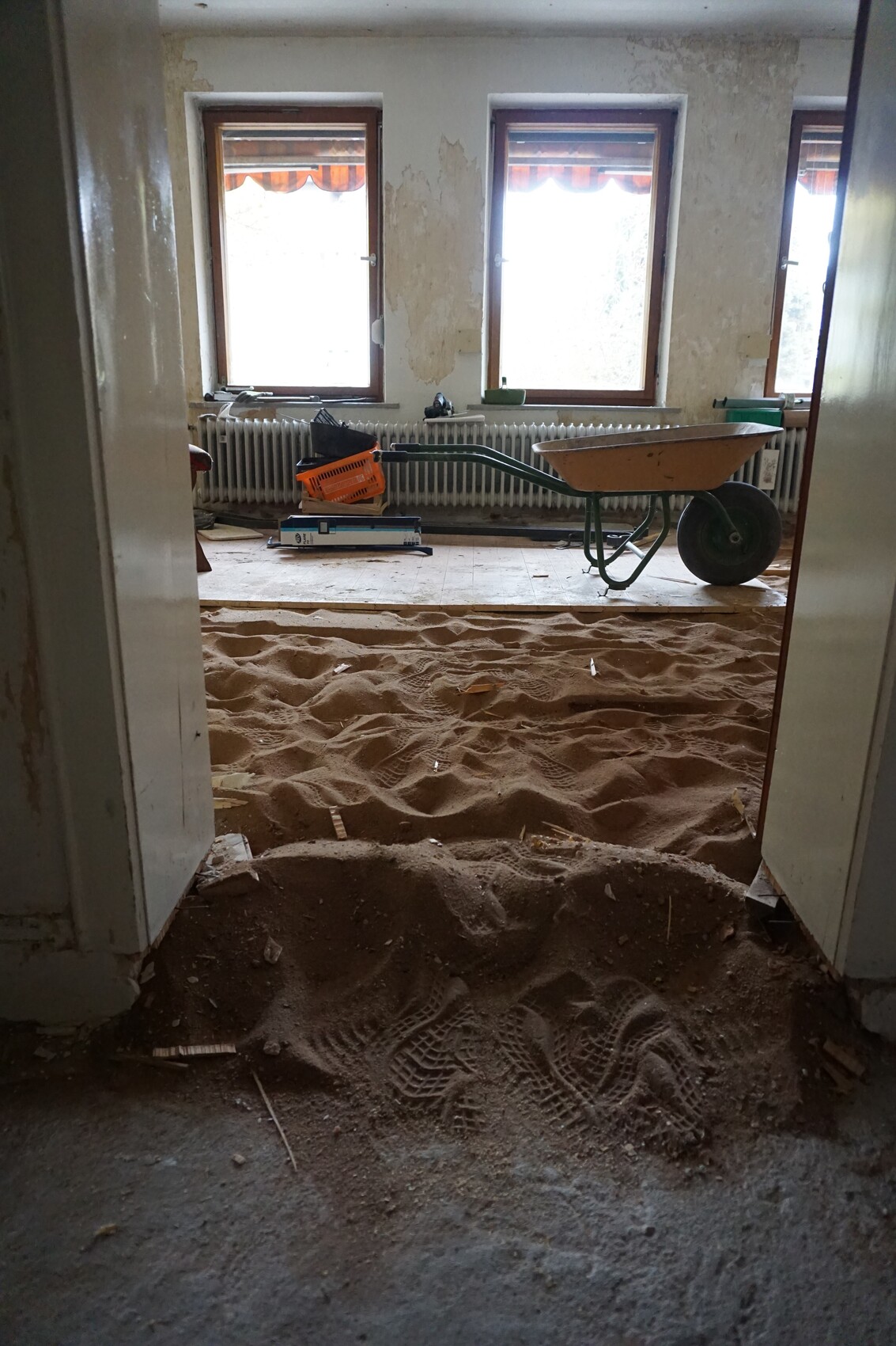

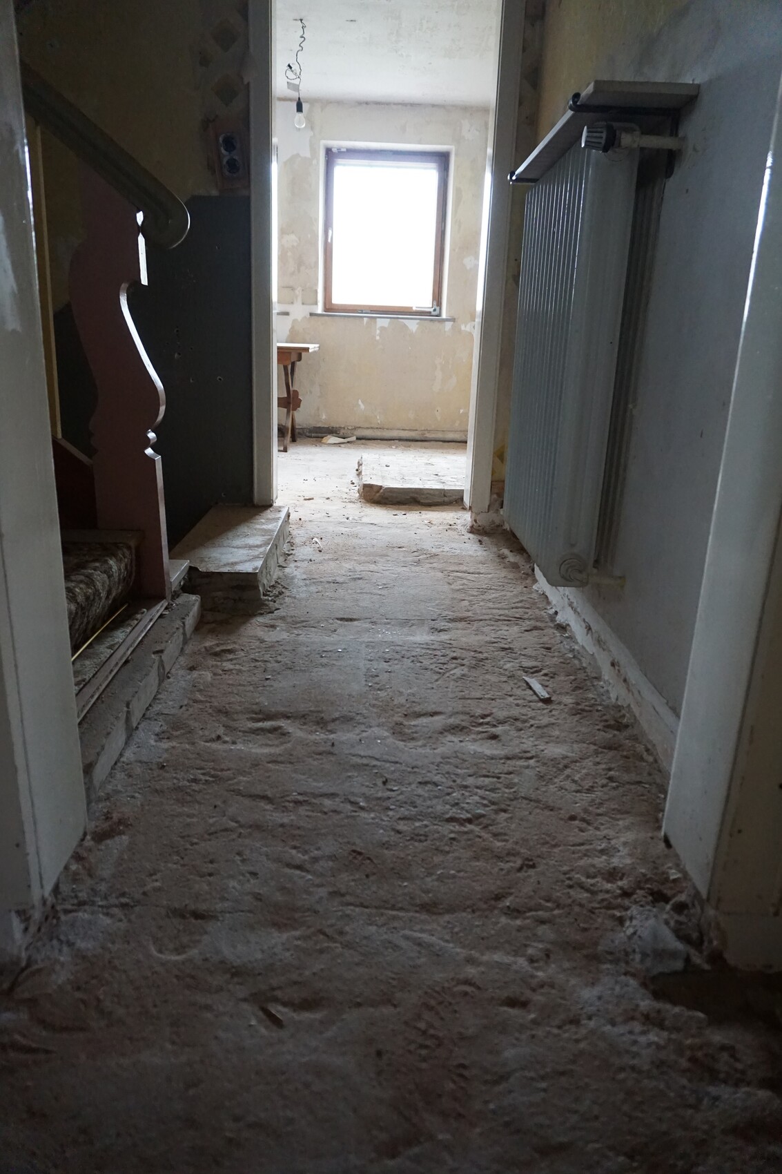

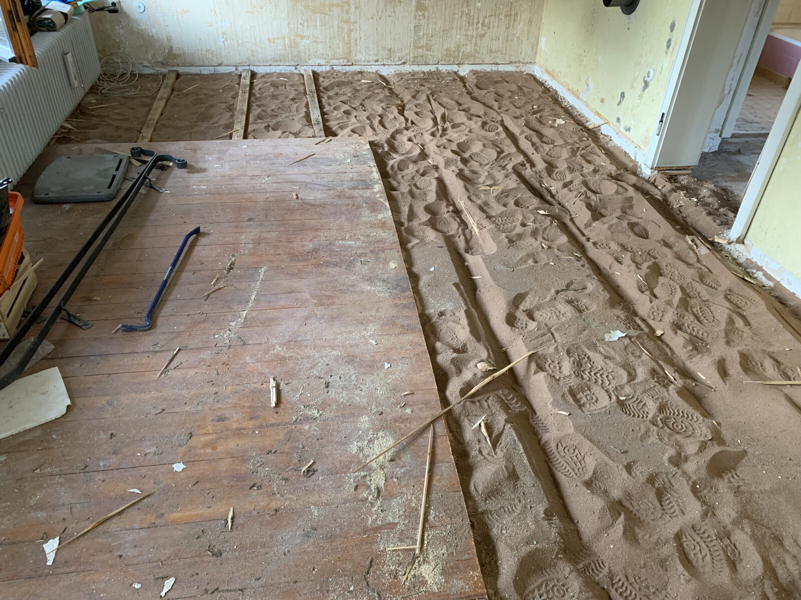

We were busy over the weekend and shoveled out nearly eight tons of sand from the ground floor. First, of course, we removed the floorboards and, due to the lack of a second container (my fault), initially threw everything into the garden. So yesterday I had to move all that into the then-ordered container. Those who don’t have it in their head, have it in their arms 😀
The house now smells for the first time not of the previous owner, but of a construction site, which is somehow a special moment for me. Next weekend we’ll start working on the garden.

Myrna_Loy schrieb:
Why do you want to remove the loose fill from the floors? Old loose fill often provides better vibration and sound insulation than some newer insulation materials.We need the space for thermal insulation against the cold basement (in the basement level, no space due to 1.93 m (6 ft 4 in) ceiling height) and for the underfloor heating.Similar topics
