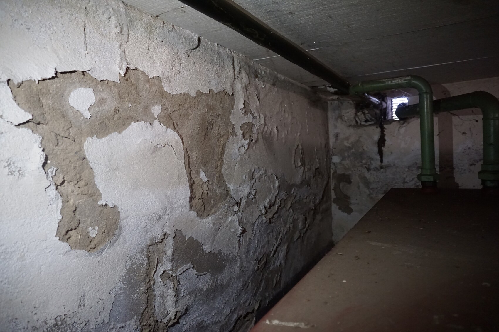

Some exterior basement walls are in poor condition, especially where there is little air circulation (e.g., oil storage room, workshop behind the immovable workbenches):
A cheap solution with renovation plaster could be done, but it would have to be reapplied every 5 years as it is not a permanent fix. They recommended injection waterproofing, which has proven effective over decades. Of course, this costs a lot (20,000+), but it’s possible to focus on the most important rooms, renovate them completely, and then tackle the rest of the basement later.
Once the basement issue was settled, the basement specialist left. I had planned to insist that the GC take a look at the whole house while he was here. That wasn’t necessary because he thoroughly went through every room on his own, took notes, measurements, and made sketches to explain things to me. He was quite impressed with our ideas and the fact that we already have some knowledge and he doesn’t have to start from scratch.
We agreed that I will excavate manually around the water ingress area outside, and he will perform the targeted sealing on the electrical conduit. Also, we should remove the wallpaper and open up the floor as soon as possible to better assess the existing condition.

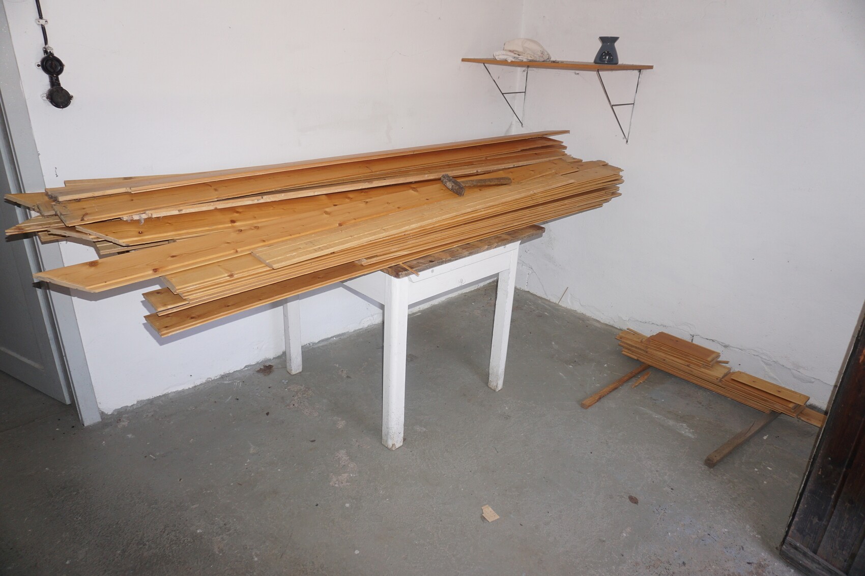

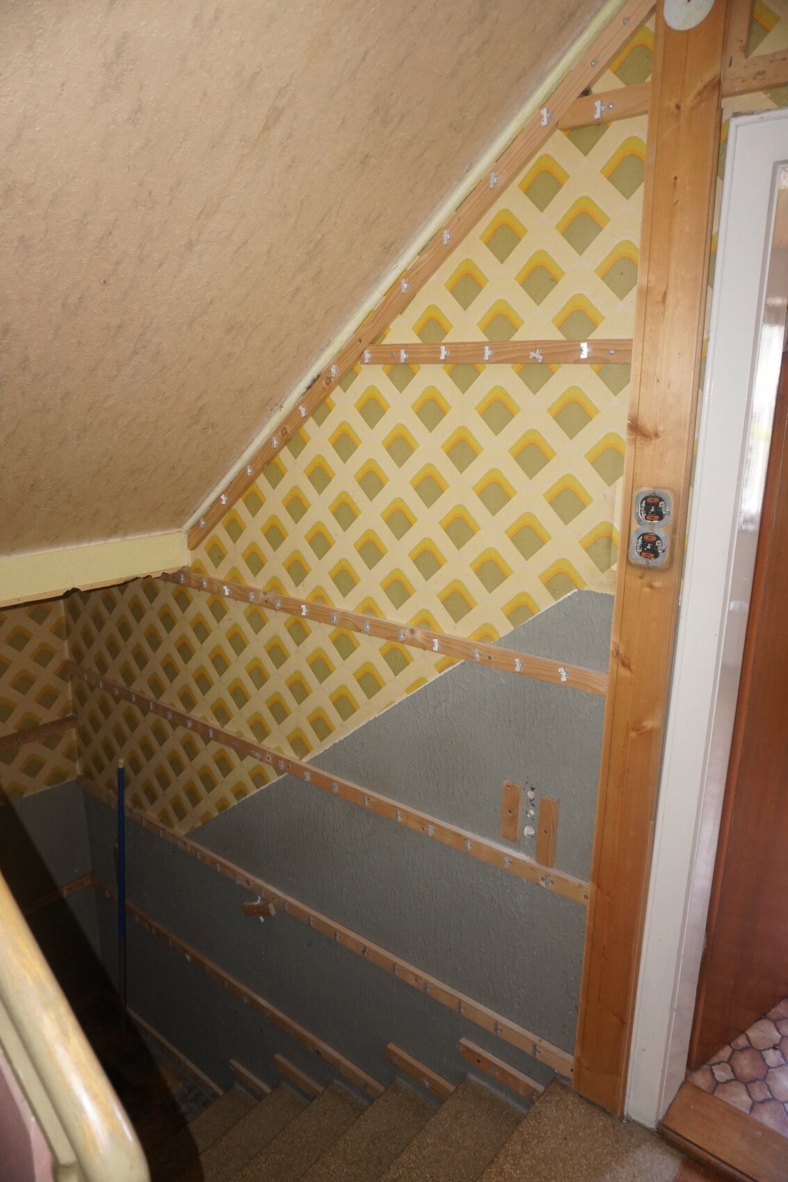

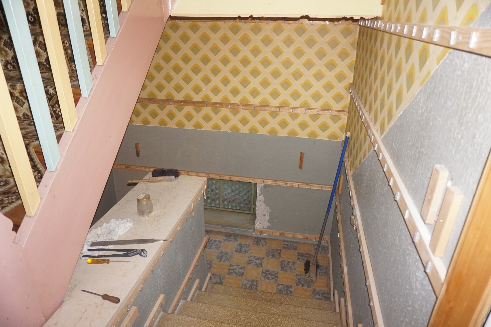

Over the weekend, I already dismantled some firewood from the stairwell…
