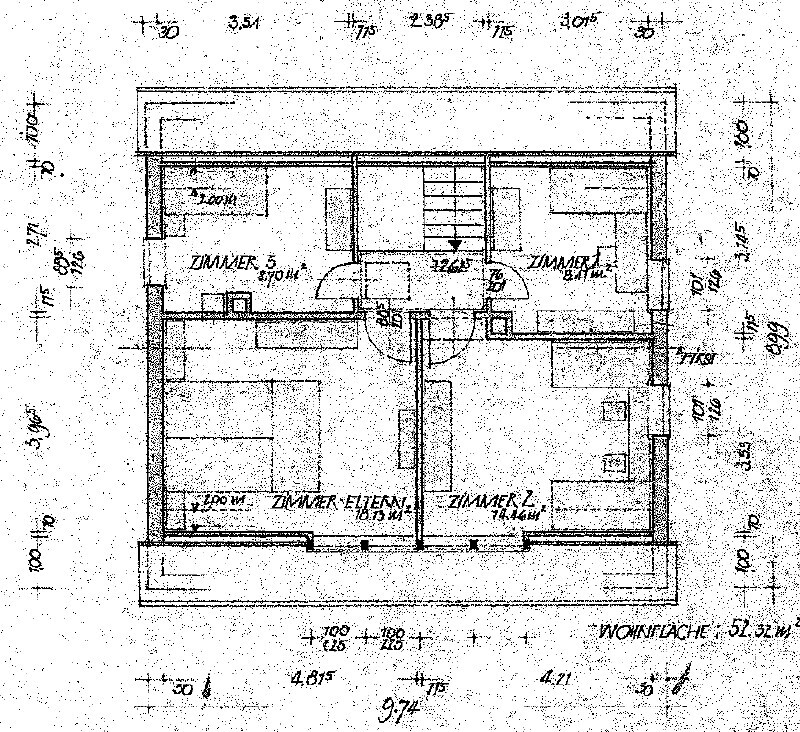

Then show us a survey. What kind of plans are available in the building file?Ground floor: The guest toilet is planned to be converted into a cloakroom. To create a separate entrance for the second (upper) residential unit, we are considering locking the door from the hallway to the bathroom (if that is sufficient, otherwise completely sealing it off) and connecting the living room to the bathroom. However, there is also a wood-burning stove in the corner of the living room (see fireplace in bathroom corner), so this might look a bit cramped and obviously would be very impractical. The kitchen door to the hallway could theoretically also be locked, with the kitchen accessed through the dining room. We’ll see. It would be great to get a double subsidy, but on the other hand, the idea of having an extra, unused door just for the sake of funding seems a bit odd. Maybe it can be built and later removed or “hidden”...
First floor: "Room 3" is the bathroom. In the master bedroom, we would move the door about 1m (3 feet) into the room to use the gained space for a (steep) staircase up to the already converted attic space. Currently, the attic is accessed via a folding ladder in the hallway (dashed area), which is in the way.

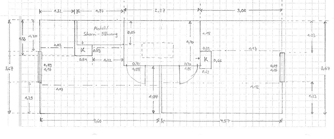

Attic
This already looks like a slightly upscale standard. A wall thickness of 30cm (12 inches) was considered somewhat avant-garde at the time, and all interior walls except for the knee walls are at least one brick thick. The interior wall parallel to the gable in the bedroom even suggests the possibility of a concrete ceiling over the ground floor. Is there also a basement floor plan and cross sections available?

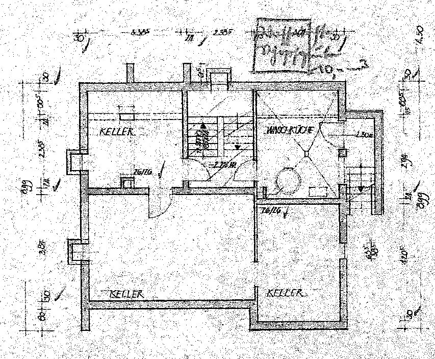

Here is the basement floor plan and the only cross-section available. So, these basically cover all the documents we have for the house 😉
The cross-section mentions a wooden beam ceiling above the ground floor. But that might not mean much since the drawings are not exactly accurate (for example, the pantry was never built, and there is a bathroom upstairs instead of a third room...)
