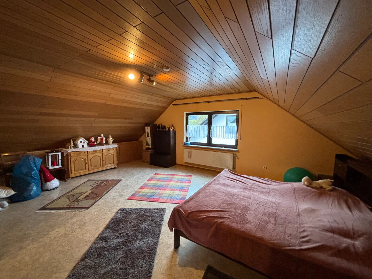

Is the attic still completely unfinished? I don’t understand the red markings. The old floor plan doesn’t show the truth; currently, there is a large room on the left and right as well as the bathroom. Only the fireplace and the thicker wall between the bathroom and Child 2’s room are relevant because water supply and drainage pipes run there. Everything else is drywall or not built.
The red markings indicate the knee walls on the exterior walls and the walls in the middle.
It currently looks like this:
