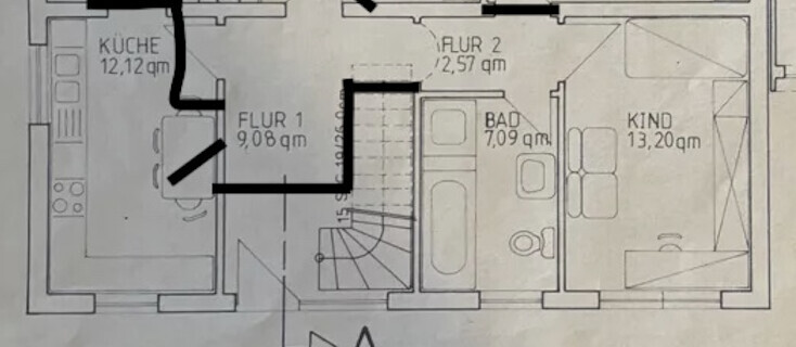

According to the architect’s draft, the entire staircase area would be separated from the ground floor using drywall construction; this area would have a door at the stairway leading to the basement. To the right of this is the main entrance door and, according to the floor plan, the staircase is located in the middle at the bottom.
As a rough plan, something like this with a separate door at the upper floor hallway. So you would meet the tenant when going up the stairs while I go down to the basement, which I could live with. The area between the main entrance and the hallway up to the partition wall would then be the shared hallway (lower area including the staircase), and the rear section would be the ground floor hallway.

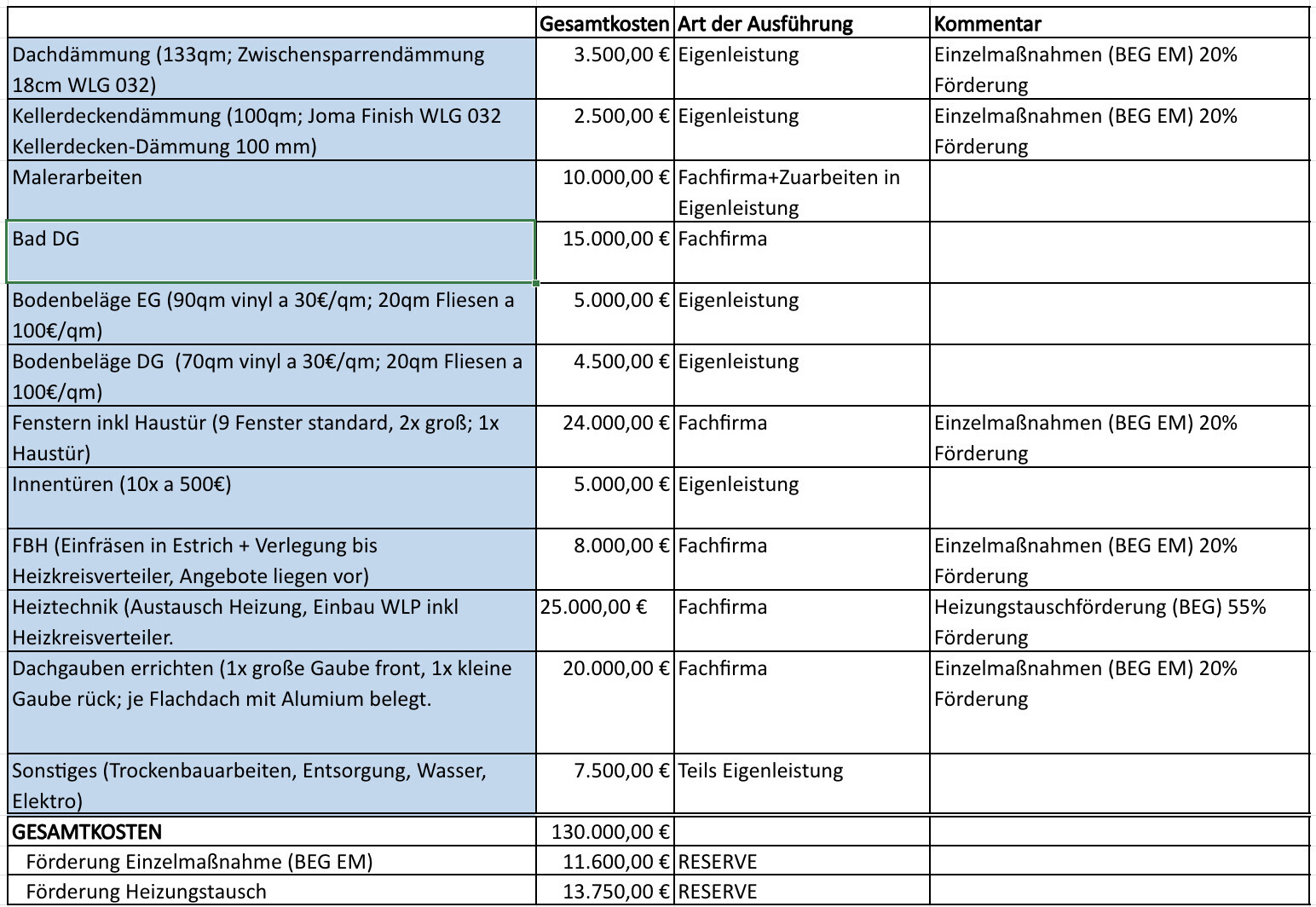

I consider that to be quite tight.Some of the work will be done by ourselves. I already have experience with this, as I have renovated parts of my multi-family house with 3 housing units. This includes a full renovation of a new 40 sqm (430 sq ft) apartment, including electrical, plumbing, drywall, and sloped roof insulation, all carried out by ourselves. My father will also assist—he is from the generation that built their own houses and is a trained electrician.
Breakdown of the planned construction costs for the creation of 2 housing units:
Notes:
- The costs for the dormer windows are estimated; I expect a quote this week.
- Some of the painting work is partially covered by the BEG EM subsidy; the blended hourly wage is about €45 gross, as an apprentice is assisting.
- An additional €25,000 for a kitchen will be added to the budget.
- Electrical work is planned only on the upper floor; the ground floor is sufficiently equipped.
After receiving subsidies, approximately €20,000 remain as a contingency fund.
