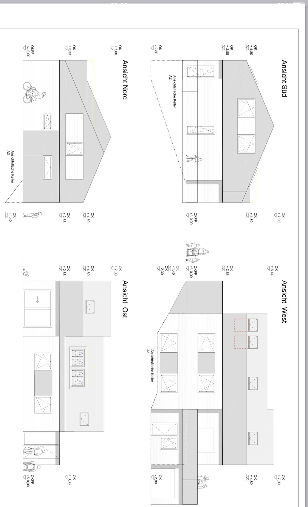

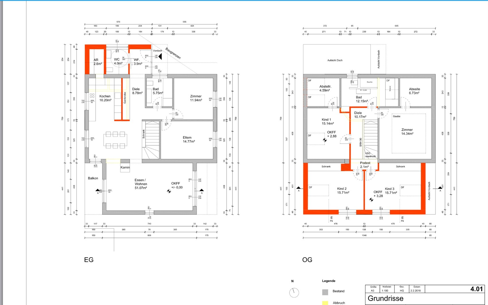

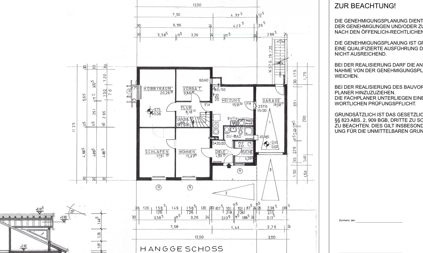

Attached you will find floor plans and elevations.
What is your opinion on the planned changes so far? What is feasible, and what might not be?

I interpret the 33cm (13 inches) wall thickness as the "structural dimension including facing bricks on the exterior," built monolithically. The 13cm (5 inches) interior wall thickness doesn’t make much sense to me.
The floor plans are a bit confusing. Unlike the roughly north-oriented ground floor and upper floor, the basement seems to be oriented east(?) and the staircase there is spiraled in the opposite direction at the start.
I don’t see the demolition for the kitchen enlargement marked. In the elevations, it’s not clear to me how the existing structure and amendments relate to each other. Maybe you could add some photos.

Here I am again: the house looks familiar to me from your thread https://www.hausbau-forum.de/threads/1-architektenentwurf-umbau-eines-efh-eure-meinung-ist-gefragt.23910/ from 14 months ago.
At that time, the entrance extension was not yet discussed in terms of its basement, which I also do not consider practical, and
expresses more clearly, in my opinion, how the creation of the new children's rooms should be understood.
