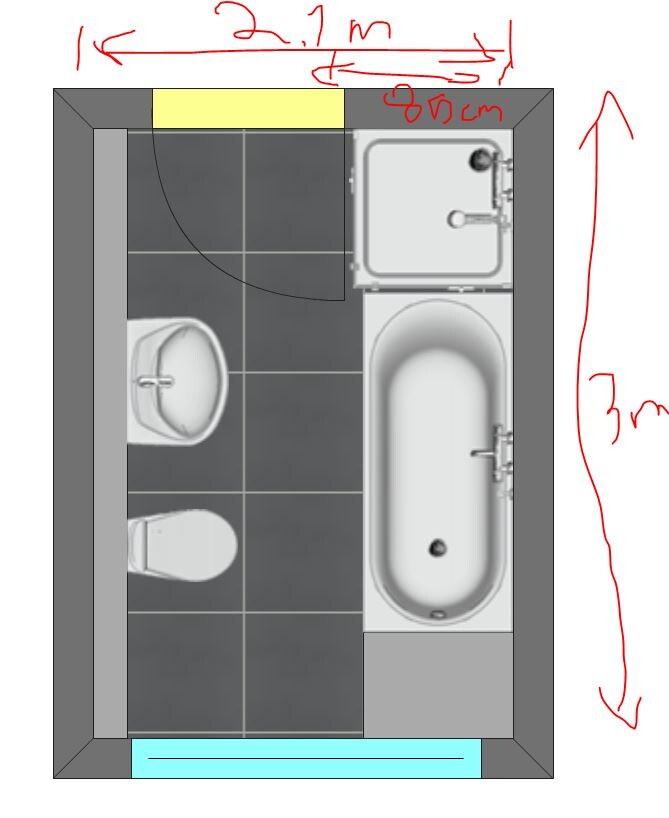

we would like to renovate our outdated bathroom. It is the main bathroom (upper floor, not for guests), where we currently have the shower, bathtub, toilet, and washbasin arranged in about 6 m² (65 ft²). The current layout is as follows:
The classic combination often used around 30 years ago, with the shower next to the bathtub.
We want to keep both since we need a bathtub but also want to use this bathroom for showering. There are no sloping ceilings because the bathroom has a bay window, but the entire lower front consists of windows. Currently, there is a standard radiator between the window and toilet, but it does not have to stay there. We definitely need to replace the fixtures and get a new shower enclosure. In addition, two tiles are cracked. Considering all this, I think it makes sense to renovate the entire bathroom. The layout basically works for us; we would just like a larger shower (currently 70 x 90 cm (28 x 35 inches) shower tray). Furthermore, the shelf space between the bathtub and window feels like wasted space for us.
Cabinets are not absolutely necessary since a cabinet will be installed under the washbasin and there will be a mirrored cabinet.
Of course, we could simply move the bathtub closer to the window to enlarge the shower. But perhaps someone has a clever idea on how to design it more efficiently.
So far, moving the bathtub only towards the bottom of the plan is currently the favored option. Since we need to replace the floor tiles anyway and re-run the wall connections, this should be doable. There are no other rooms connected above. With the drains, we need to see how "curb-less" the shower can be and how far back the bathtub can be moved (the drain is relatively close to the shower). However, this should all be feasible. Personally, I am a fan of placing bathtubs in front of the window, as the room is rarely used meaningfully otherwise. However, I’m not exactly sure what to do with the space between the bathtub and shower. The shower can’t be moved anywhere else, and placing the vanity in between probably won’t work. The toilet would fit well there, but it seems almost impossible to reroute the waste pipes to the opposite side.
On the left side, there is already a wall-hung installation system. This might remain as is, but I would like to move the toilet closer to the window to accommodate a larger vanity. That would require a completely new wall-hung installation. Currently, there isn’t enough space for a bigger vanity there, otherwise the door won’t open anymore.
Regarding underfloor heating, I need to assess a bit. It definitely won’t be electric, and I don’t want to replace the screed either. On one hand, underfloor heating is nice (we have it throughout the ground floor), but the effort involved is quite significant.
I just wanted to make sure I don’t miss out on a good idea.
Would you build a narrow wall between the shower and the bathtub, or would you prefer a glass partition? A tiled wall is probably easier to keep clean, but it also means there will be less light in the shower. In terms of cost, it’s likely not a significant difference.
