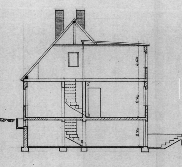

I see two issues that bother me: first, apparently a party wall shared with the neighboring unit, which will at least significantly complicate demolition. Second, apparently a staircase leading to a raised ground floor entrance, indicating that the finished floor level is considerably above ground level. Much more fact-checking is needed here. Honestly?

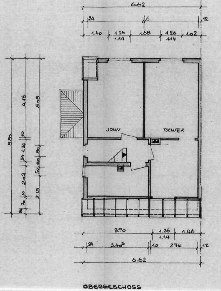

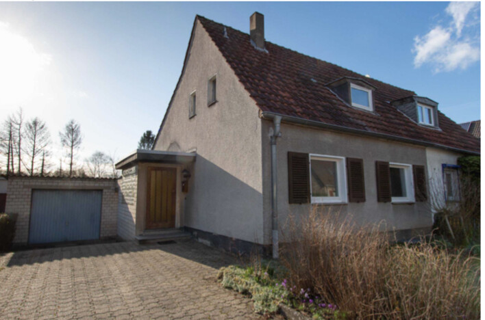

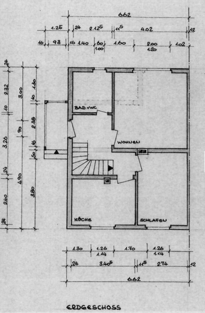

Do the following pictures help clarify?
We plan to take a look at it tomorrow. According to the listing, the house was built in 1932.
The price to pay basically reflects the land value. It’s really fair, considering the location is amazing.
Yes, I also assume the shared party wall.
Niriach schrieb:
We plan to take a look at it tomorrow. And yet you think it’s completely built over? — I take that as a sign that the floor plans for the other levels are also known. Then show them!

The note about the top edges means that—in order to even consider whether it’s worthwhile—you would need to raise the ground level to install the foundation slab for the larger new house to be built there, correct?
I will definitely ask about the year of construction—which period are you thinking of? That would be important for asbestos, etc.
Built in such a way that I don’t really see the possibility of accommodating two children, an additional bathroom, and so on—that’s just due to the size, I’d say. 100 sqm (1,076 sq ft) is 100 sqm (1,076 sq ft).
