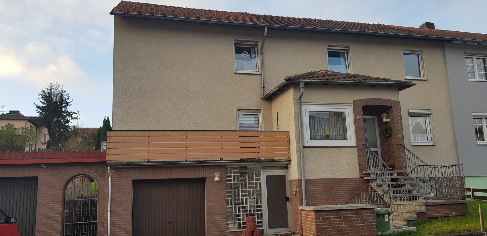

I hope I’m in the right place with my questions. First of all, I understand that no precise statements can be made based on descriptions or photos alone.
Here are some preliminary details:
I have a house built in 1938 with an extension from 1970, totaling 200 sqm (2,150 sq ft) of living space plus a 100 sqm (1,075 sq ft) basement.
The windows date from 1979 and are double-glazed.
The radiators are still 95% finned tube heaters installed in radiator niches.
The gas boiler in the basement is about 20-25 years old.
The roof and upper floor ceiling are uninsulated.
The attic will NEVER be converted, so we want to have the roof re-covered with just an underlay membrane and insulate the upper floor ceiling.
Now we are facing the question of what to do about the windows and facade.
Since I would say the facade area is quite large, insulation will be correspondingly expensive. So my question is how much additional savings in percentage terms can be achieved by using triple-glazed instead of double-glazed windows combined with external wall insulation? Is there perhaps a general reference value?
Also, is there a reference value for the potential savings compared to the current situation when upgrading to double-glazed thermal insulation windows, insulating the upper floor ceiling, closing the radiator niches, installing new radiators, and a new heating system? I have searched various websites but unfortunately found no clear guidance.
I just want to get a sense of what percentage savings can be expected from such measures.

What kind of front door do you have? – I can’t clearly tell from the photo. The side entrance door appears to be made of aluminum, likely from the generation without thermal break separating the inner and outer parts of the frame.

Oliver198911 Dec 2019 07:2911ant schrieb:
What kind of front door do you have? I can’t clearly see it in the photo. The side entrance door looks like it’s made of aluminum — probably from an older generation without thermal breaks separating the interior and exterior profiles.Yes, exactly, it’s an aluminum door, both at the top and bottom (we have the front door upstairs by the stairs, and another one downstairs through the basement). They definitely need to be replaced, and the glass blocks will be removed as well to be replaced by windows.
