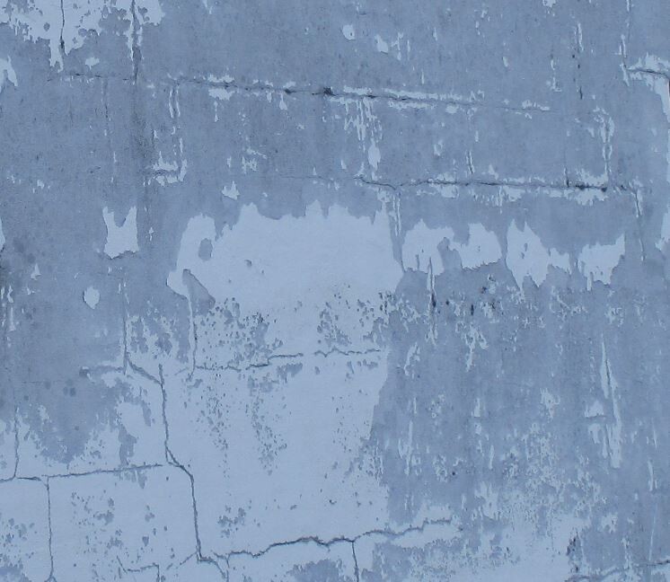

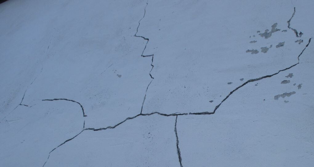

sunshineh18 Jun 2015 16:12Hello,
about 30 years ago, we built a hall, and now the west-facing wall looks quite bad (see pictures).
Unfortunately, it is a boundary wall, so the gutter is installed on the wall to avoid overhanging the neighbor’s property.
We would now like to renovate the exterior wall and are looking for a PERMANENT solution.
What should be done here, and which materials would be suitable for use on the weather-exposed side?
What costs can be expected?
Would it possibly be better not to use plaster anymore but, for example, a metal cladding instead? Although maybe that could cause problems with mold?

sunshineh24 Jun 2015 10:56Thank you for your response! This is the common approach.
Are there any alternative suggestions here?
