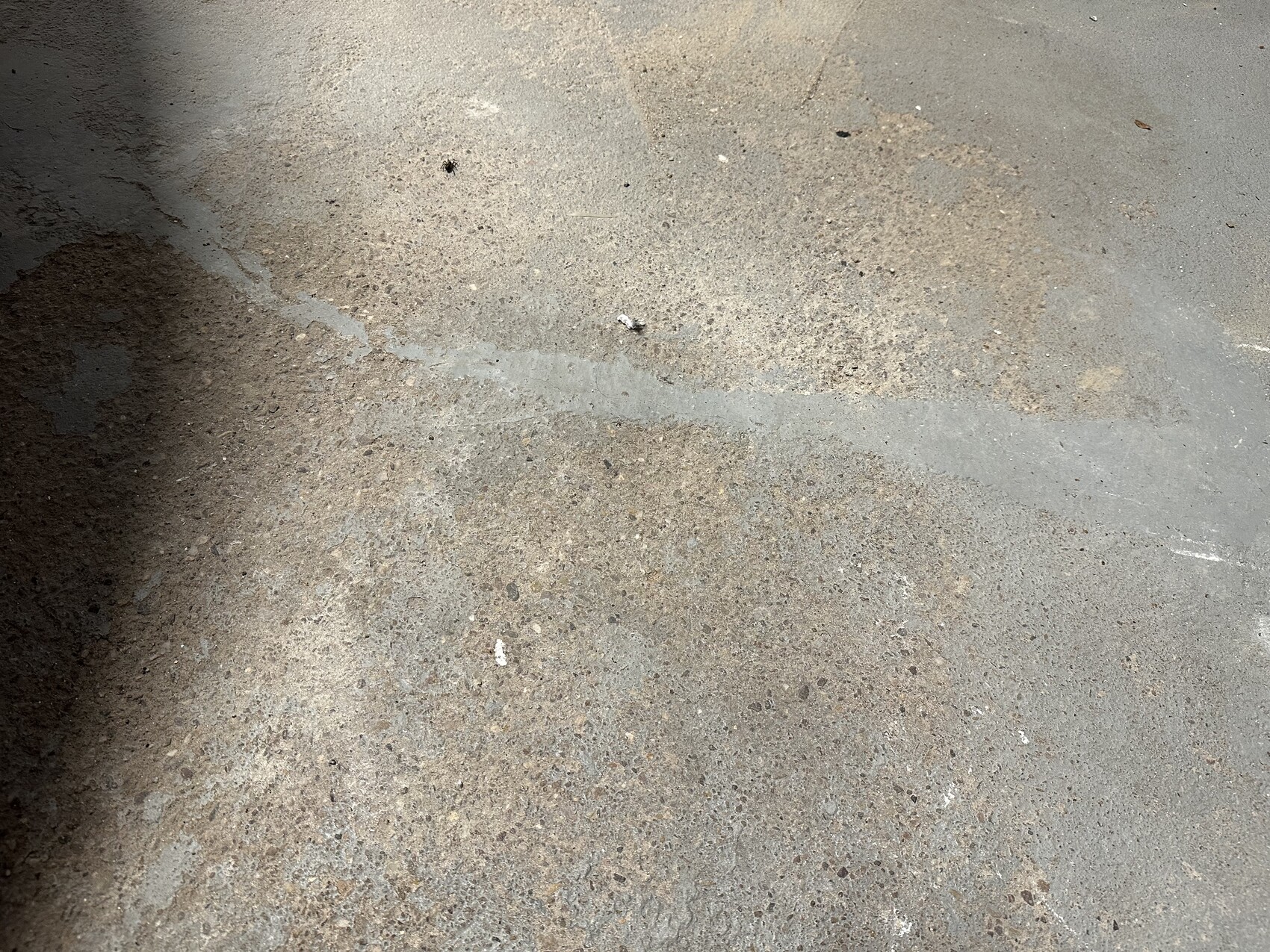

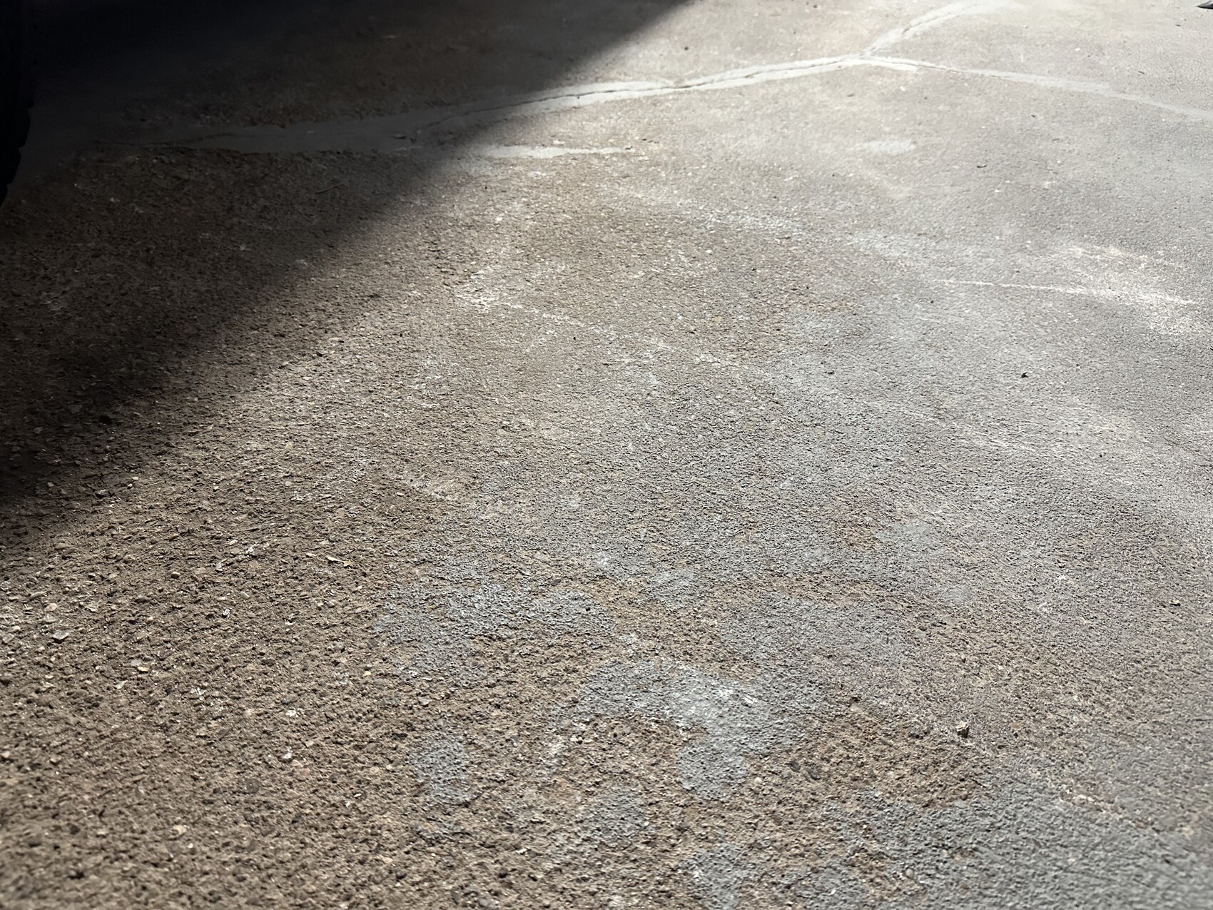

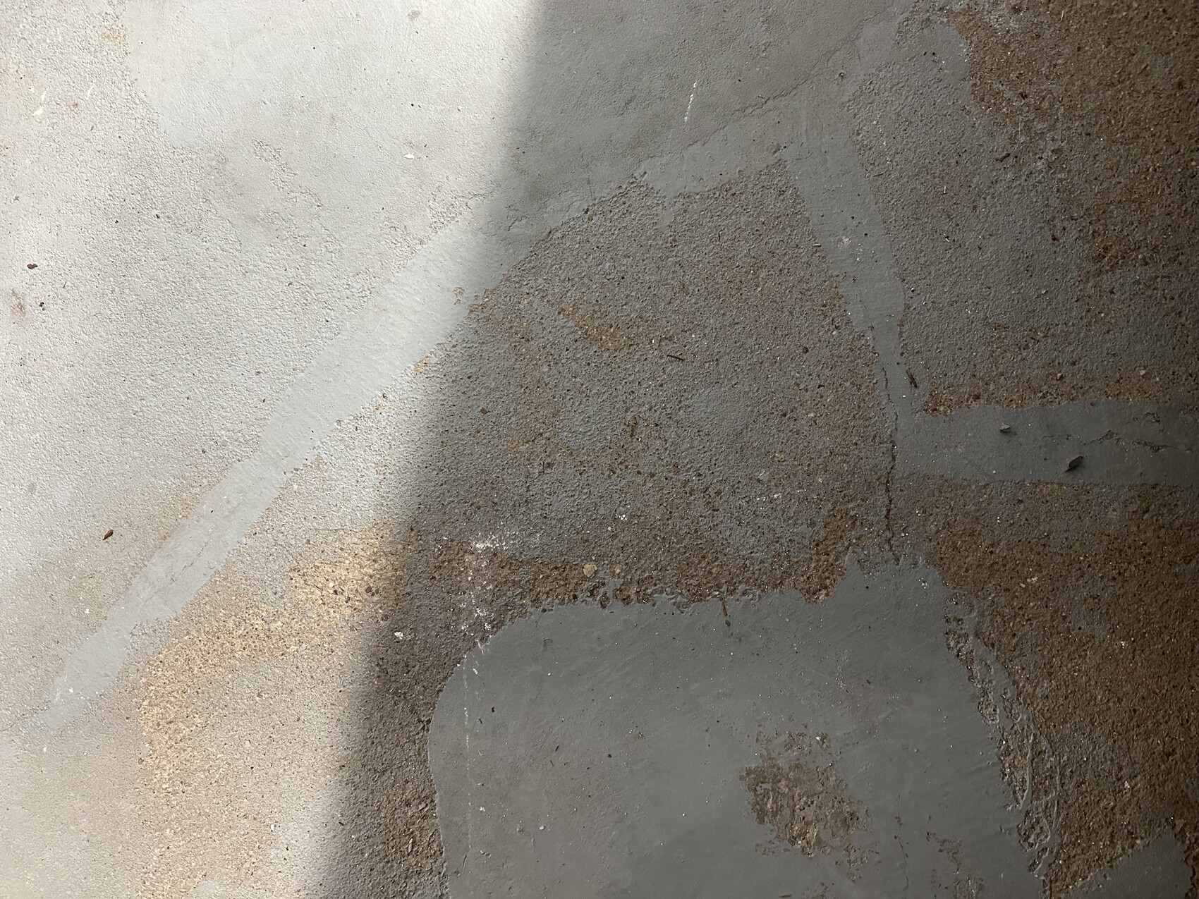

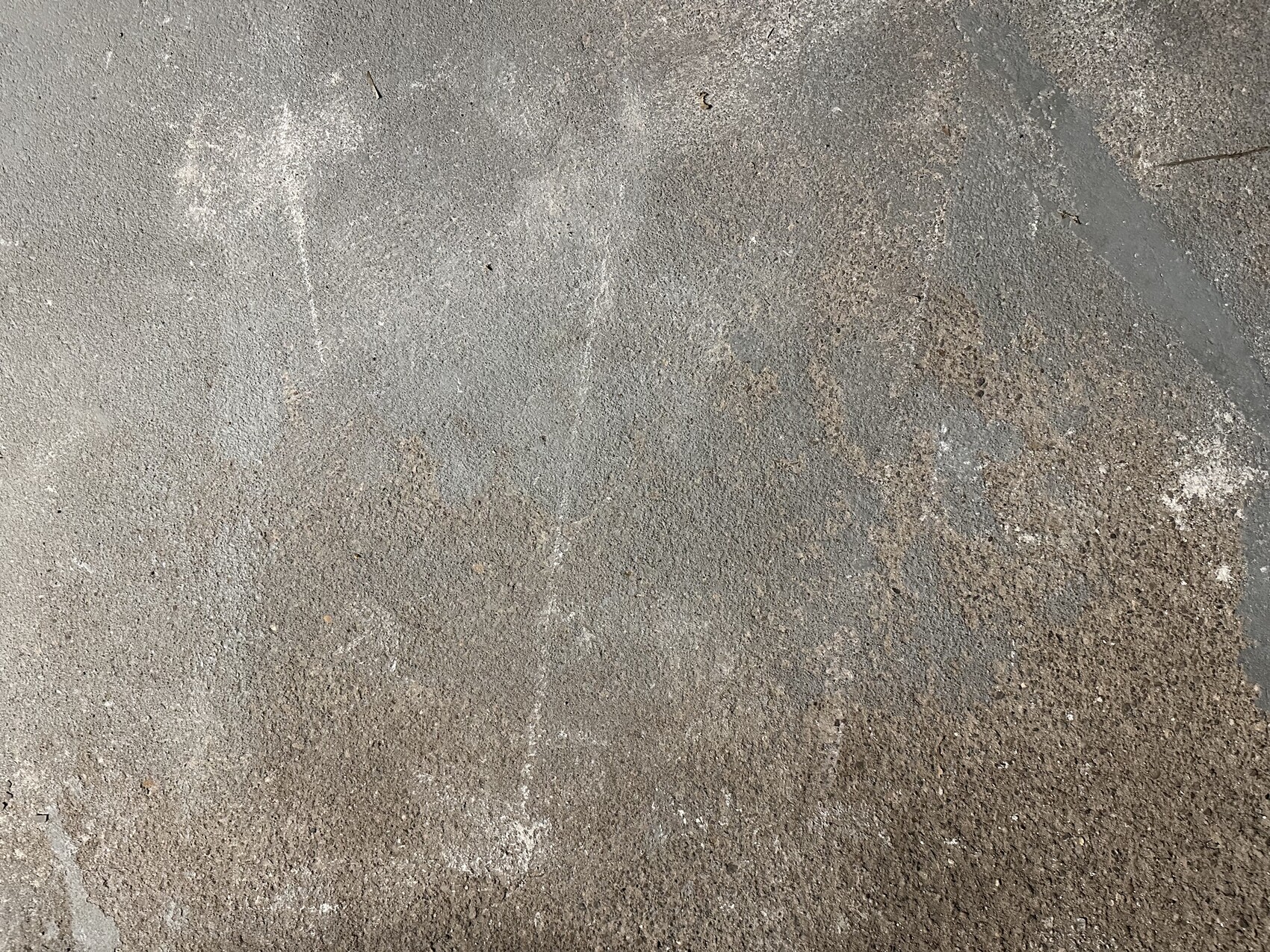

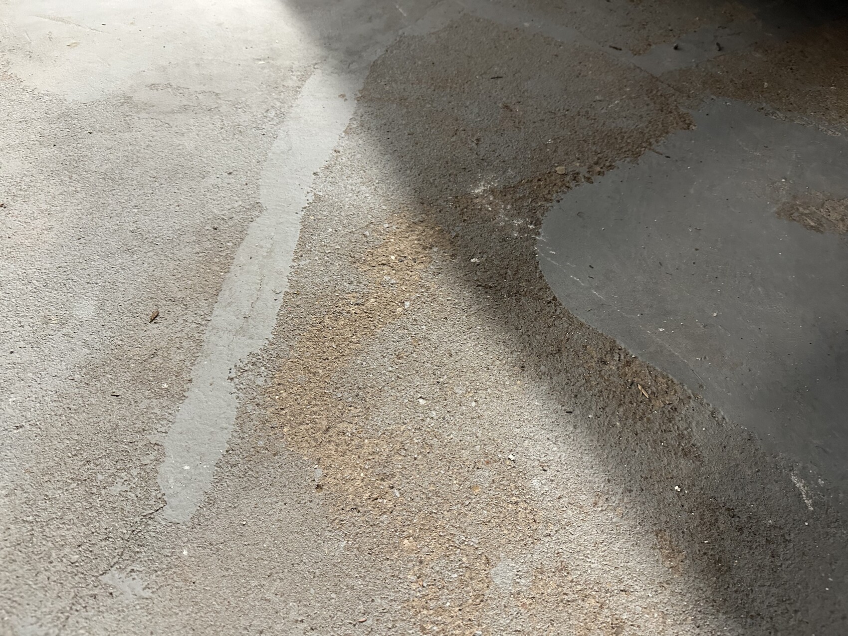

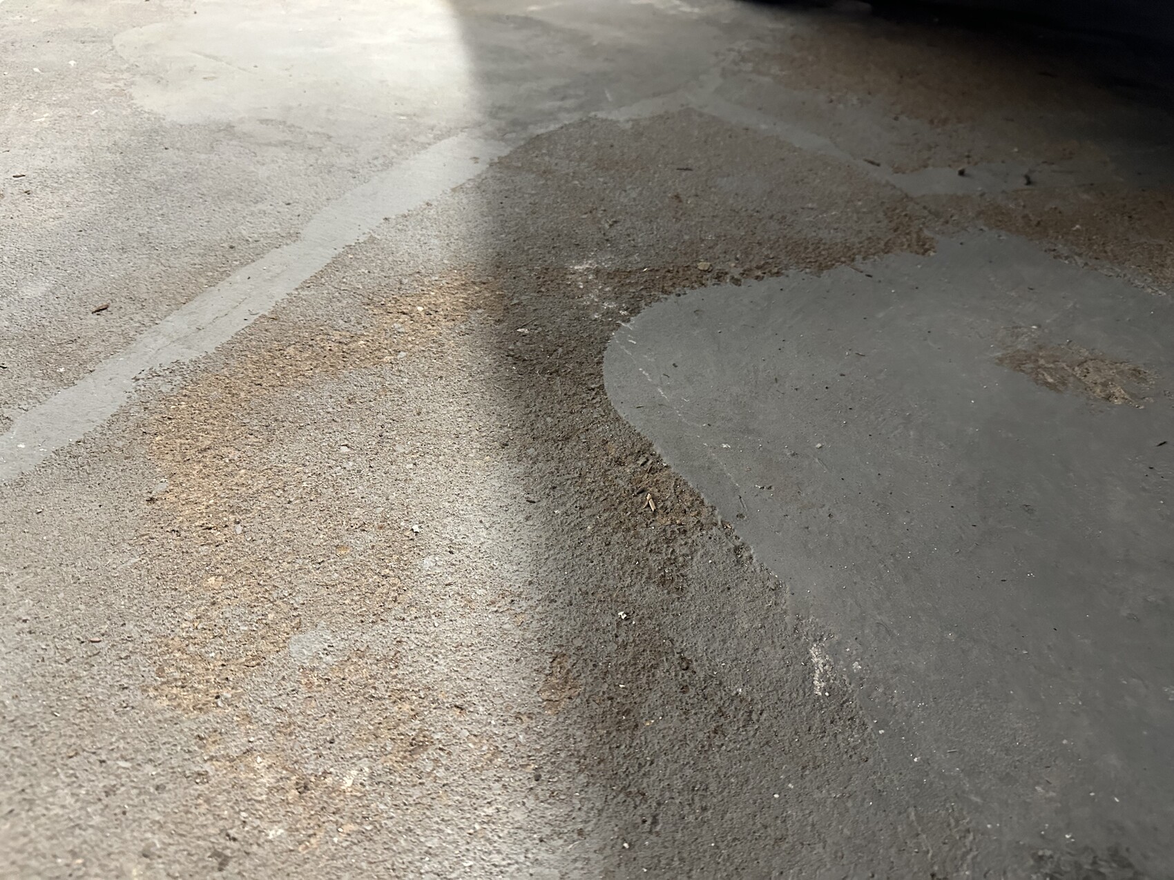

the garage floor in our house has clearly visible damage, cracks, and spalling, some of which appear to reach down to the underlying screed (I assume).
It needs to be renovated, and I am now considering which floor covering would be best suited for this.
Are tiles still commonly used in garages? Or is it better to just grind the surface and apply a new protective layer? Or is there a better alternative?
