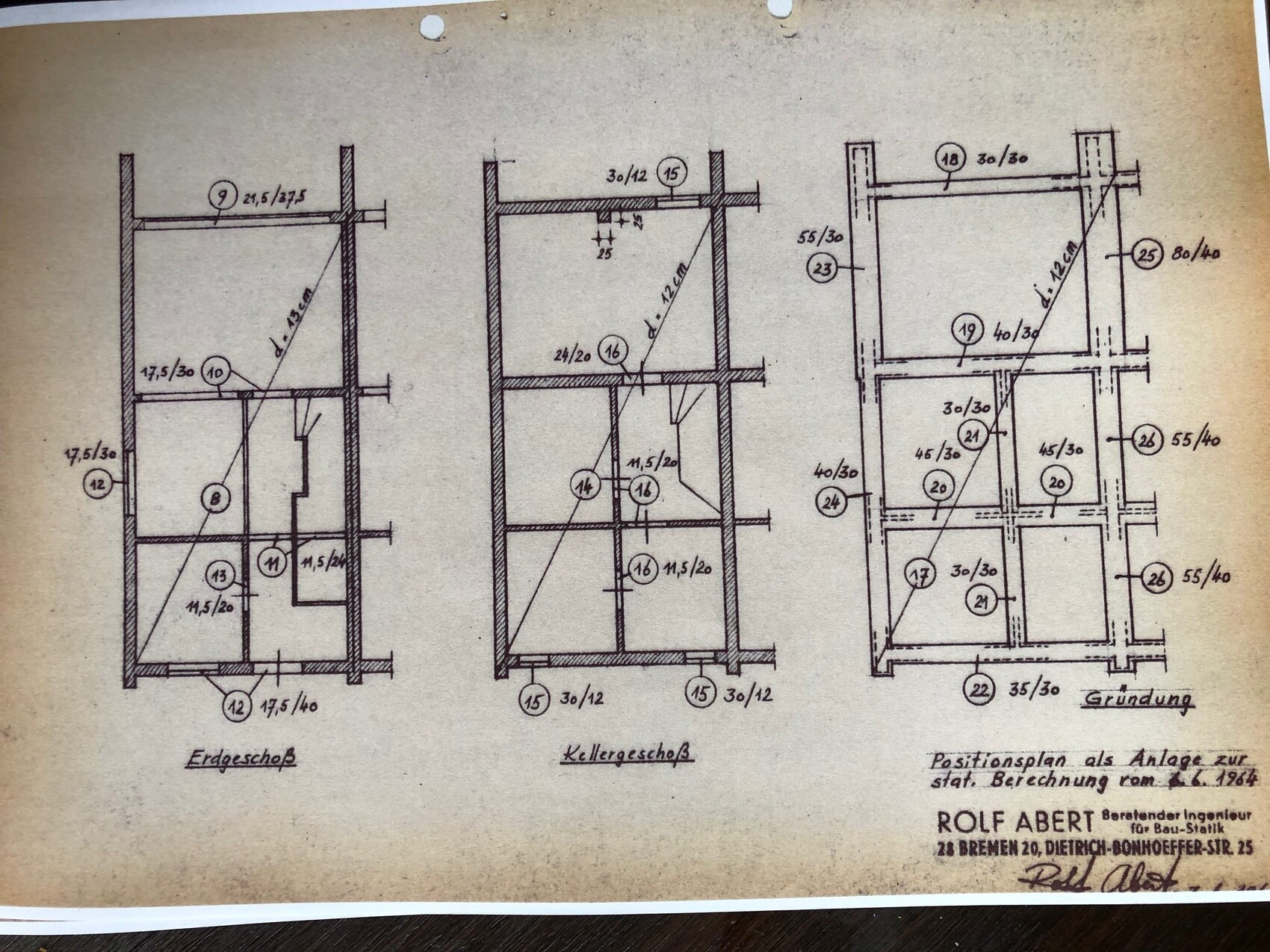

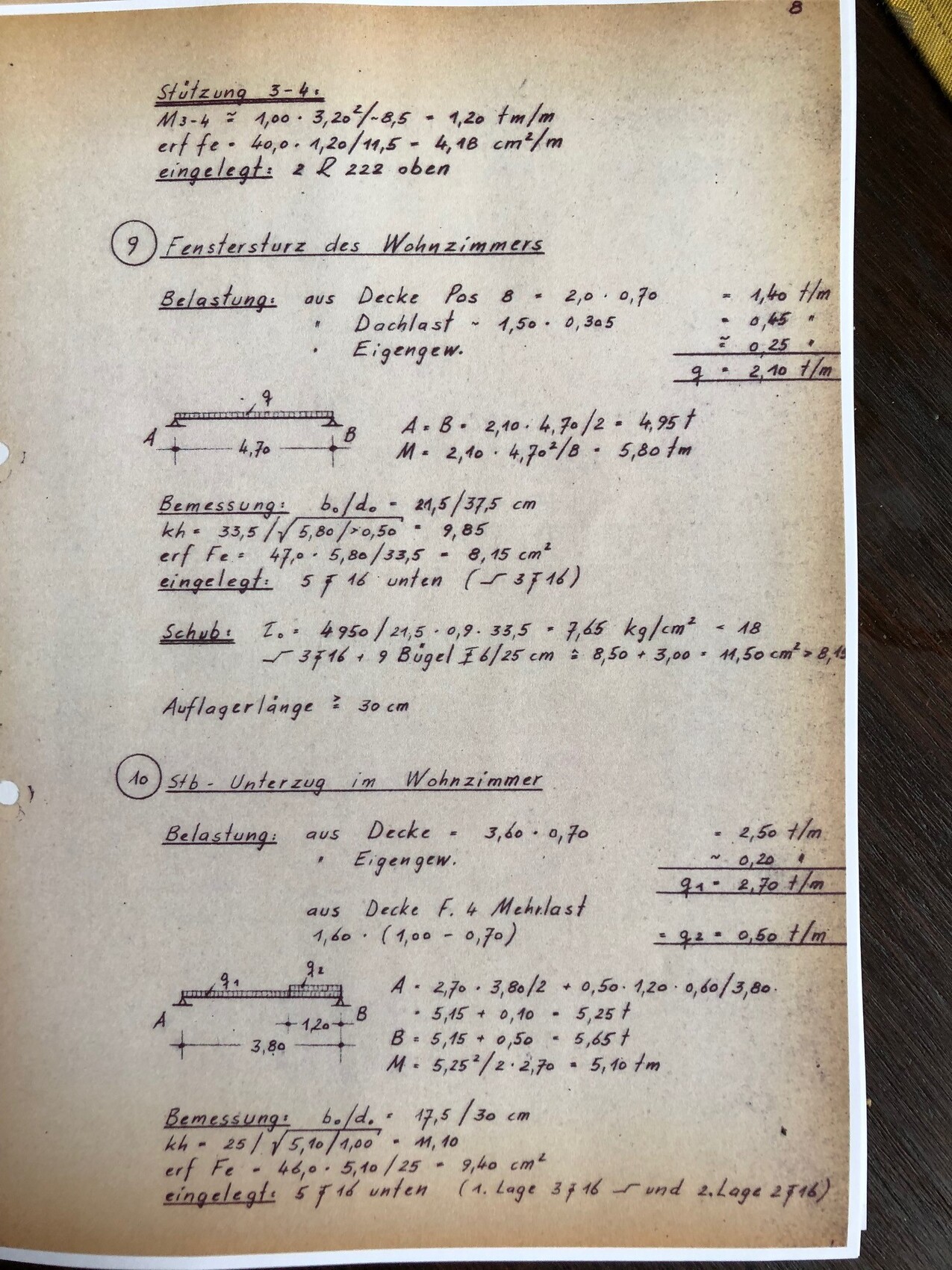

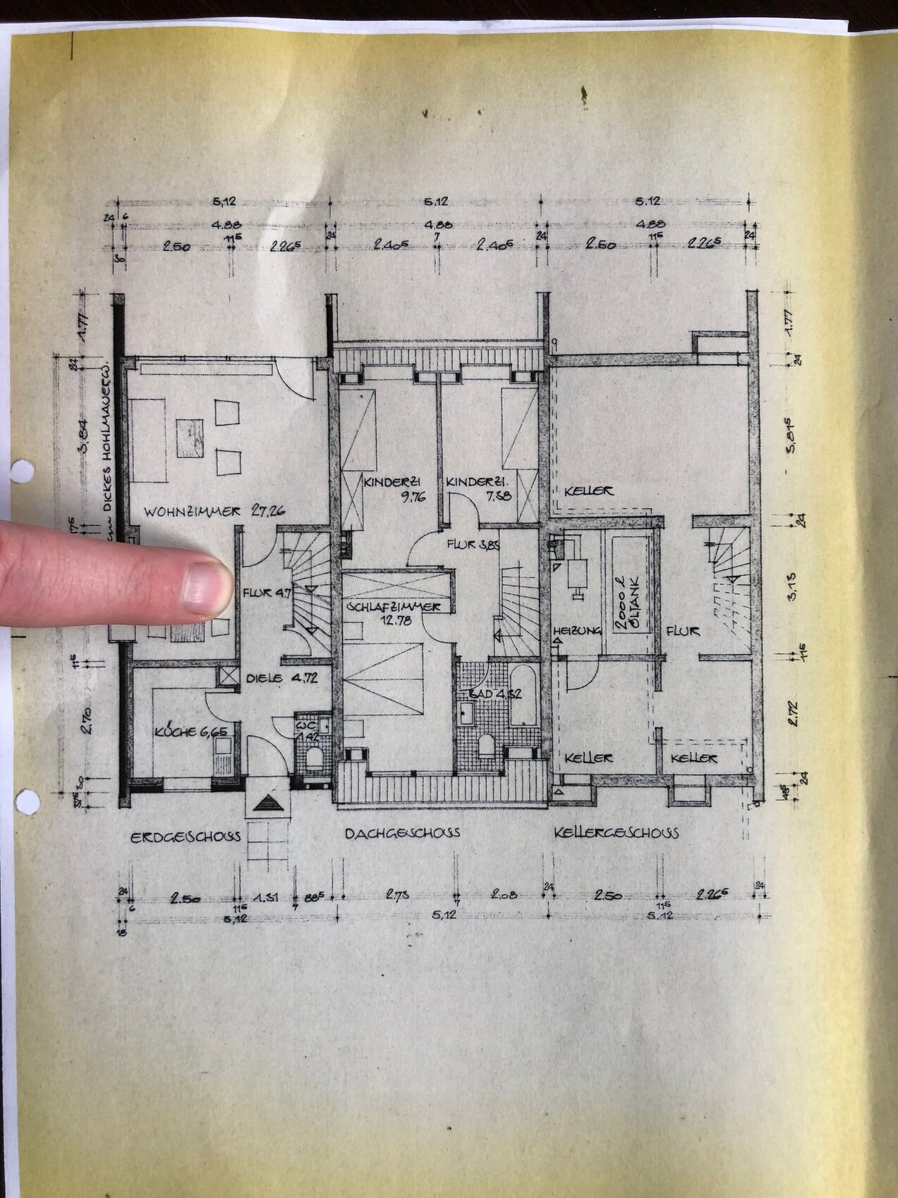

Hello, I want to remove a wall. I know people who have an identical house and have already taken out this wall. It is also "only" an 11.5cm (5 inches) wall, but I still wanted to ask. The wall I’m pointing to on the floor plan. There is already some kind of beam present (pos. 10 in the structural calculations).
Well, please take a look at the photos. I’m looking forward to your assessment.

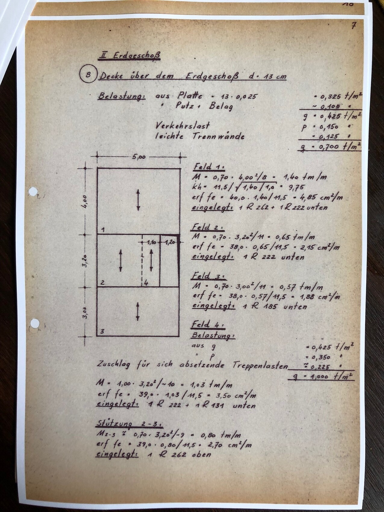

5. In this floor calculation, are fields 2 and 4 also two separate ceiling/floor elements in reality, or is this just divided into two sections for calculation purposes?
6. What does this dashed line between fields 2 and 4 mean?
7. What worries me most is the end of the wall because it is built like a small T directly under the beam in the living room. Is this beam still supported by that T section, or does it actually rest only on the exterior walls? My guess is that the T section is just supporting the door lintel between the hallway and the living room. Could that be correct?

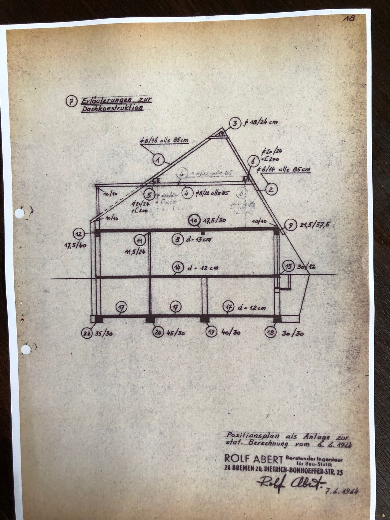

8. Why is the wall at position 10 not drawn at all on the roof structure plan (page 18), and only this kind of beam is shown at the ceiling level?

As a structural engineer, I know that I am personally liable for my response. Therefore, no sensible person will give you an answer offhand.
The answer seems very straightforward, but the structural design is 50 years old, so who knows what might have happened since then.
Hire a structural engineer who will inspect the site in person and give you an answer. If everything is as shown in the plans, it will cost you around 200–300€ (approximately $220–330).

If the beam in the living room runs completely from one exterior wall to the other (I can verify this by tapping the plaster), is it still possible that this beam is supported somewhere else?Do you mean the actual exterior walls (at the top and bottom of the plan) or the side partition walls next to the neighboring houses? Of course, it can still be supported there. There are walls underneath after all. Even a continuous beam benefits greatly from support in the middle. So: ask a professional to check this on site. There may also have been changes made after the plan was created.
