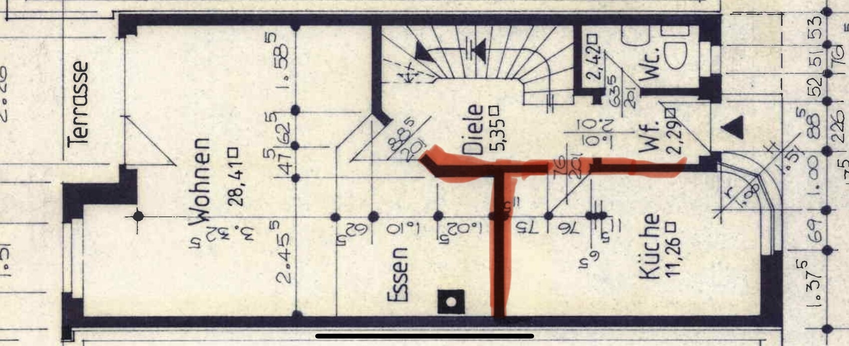

We are planning to buy an existing property from the 1990s. Beforehand, we want to clarify whether changing or removing a load-bearing wall is feasible and what the possible solutions could be. We want to know this before hiring a structural engineer or buying the house, to avoid the risk that it may not be possible.
Specifically, it concerns the walls marked in red, as we want an open living/dining area.
Based on your experience, what kind of solutions might there be? Should we expect that a steel post will have to be installed, or would it be more common to run a steel beam along the ceiling?
We have no experience with this and would really appreciate your feedback and insights in advance.
Thanks for reading and have a great weekend.

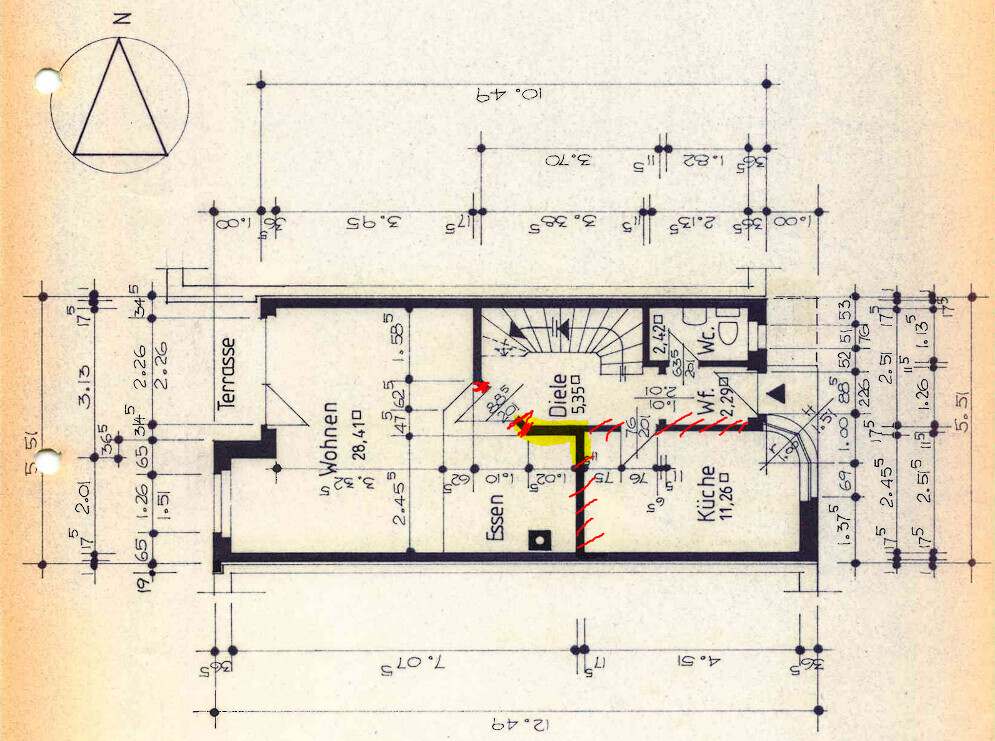

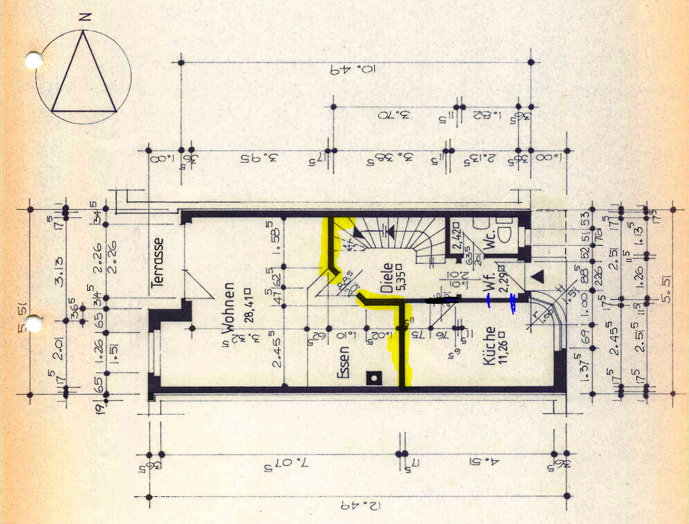

The layout is currently as you drew it. Or something very similar. The homeowners had already moved the kitchen door toward the entrance area some time ago. I think the load-bearing parts of the wall structure are located here as I marked. (Image 1)
In Image 2, there is kind of a compromise where the "L" shape could remain, of course in combination with steel beams that would provide additional support.

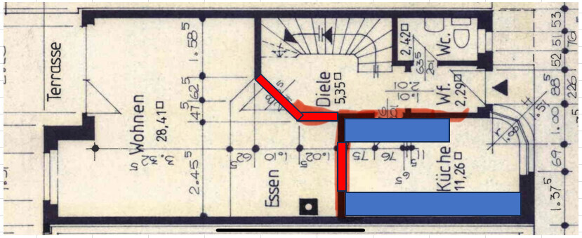

Could you please sketch your furniture layout? I can’t quite imagine how you want the kitchen. Kitchen with a toilet?
What is the current kitchen like?
Is there really a single step leading to the living room?
Is the fireplace shown actually there?

Could you sketch your furniture layout? I can’t imagine how you want to arrange the kitchen. Kitchen with a toilet?
What does the kitchen look like currently?
Is there really a step up to the living room?
Is the fireplace shown on the plan actually there?
I will try to sketch the basic idea for the kitchen and the interior layout when I get a chance. There is no step up to the living room. Judging by the building permit / planning permission, the living room was originally planned without a basement, but was later expanded to include one in an adjustment. Because the living room now has a basement, the fireplace has been moved to the opposite corner, basically next to the staircase.
And no, the kitchen should not be connected to the toilet. My idea was to leave about 1–1.5 meters (3.3–5 feet) of wall from the entrance area (vestibule) so that you don’t walk straight into the house.

But the entrance is already there on the ground floor, right? Why do you want to open up the vestibule? Nothing against openness, but there should still be some privacy, a cold air barrier, and some separation between the wardrobe area and the living space.
I’m missing a clear picture of the current situation here.
Davidkos schrieb:
As you have drawn it, that’s how it is currently. Or something similar. The builders had already moved the kitchen door toward the vestibule back then.
So, how is it now?
It’s clear that something has to remain in place for structural reasons. But a room also benefits visually when you don’t demolish everything completely, but leave a small partition wall or wall section standing. Nobody wants to look directly at an open shoe rack from the stove or sofa.
Before asking in a forum—since it seems to be a terraced house—I would recommend checking with the neighbors. Some of them may have already done something similar.
That’s how I proceeded myself. We all had the chimney in the middle but no load-bearing walls, so many just removed the wall above countertop height and were able to create a partially enclosed island.
Maybe you can get relevant documents from your neighbor and save yourself some structural engineer fees.
