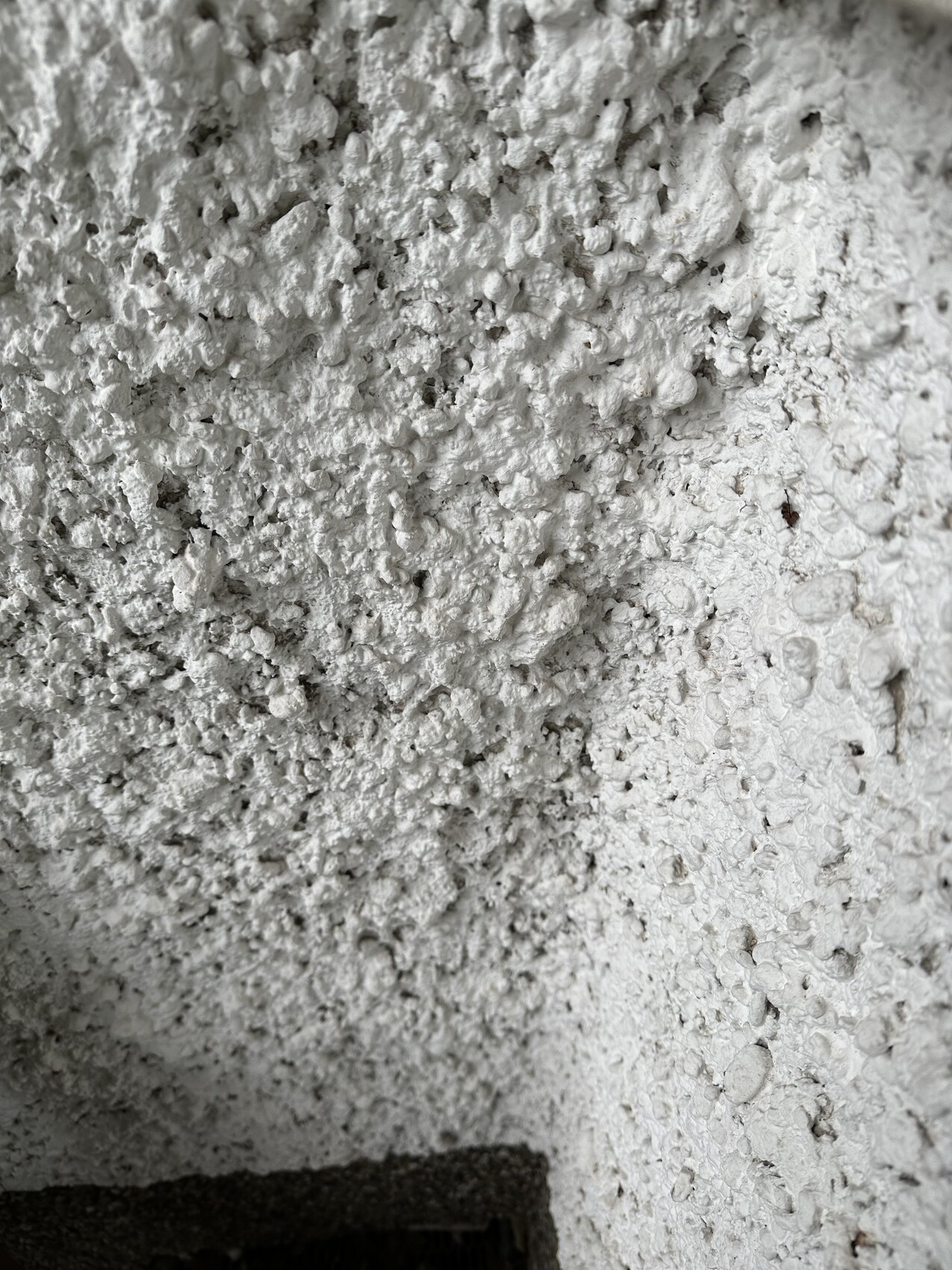

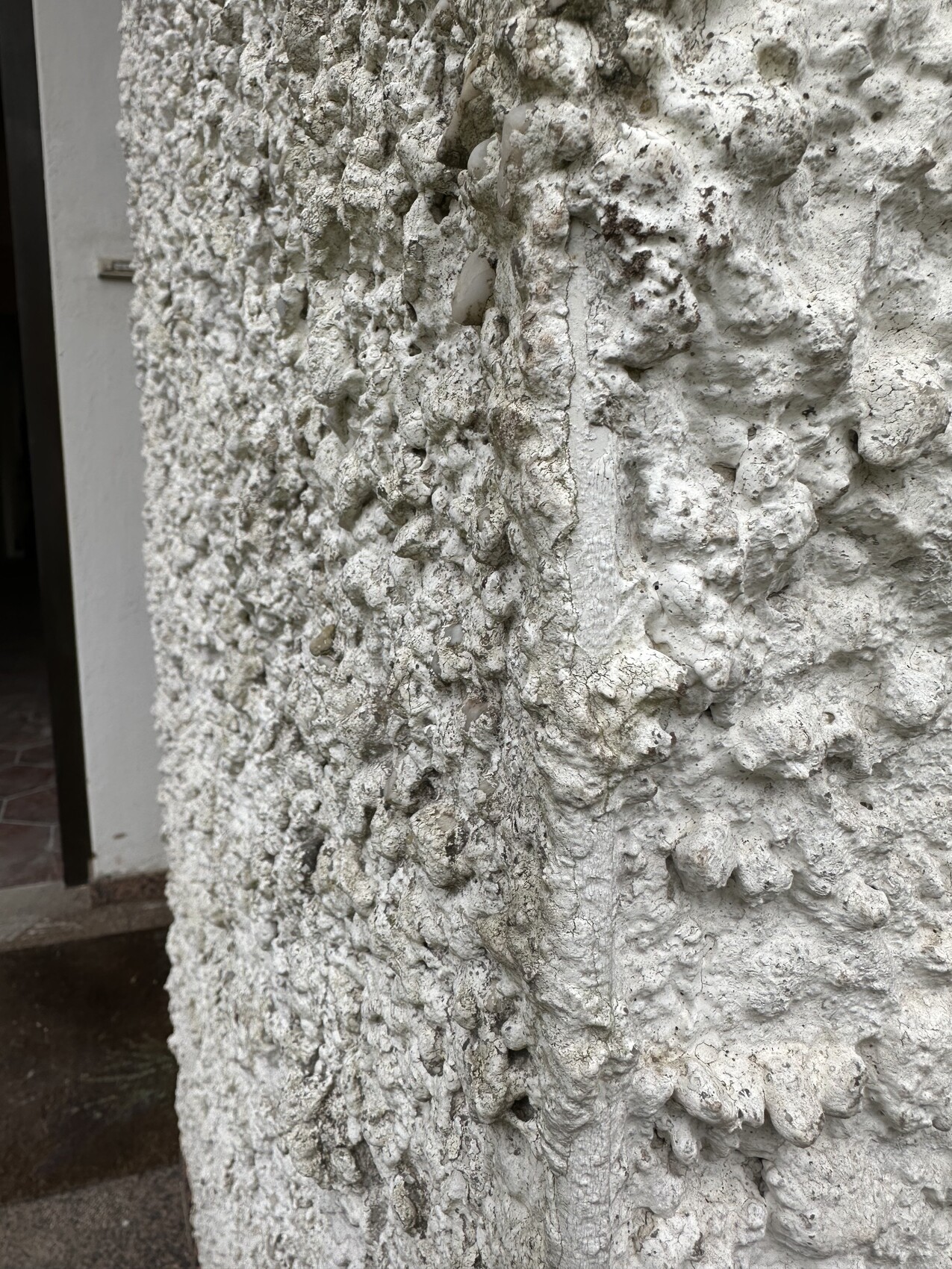

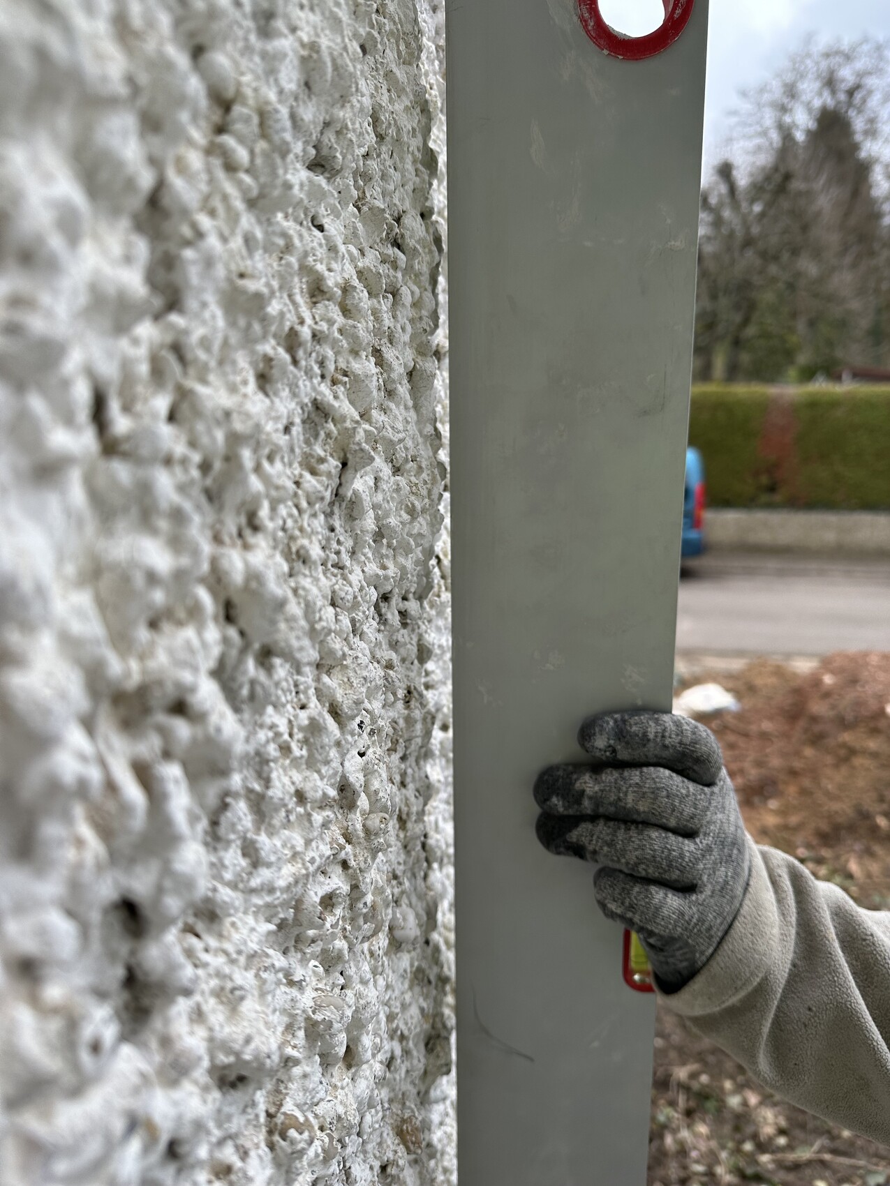

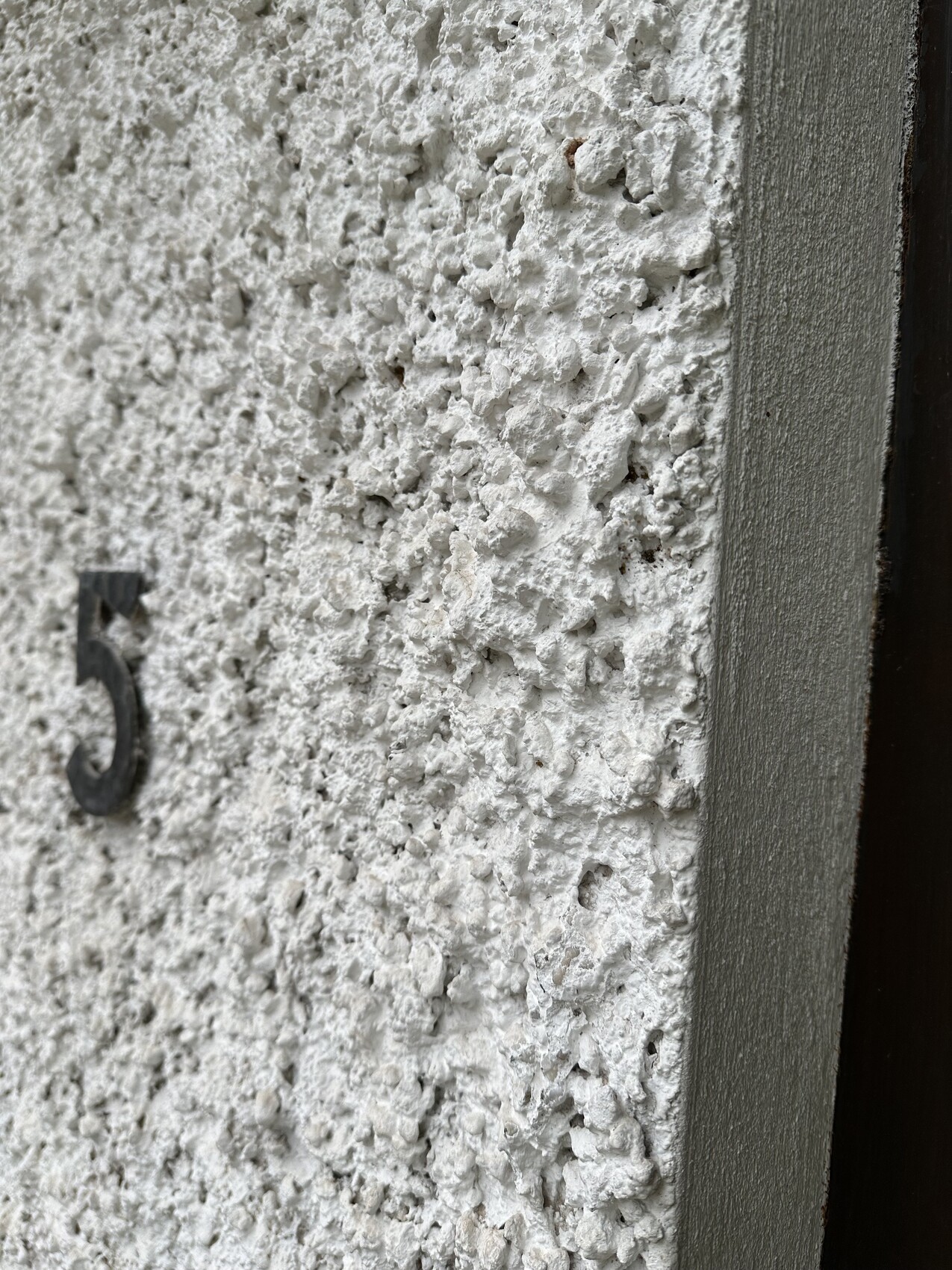

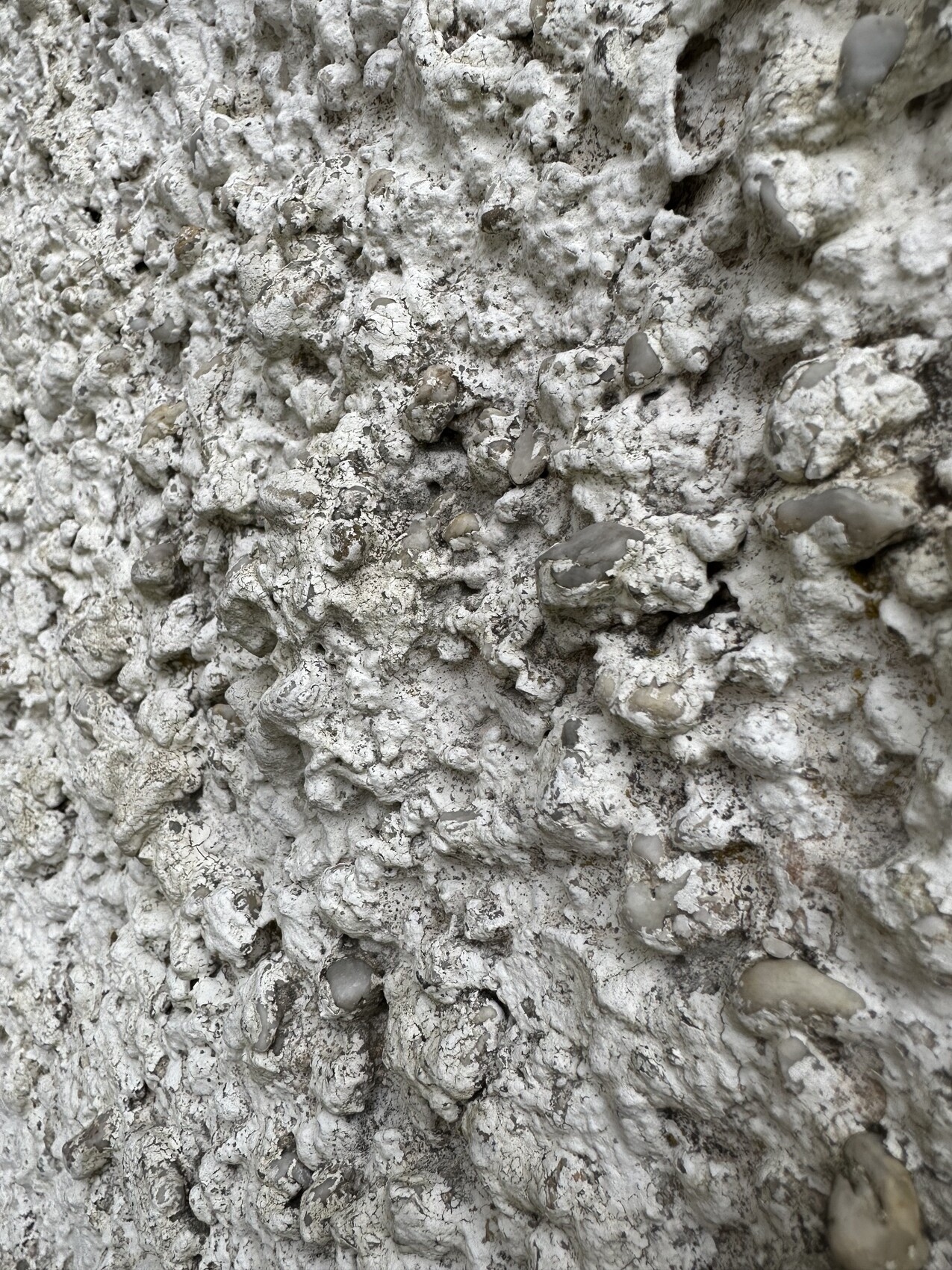

LarsKochWe have a house from the 1970s. The masonry is made of pumice stone. The exterior render is firmly attached to the wall. It is a VERY coarse roughcast render, applied very irregularly with many thick areas (sometimes several centimeters (inches) thick).
We need a relatively smooth base for our external wall insulation system (EWI). Now my question is, how can we smooth out or completely remove this awful render? What options are there for dealing with such a render?
Attached are some pictures, thank you for your suggestions.

nordanney13 Mar 2024 12:35LarsKoch schrieb:
We need a relatively smooth base for our external thermal insulation composite system. Which system and what are the manufacturer’s specifications? What does the contractor say?
LarsKoch schrieb:
Now to my question: how can we smooth out or completely remove this terrible render? What options are there for dealing with such a render? - Sandblasting or bead blasting (but this can damage the pumice once the render is removed)
- Mechanical removal (using a hammer and chisel or suitable tools)
- Applying a smoothing render coat
Do you plan to do this yourself, or should a professional company handle the preparations?
