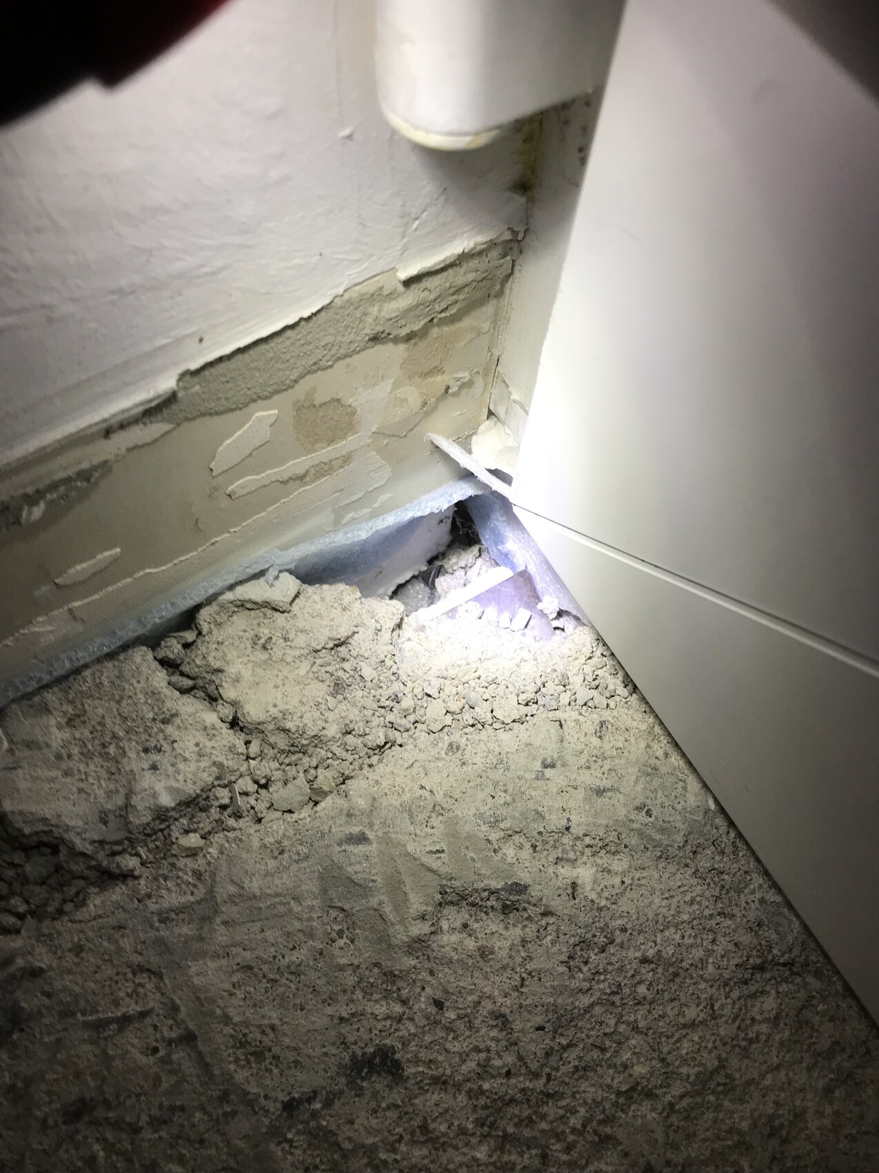

PS:
Having to deal with issues like in the attached picture also adds extra time later on.
I had to fill and level that.
And apply self-leveling compound along the entire kitchen run because we had a noticeable hump in the screed.
