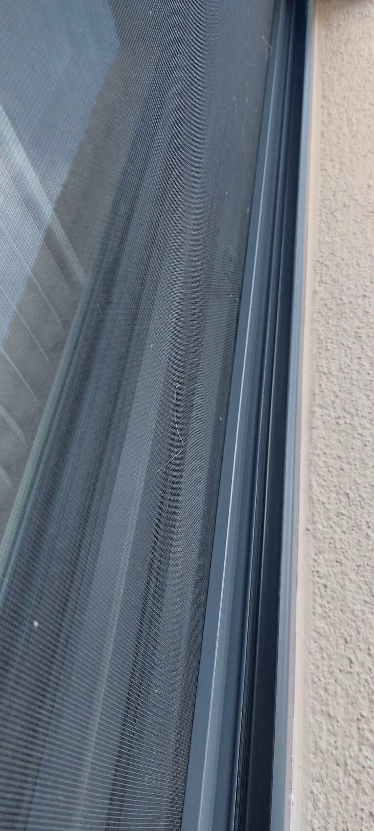

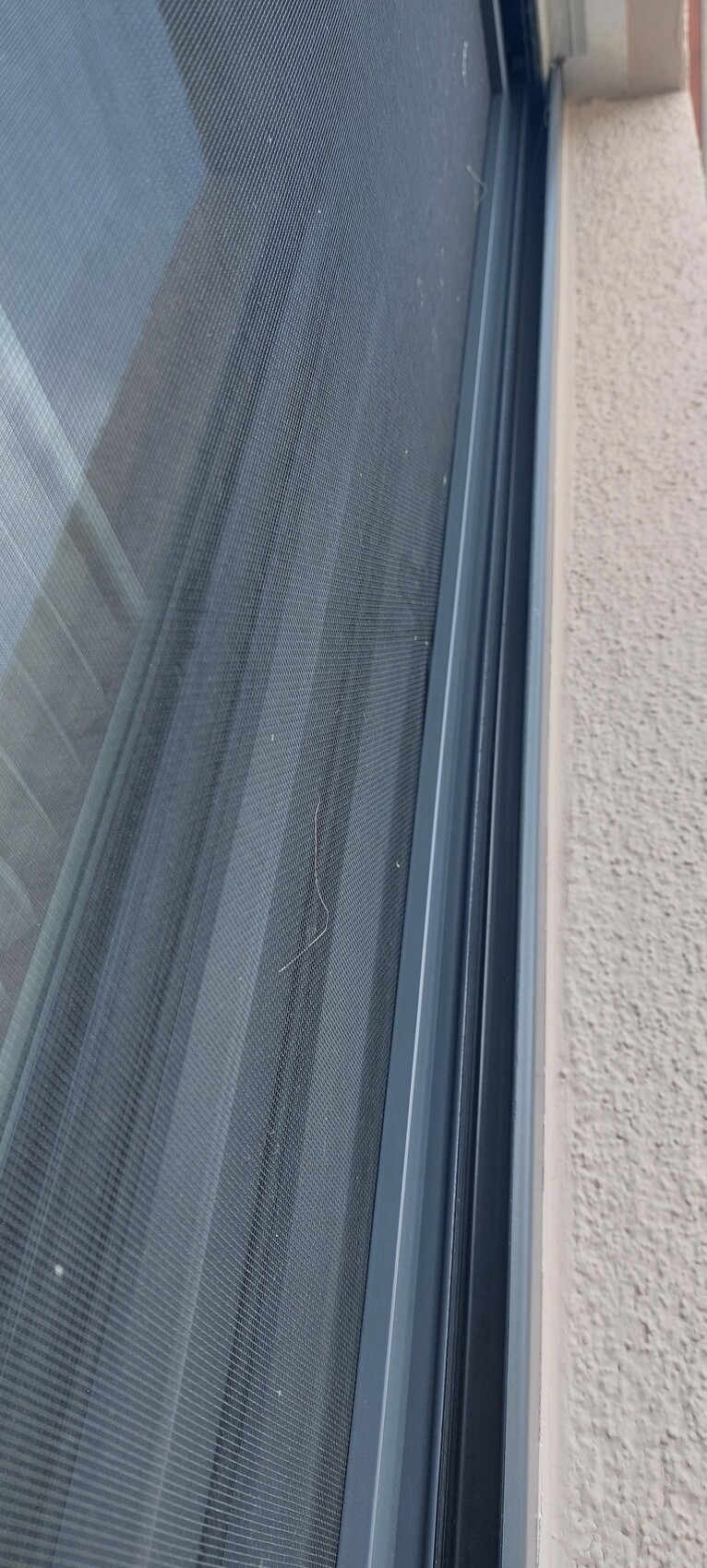

I have a problem. The roller shutter on our house has torn after 7 years.
We have an internally closed roller shutter box from Beck and Heun.
How do I remove the shutter? From the outside? It used to be easy—just remove the inner cover and you could access the roller tube.
How do I remove the guide rails? Are they clipped in? I don’t see any screws.
Do they absolutely have to be removed? They are plastered in.
I’m attaching pictures.
Thanks a lot for your help!!

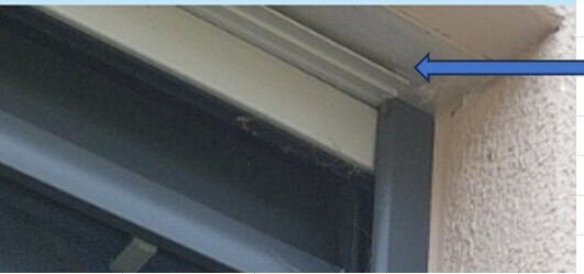

The arrow points to the cover that is usually removable.

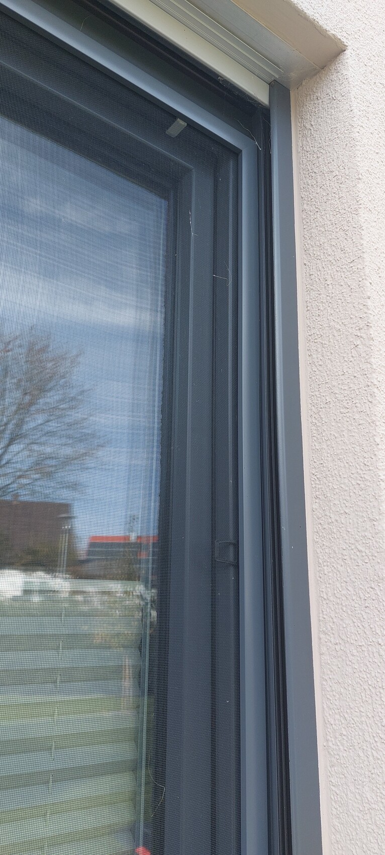

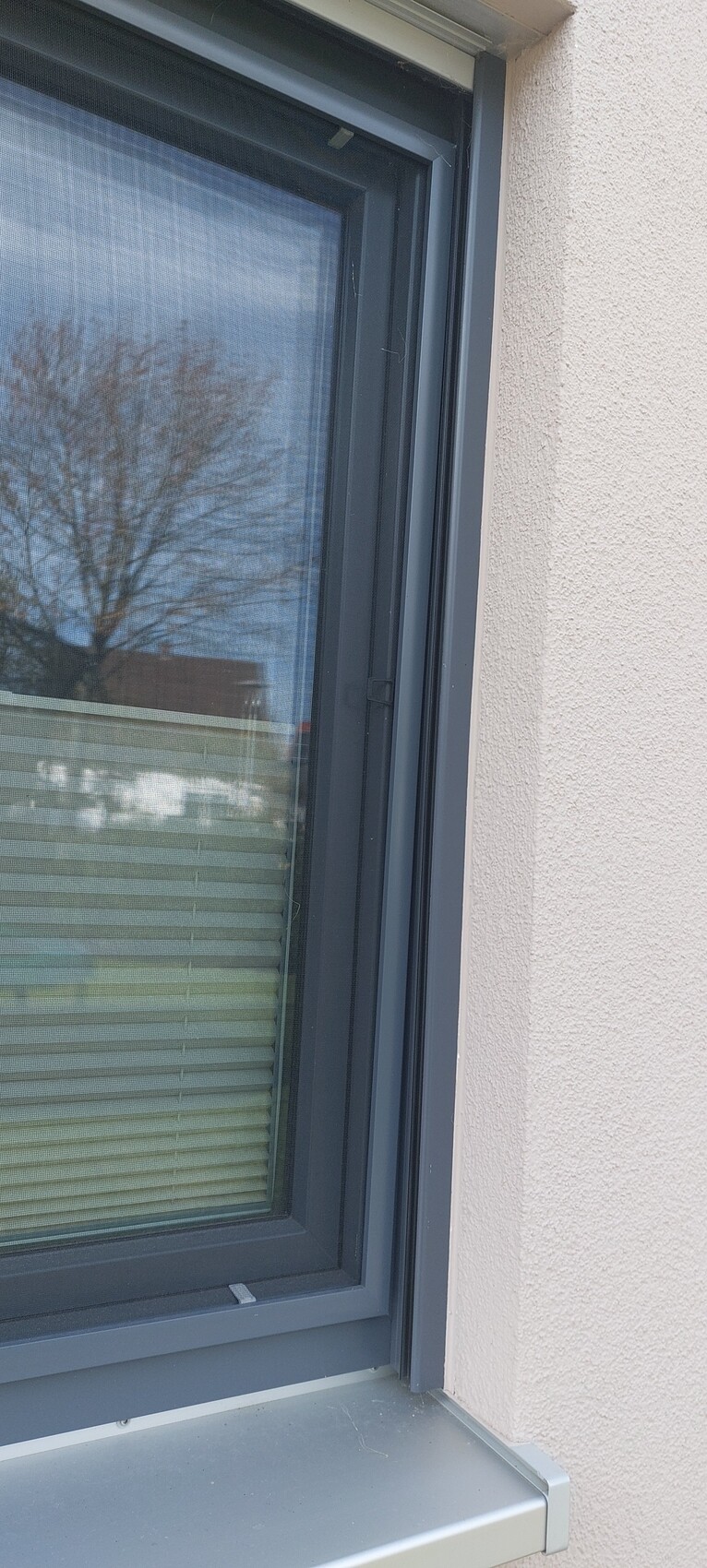

krischaaan
1 Nov 2025 14:19
The picture shows another identical window.
The other one is downstairs, so I can’t take a photo.
The cover is clear, but do I need to remove the tracks, and how do they come off? Regards
hanghaus2023
1 Nov 2025 17:58
The cover is removed, then you can access the roller shutter. If the roller shutter is fully lowered, this should not be a problem. The guides are embedded in the wall, so why would you need to remove them?
