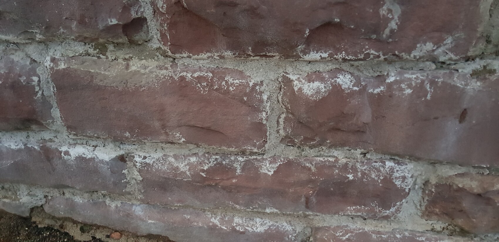

Here is a photo of the building ...
Close-up of a red brick wall with white mortar and lime spots.
tomtom798 Dec 2021 16:00
Oh dear, I had completely different ideas in mind. Here, I would strongly recommend trying a steam cleaner first, and if that doesn’t help, then dry ice blasting.
