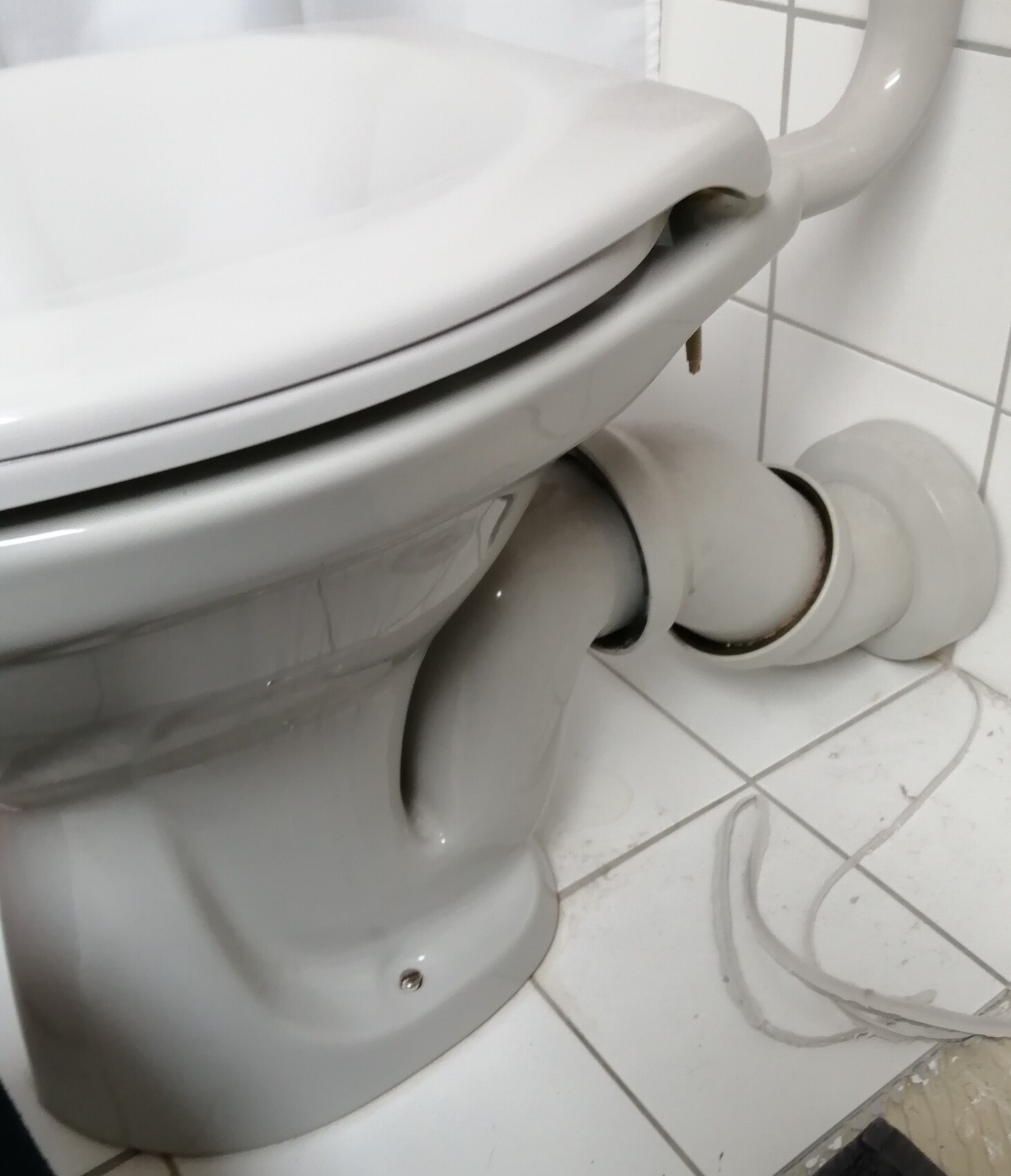

Gerd53The floor in the attic bathroom will be renovated. For this, the toilet needs to be removed for several days.
What should be considered?
See image.
- How should the toilet drain opening and the pipe opening in the wall be sealed?
- Is a strong odor expected?
- The toilet must be moved to another room.
How heavy is it approximately?
Can one person manage this? Possibly with tools such as a wheeled transport board or a hand truck.
What else should be taken into account?
Thank you

nordanney13 Apr 2021 09:23Gerd53 schrieb:
What needs to be considered? Turn off the water supply to the cistern. Unscrew the bolts from the floor. Carefully lift the toilet—there is still quite a bit of water inside.
Gerd53 schrieb:
- How do you seal the drain opening in the toilet and the drain pipe opening in the wall? Push in an old sock or T-shirt ;-)
Gerd53 schrieb:
- Is a strong odor expected? If sealed properly, then no. Otherwise, it depends on what smells come up from below...
Gerd53 schrieb:
- The toilet needs to be moved to another room. Then you’ll have to carry it...
Gerd53 schrieb:
How heavy is it approximately? About 20 kg (44 lbs)
Gerd53 schrieb:
Can one person do it? The 43 kg (95 lbs) “lady boss” maybe not. The average person yes 😉
