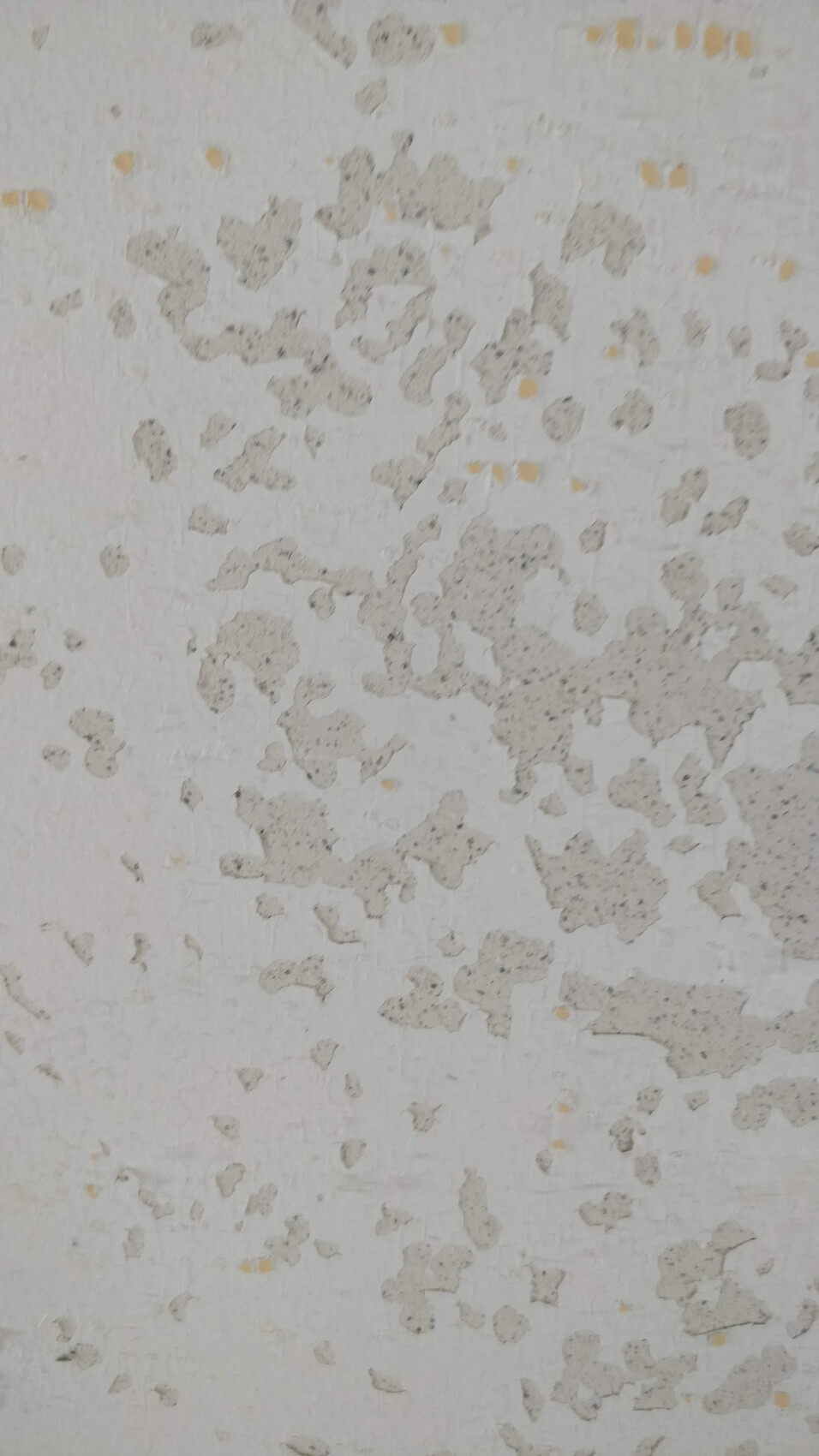

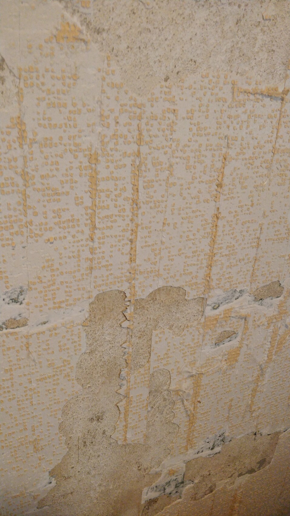

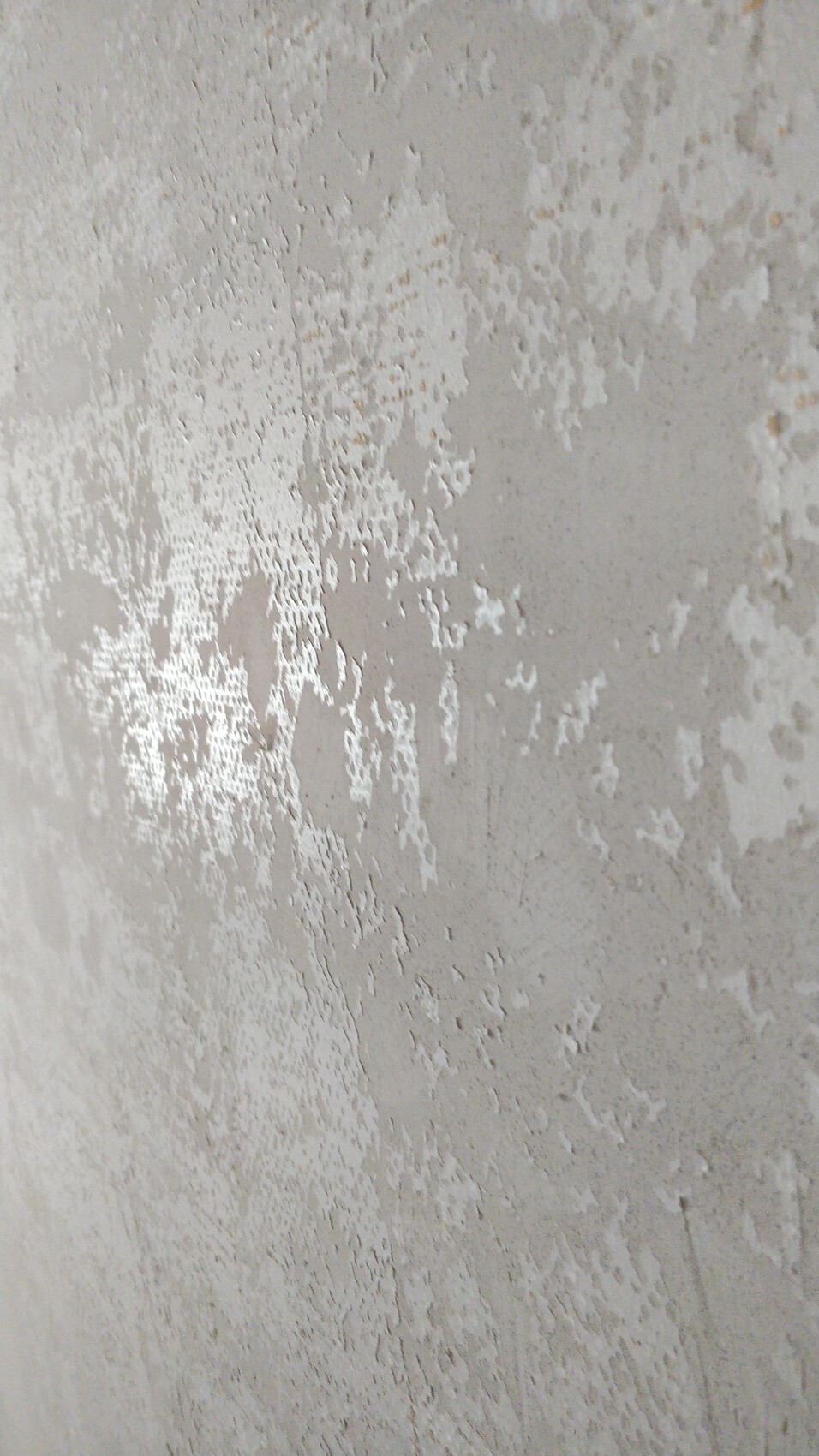

We have removed fiberglass wallpaper from the walls in two rooms. In one room, the wallpaper came off relatively well, but in the other room, it was a bit more difficult (see pictures). Later, we plan to hang new wallpaper on these walls (approximately like the one shown in the picture, "Novaboss").
Question regarding the "good" wall: Do all small residues need to be completely removed before applying the new wallpaper? There are a few minor damages here and there that still need to be repaired. I tried to remove the small residues with a sander — it works somewhat, but takes a very long time. Are there other ways to remove these residues?
Question regarding the "bad" wall: The wallpaper was more strongly glued to the wall here, so a lot of plaster came off with it. What is the best way to proceed in this case? Is it enough to remove the yellow residues with a scraper and then roughly skim coat over it?
