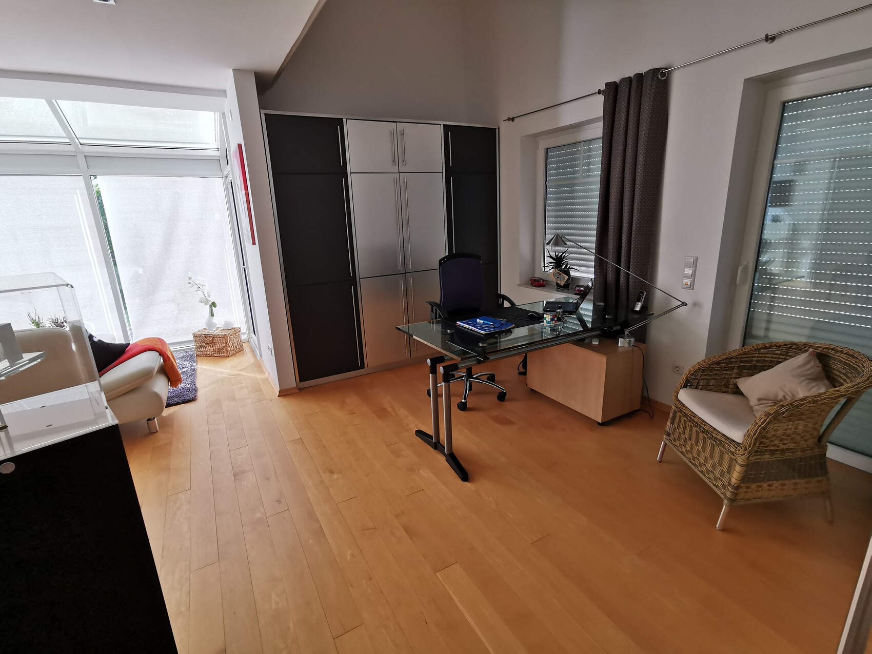

We are planning to relocate our kitchen to a new room. Currently, this room is used as an open office with a sofa and a piano.
Where the black/silver cabinet is now, water, drainage, and electrical connections are already installed. However, we plan to place the dining table exactly there.
Modern office with glass table, black cabinets, wooden floor, and wicker armchair.
The kitchen will consist of a built-in kitchen cabinet wall and a cooking island, which will be placed in front of the window.

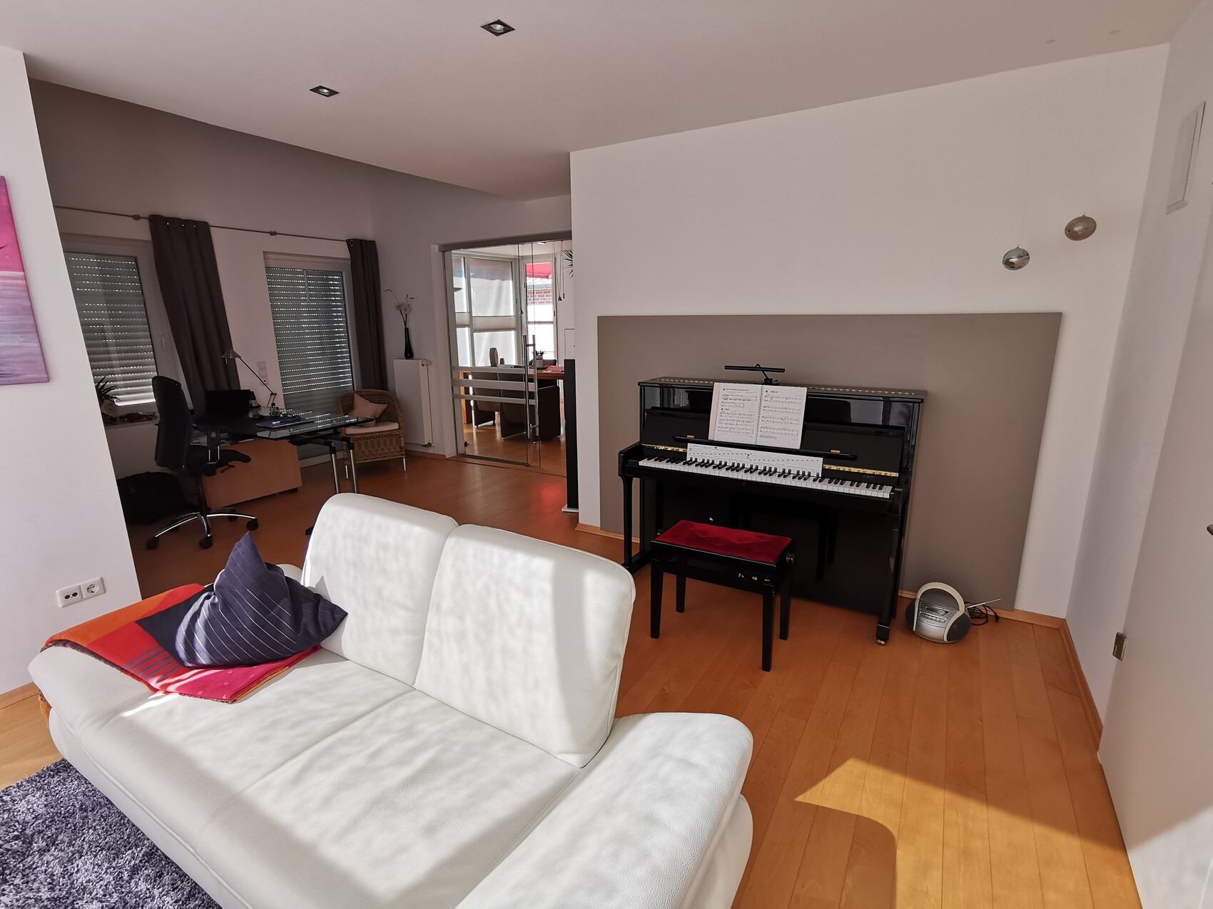

The kitchen cabinet wall, including oven, refrigerator, and freezer, will be positioned along the wall where the piano currently is.
The cooking island, featuring an induction cooktop, recirculating extractor hood, dishwasher, and sink, will be where the white sofa is now:

My question is whether this layout is even possible. The floor is made of Australian maple parquet screwed onto cross beams. Below the parquet is about 30cm (12 inches) of insulation material (glass wool), and beneath that is a screed layer.
Is it feasible to extend the fresh water and drainage connections into the middle of the room in this way? What slope must be observed for the drainage?
What are the typical costs for installing new fresh water and drainage connections in this scenario?
Is there anything else we should definitely consider when relocating the kitchen?

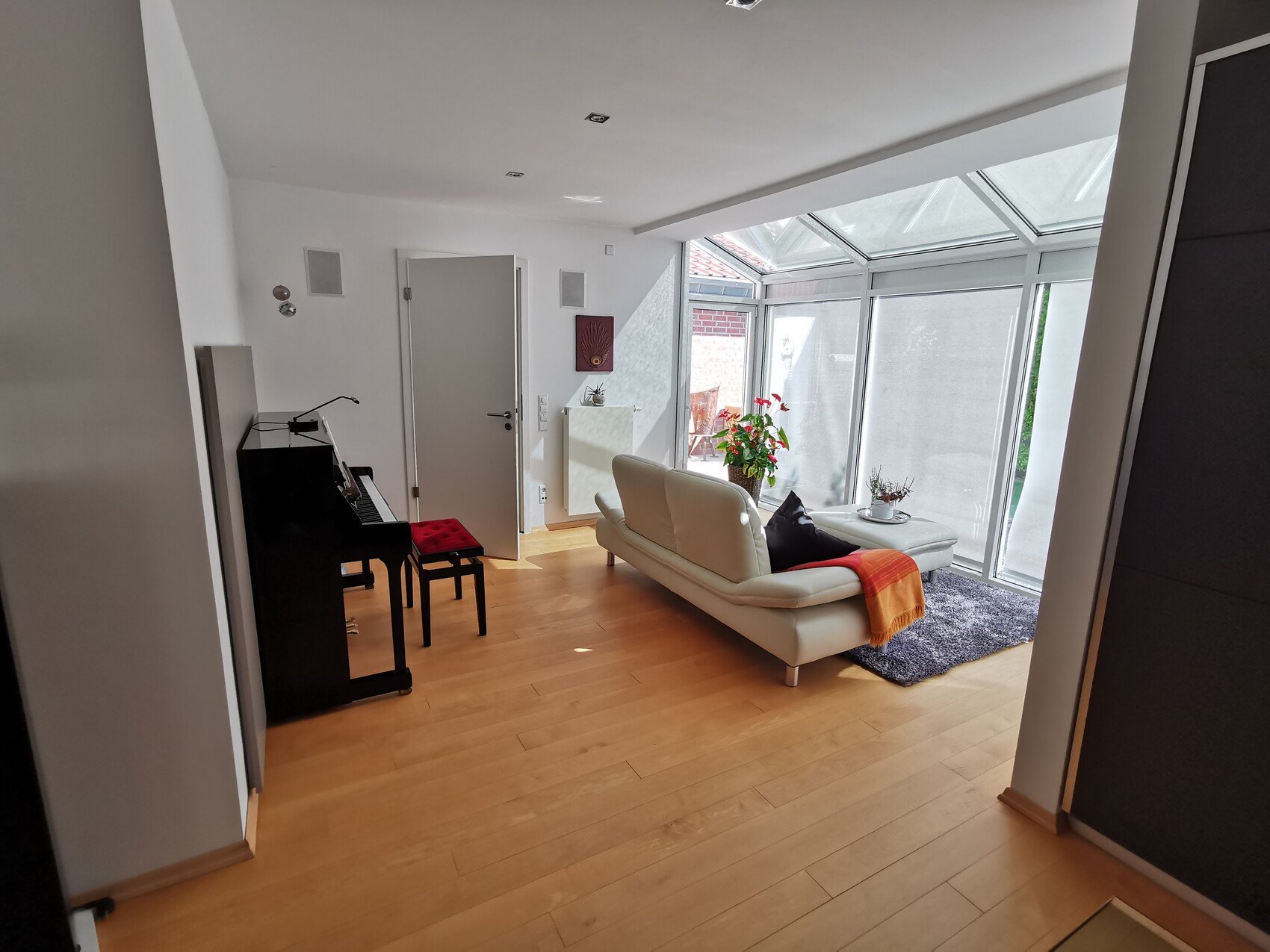

It is a single-family house built in 2006 and owned by us. The office and later the planned kitchen are on the ground floor. Unfortunately, I don’t have drawings with pipe layouts yet. Above the current position of the white sofa on the first floor, however, there is a bathroom. Considering that water and wastewater connections are located where the current black/silver cabinet is, I strongly assume that to the right of the white sofa in the photo below, the stack pipe runs along the wall.

That won't help. You need to find and show the complete plans. All floors and preferably all piping. It might be more practical to run water and wastewater lines through an adjacent room by going through one or two walls, rather than breaking up the parquet flooring or running pipes across the room.
