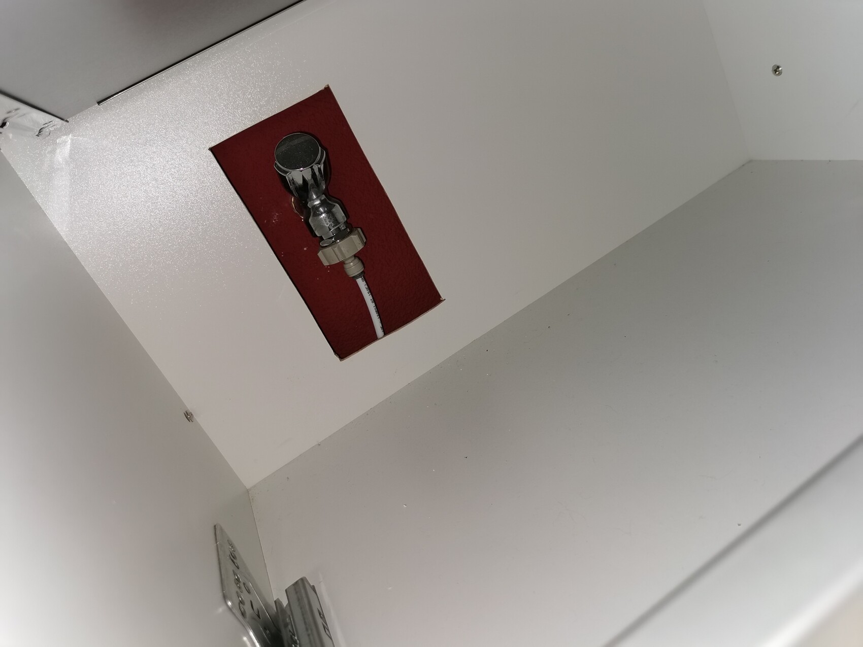

For me, easy access to the filter for replacement is important, for example, under the sink cabinet in the toe kick area.
If you have to pull the refrigerator out every time, it is
1. very annoying
2. something you tend not to do
When installing a new kitchen during the shell construction phase, it shouldn’t cause any problems or significantly increase costs to install a faucet.
As for the water tank... well, if I can plan it, I find a fixed connection more hygienic.
In our case, the filter is built into the door, and it signals when it needs changing every 6 months (700 liters).
