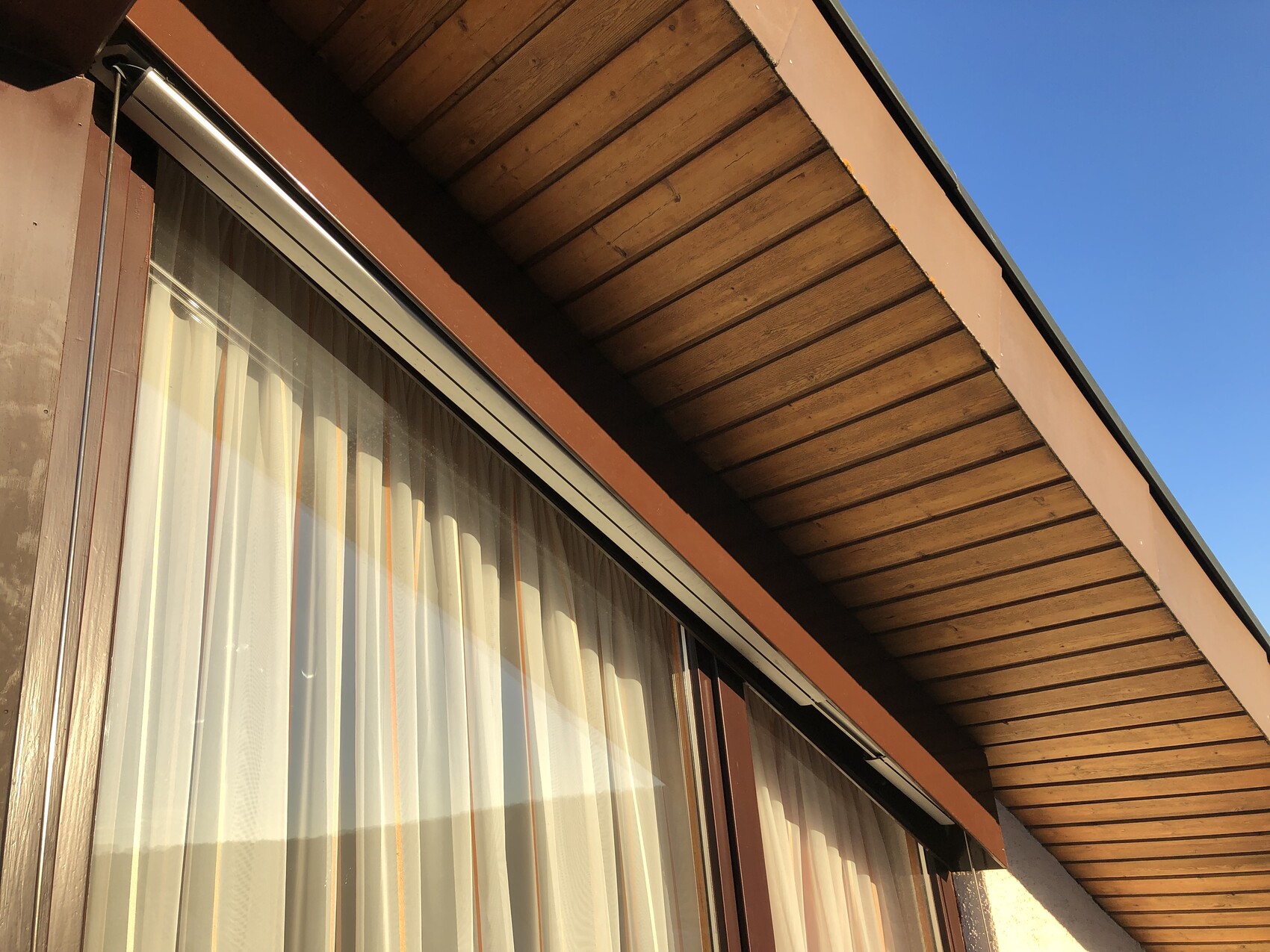

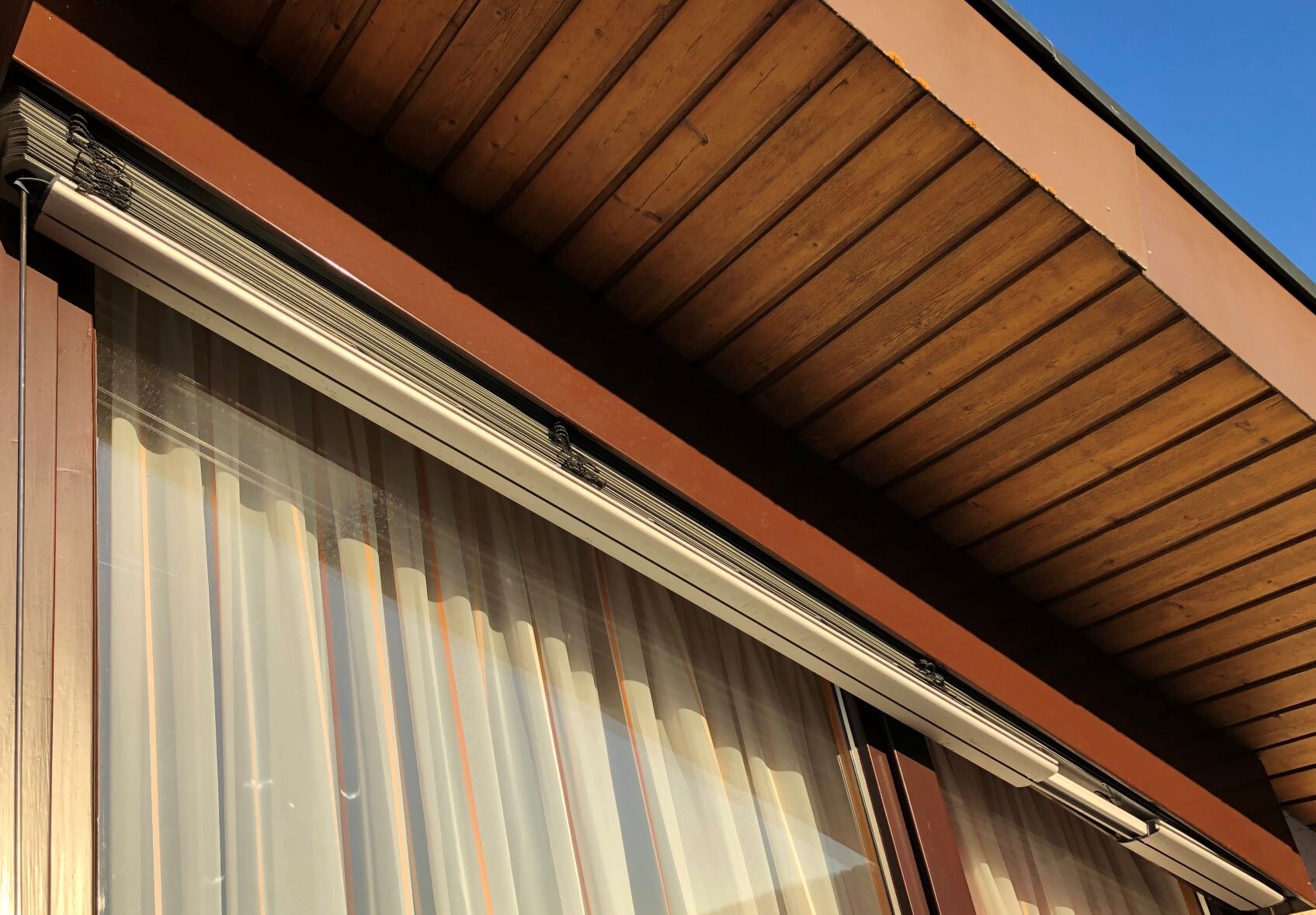

I have installed the above-mentioned external venetian blinds (Raffstore) for slanted windows on my house.

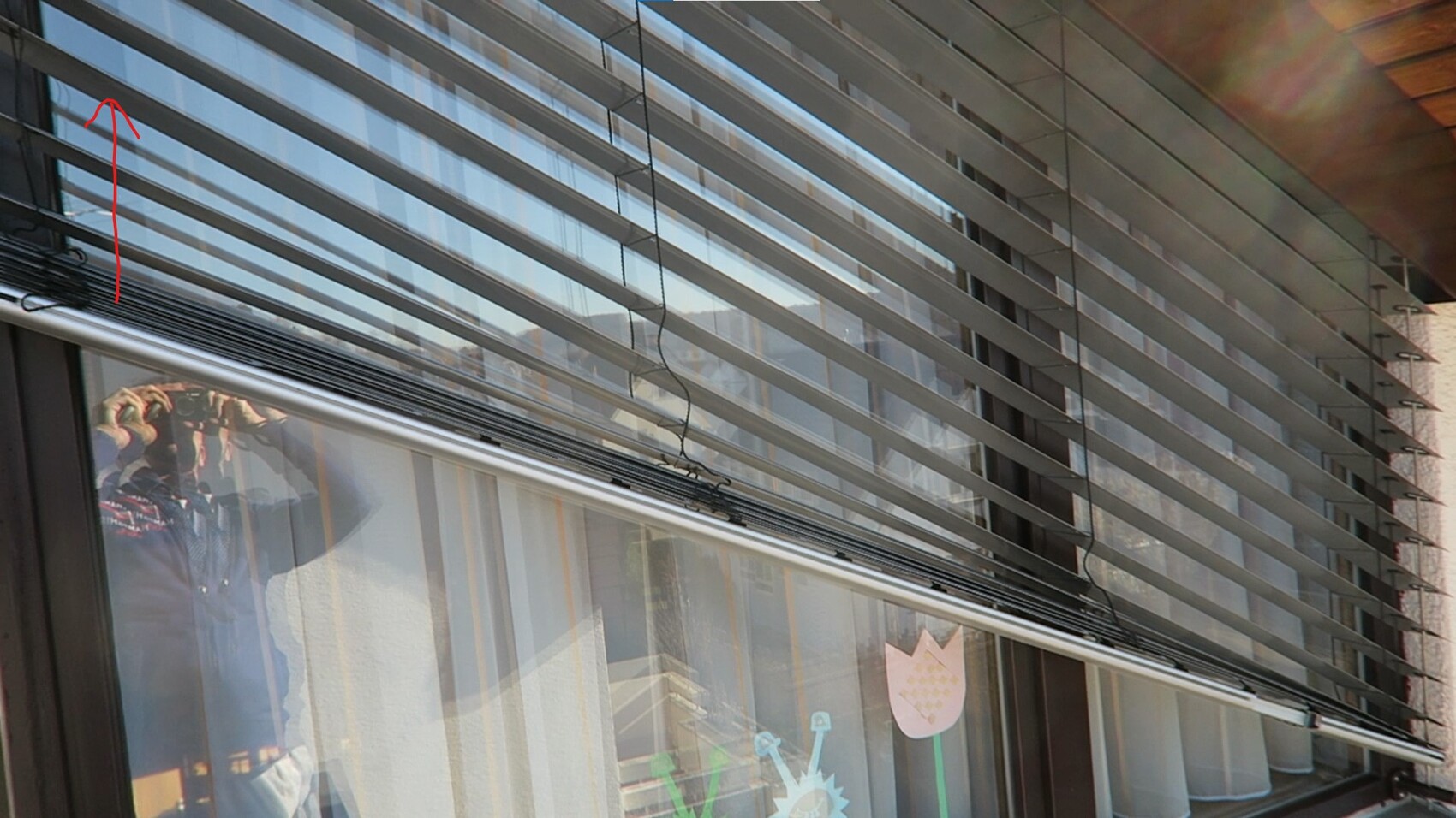

Unfortunately, shortly after installation, problems appeared as shown in the pictures, with the blinds gradually tilting more and more when rolling up.
The issue is that once the right side hits the top housing, the motor doesn’t stop but continues running until the left side also reaches the top.
As a result, the straps on the right side seen in the picture have already snapped several times.
Unfortunately, the manufacturer Reflexa claims that the problem is not due to a faulty product, but alternately blames wear and tear, incorrect operation, or that an object got stuck there, among other explanations.
The first time, I was charged €500 for the repair. On two other occasions, it was repaired "as a gesture of goodwill."
Now, on the fourth time, they are ignoring the issue.
Does anyone have similar experiences or ideas on how to solve this – thanks in advance!

The windows are located just under the roof, so the top edge is not horizontal — it’s angled.
Just watch the advertisement from Reflexa for the "AsyFlex blinds for the most angled windows," and it should become clear.
In any case, these damn things don’t roll up the cords evenly or reliably, which causes situations like the one shown in the attached picture.
If no one is careful, the blind rolls into the box, and the cord on the side that enters the box first tears without mercy because the motors don’t have resistance detection or built-in limit switches.
According to Reflexa, however, everything is perfectly fine and the customer is doing something wrong... :-)
All I can say is stay away!
