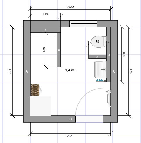

knalltüte27 Jul 2020 22:07Great, lots of input already. Please revise the plan. Keep in mind, the first bathroom (with a bathtub on the ground floor!) is settled for me.
Now the plan for the upper floor excludes a bathtub but includes appliances.

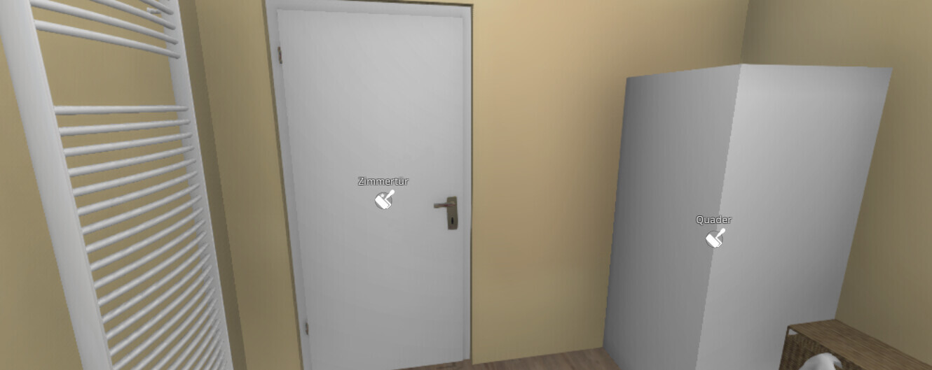

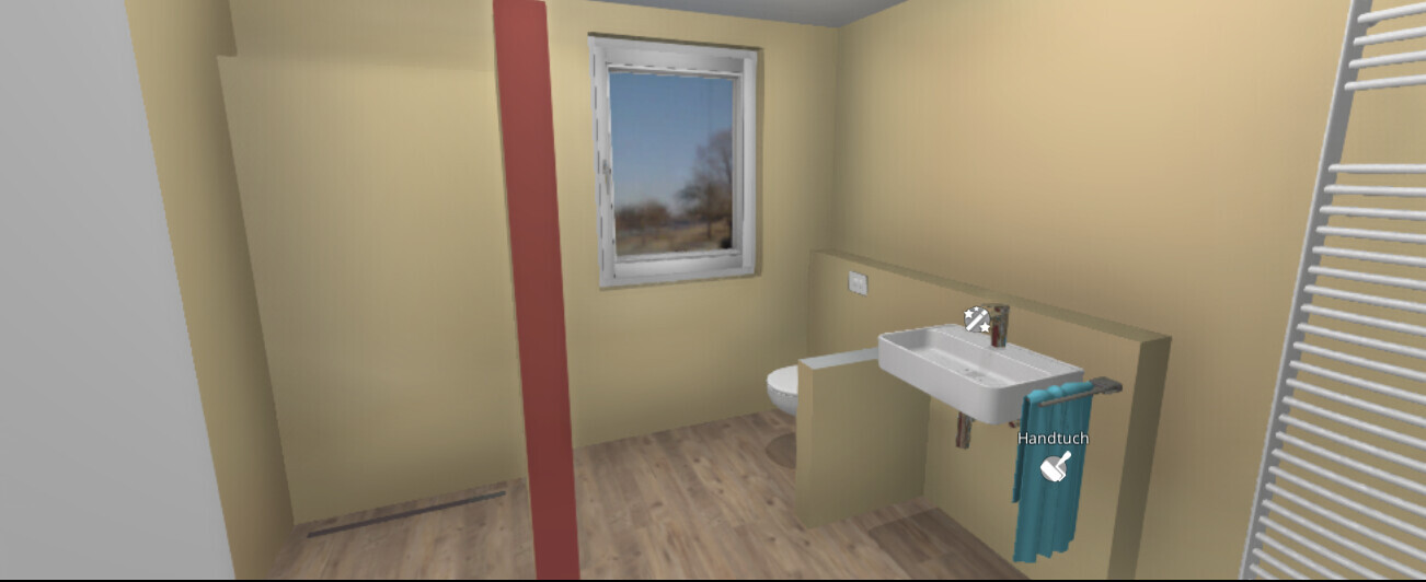

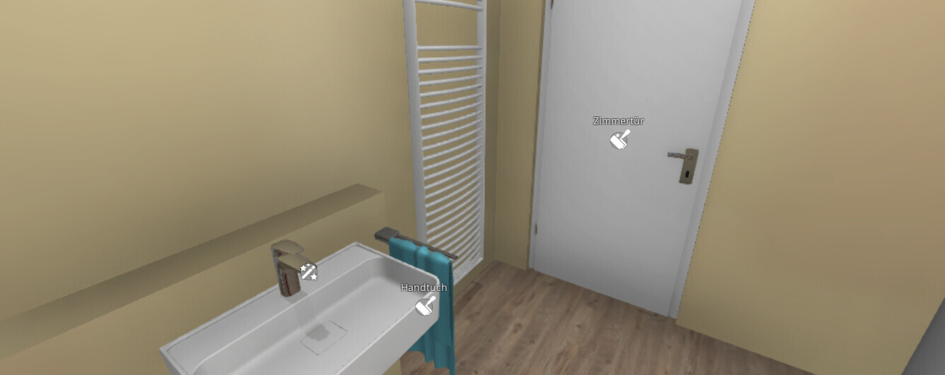

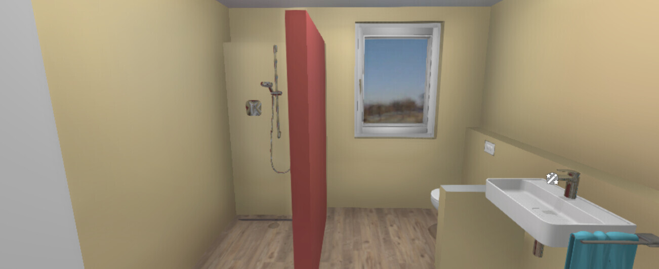

pagoni202027 Jul 2020 22:11Pinky0301 schrieb:
I wouldn’t dedicate the best spot, meaning the one next to the window, to the machines. Yes, rather immediately to the right or left after the door, and one spot is enough. Otherwise, the tenant can stack items, which is quite common.
knalltüte27 Jul 2020 22:30P
pagoni202027 Jul 2020 22:36I would probably rotate the shower toward the toilet and build a half-height wall; place glass panels on the outside, creating a storage ledge inside for shower gel and similar items. This would also allow more natural light in the shower—currently, artificial lighting is needed. I had exactly this setup in my holiday apartment and found it very comfortable. Additionally, I don’t like edges that I might accidentally walk into. The toilet with the wall fits well and next to the window, which is perfect.
