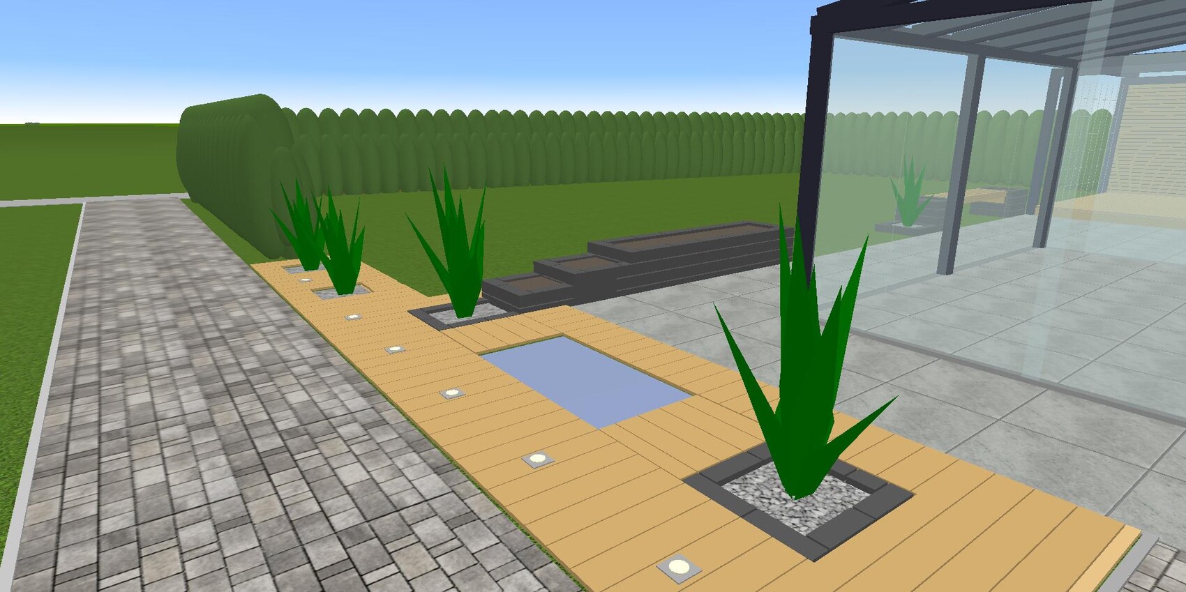

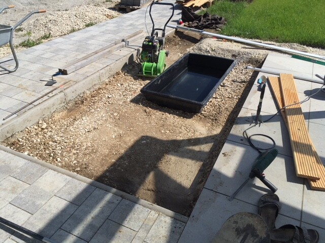

I am planning a small rectangular water basin next to the terrace.
At first, I wanted to use a prefabricated plastic basin, but it would have to be partially buried. Otherwise, it would be too unstable and would need additional support.
Option 1:
Place a PE (polyethylene) prefabricated pond at the desired location. However, I can only half-bury it because the substructure for the wooden decking still requires some build-up. I might also set some edging stones in concrete around it for stabilization.
Option 2:
Build with shuttering blocks, reinforce, and pour concrete. For this, I would need a pond liner, and I have no idea if I can install it wrinkle-free in a rectangular basin. It’s definitely more work, and I don’t have much time… plus, there’s still a lot to do in the garden… 😀
Option 3:
Use shuttering blocks and instead of a liner, work with a two-component waterproofing slurry. For this, I would have to pour a concrete base slab. Everything would have to be perfectly level to get the final height right. I’m not a landscaper, so this seems quite demanding for me.
I’m leaning towards option 1. It also allows more adjustments if things don’t turn out as I imagine. Once the wall is concreted, it’s much harder to change.
Does anyone have another idea?
3D sketch attached.
