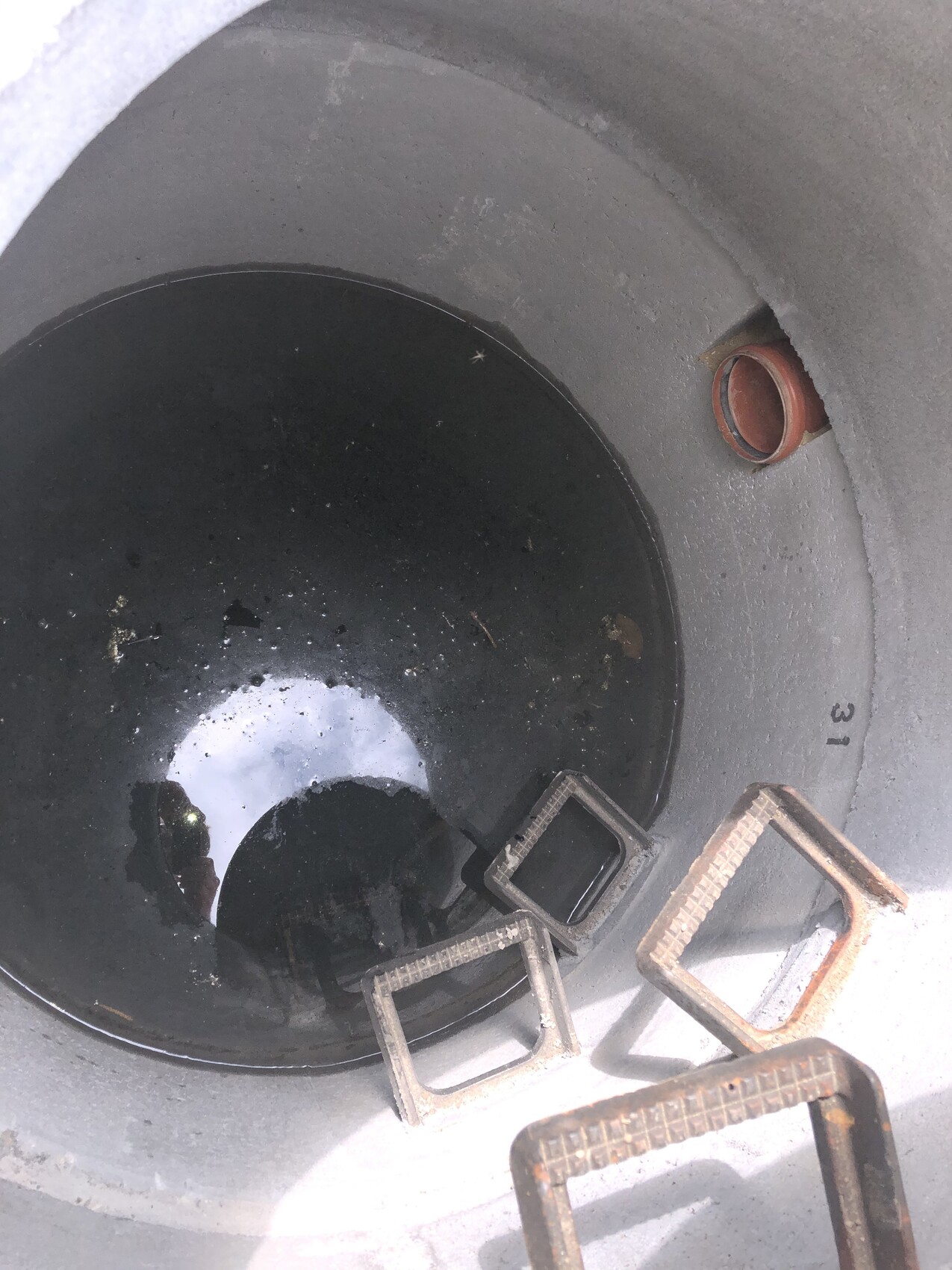

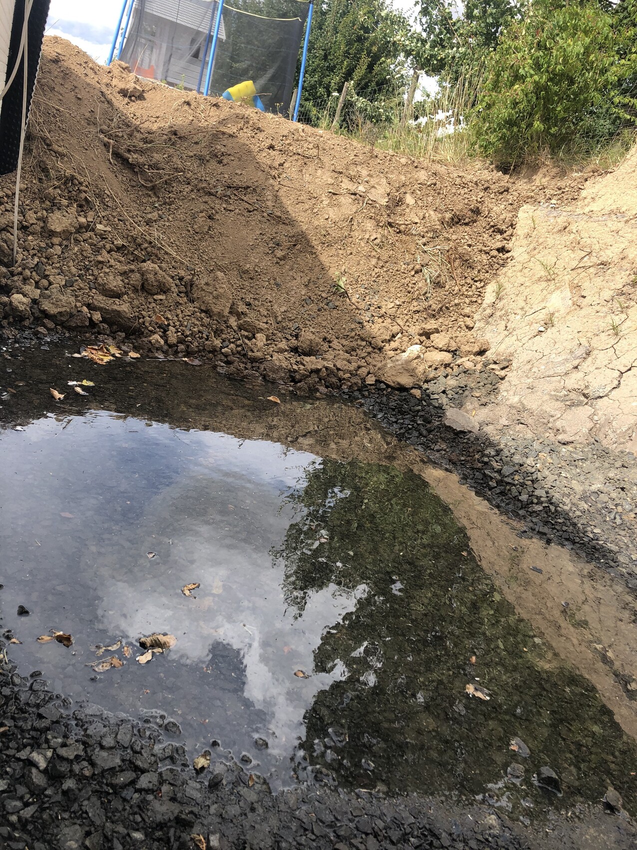

pagoni202028 Jul 2020 21:46So, you have two basins. One inside the concrete cistern with the overflow pipe, and the other next to it, uncovered in a hole in the ground?
So the water is pushed into this open hole despite the cistern?
Hmm... I'm not really sure how you can fix that.
You should embed the red pipe properly so that the water flows only into the overflow. Then I would control it with a domestic water system, but ALWAYS and WITHOUT FAIL have a cover on the cistern. Oh dear... be very careful with that... children and untreated water...!!!!!!!!!!!!!!

Scrooge McDuck28 Jul 2020 21:51If the shaft isn’t too full, there is no water in the underground pit. Actually, no water should come up there in the first place.
I plan to pump the shaft empty tomorrow and see if the water in the pit evaporates fairly quickly.
What is the best way to coat the red pipe? I mean, with what should I do that? The excavator said it’s fine as it is... but I can manage it.

Scrooge McDuck28 Jul 2020 22:062. Clay soil
5. Rheinhessen table and hill country
6. No mud, pond, or anything similar. Soil sample did not reveal anything unusual either. However, the earth beneath the topsoil was saturated with water. The earthworks contractor pumped out the foundation pit in the evening, but by morning there was a small pond again at the bottom.

I would find it difficult to take any measures without knowing the source of the water. I’m not a hydrologist or anything like that, but if you pump out large amounts quickly, it can cause other problems. Groundwater layers, for example, will keep flowing in—and may even lead to unwanted side effects (possibly even much more water will flow in because water tends to follow the path of least resistance). Otherwise, in a similar setup (rainwater from the roof), we have a submersible sewage pump from Homa. It is absolutely reliable and nearly silent.
