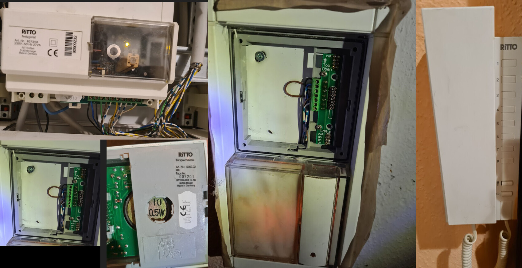

I am considering getting a video intercom system but am not sure about the options available if I want to keep my existing RITTO base power supply unit. Attached are photos of the current hardware:
- RITTO power supply unit 6573/04
- Door intercom module 5760.02
The goal is to have a video intercom system with LAN/Wi-Fi connectivity that can be controlled via a smartphone.
Thank you in advance.

RegardsI’m not an expert, but as far as I can tell, your system is designed only for audio. A video intercom for outside (and possibly inside) would likely need to be new. The wiring is probably more important than the power supply unit. Whether your current power supply fits would need to be checked.
As a DIY solution, an IP camera might be an option, which you could access via smartphone. However, I have no idea how well audio and video could be synced in that setup.
