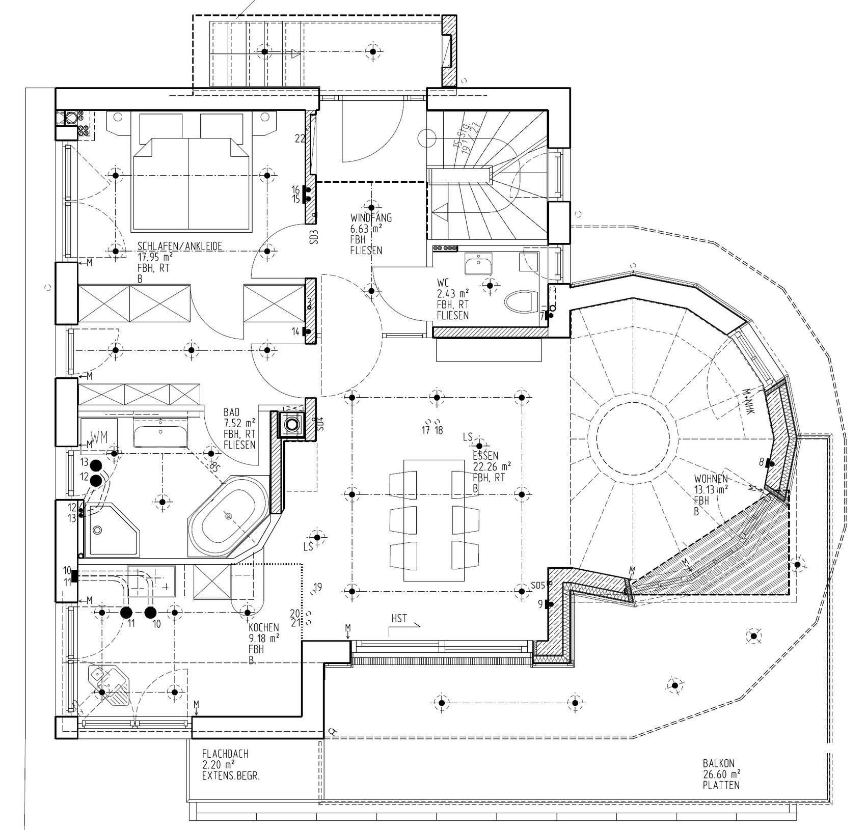

we are currently building a single-family house and have installed recessed downlight housings with a diameter of 180 mm (7 inches) for the general lighting (layout according to the attached plan).
Now we are looking for suitable recessed spotlights to fit these housings.
What luminous intensity would you recommend per spotlight to ensure good visibility without being too harsh?
What beam angles would you suggest to avoid uneven light spots on the floor?
We would greatly appreciate your experiences and recommendations.

Fleckvieh25 Jun 2025 07:47@Molydeam & @dietmar, thank you for your feedback.
In the bedroom, there will of course be bedside lamps, a pendant light in the dining room, and appropriate mirror lights in the bathroom.
The spotlights in the dining room will remain as general passage lighting or for even illumination when cleaning is needed.
Regarding the light intensity again:
The Philips spotlights have a luminous flux of 575 lm, which gives me about 230 lm/m² in most rooms.
The Occhio lights have 1010 or 1290 lm, which means about 500 lm/m². Online, I found recommendations of 100 to 150 lm/m² for living and sleeping areas. Wouldn’t that be too bright? Or would you always dim them down to about 20%?
