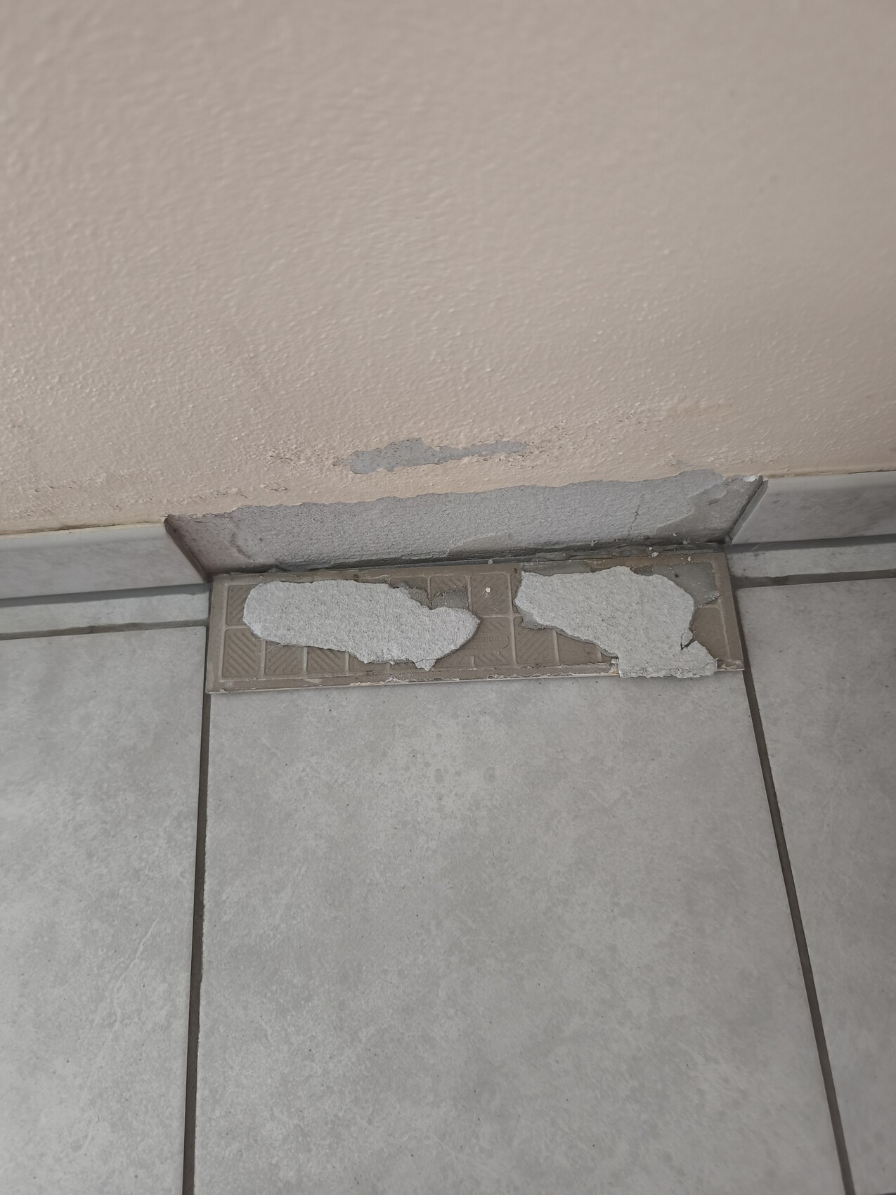

I just looked it up...
Can you recommend one?
Are there similar ones available in other containers? My 'tongs' are in use.
How do I handle the joint on the left, right, and bottom?

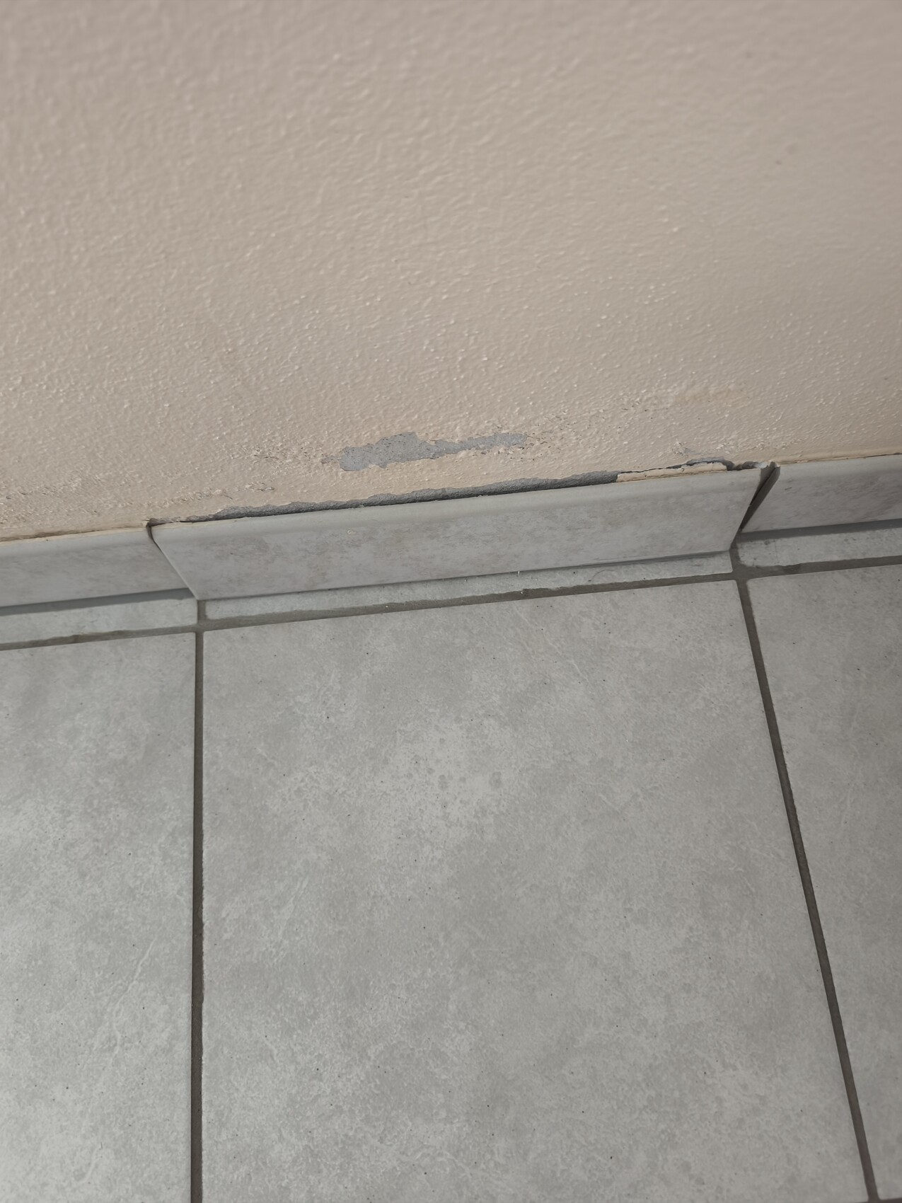

Standard assembly adhesive. No special product is needed – this will hold better than any other tile afterward. For simplicity, I would grout the joints with the same silicone used for the joint below. Otherwise, use the same material that was used for grouting the entire area...
nordanney5 Dec 2025 19:12Nauer schrieb:
Standard installation adhesive. You don’t need anything special – it will hold better than any other tile afterwards. To keep it simple, I would grout the joints with the same silicone used for the joint below.If you have suitable silicone, you can also just use silicone for bonding and don’t need to buy a separate cartridge of adhesive.Similar topics
