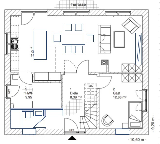

This is one of the finished drafts from the general contractor; the adjustments for us will follow. Thanks in advance for your feedback! We find having the utility room next to the kitchen quite practical because groceries can be distributed quickly and easily from the main entrance directly to the utility room (storage shelves) and the kitchen.

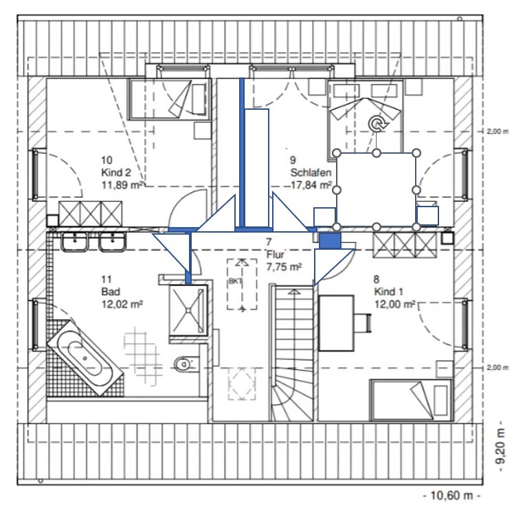

Exactly, we also think the master bedroom is very large; we would probably use it as a children’s room or slightly redistribute the room sizes. We really don’t need that much space. The room around the guest toilet will be extended, precisely for the reason you mentioned. 😀
@WilderSueden
We will definitely follow through with the dining area; I’m also very curious whether it fits comfortably. The freestanding stove in the middle of the room would be removed in our case.

WilderSueden schrieb:
Does the utility room have a window?No, it has a secondary entrance door, but no window.W
WilderSueden27 Jan 2023 11:53Don’t underestimate how much space all the building services equipment requires. The walls can fill up quickly, plus you have the washing machine and so on. When in doubt, I’d rather plan for more space in the kitchen than squeeze myself between the wall and the washing machine.
schmeissrein schrieb:Then just remove it right away, if needed by yourself with Paint or a pen on the printed plan. Discussions about floor plans are pointless if the actual build turns out completely different.
That would be removed in our case.
SoL schrieb:True, I had overlooked the NET.
No, it has a side entrance door but no window.
hanghaus202327 Jan 2023 12:33No drama, ladies! Of course, you can integrate a window into a secondary entrance door, not just use it as a casual conversation door.
But please, not with this general contractor—I never thought they were this incompetent. This is such a disaster; you don’t need a production home for this kind of apprentice-level joke. The highlight of a production home should be the level of refinement, which is clearly missing here—I’ll give a few examples (without claiming completeness): the difference between 9.20 meters (30 feet 2 inches) and 10.60 meters (34 feet 9 inches) is 1.40 meters (4 feet 7 inches)—not divisible by typical module sizes, so we’re looking at hack jobs with filler spaces. In the bathrooms, it seems that stud walls were not consistently planned, which leads to drywall bulges like those seen by @chrisw81. Both children’s rooms have unclear ventilation ducts (?) without coordination with the ground floor…
