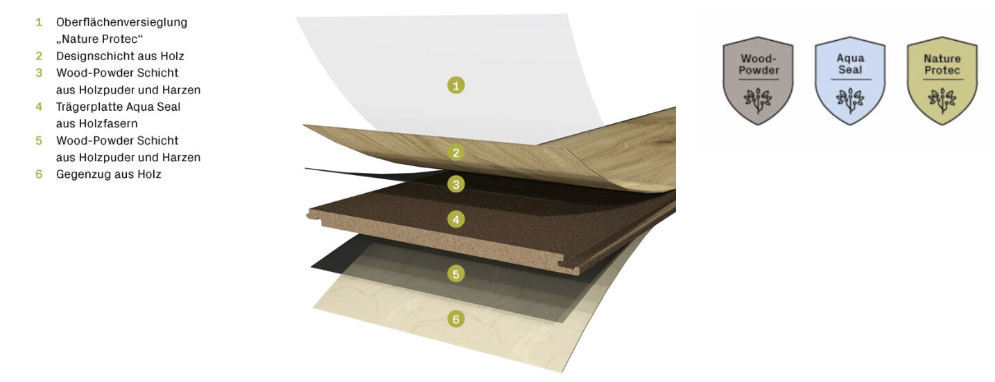

Today, we looked at samples of hardwood flooring and, in this context, the seller pointed out an innovative wood floor from the company Hywood.
According to them, this floor is significantly more resistant to dirt, scratches, and moisture due to its manufacturing process. The manufacturer claims that it can even be installed in bathrooms.
In addition, unlike traditional hardwood flooring, it does not require regular oiling. On top of that, it is about 20 euros cheaper per square meter (roughly 2 dollars per square foot) compared to the hardwood flooring we prefer.

SaniererNRW12319 Oct 2022 22:10Well, if I have to choose between a natural wood floor and this micrometer-thin design layer made of wood plus who knows what resin mixture, the decision is easy for me...
This is just better laminate at a significantly higher price—similar to how luxury vinyl plank is the more expensive version of vinyl flooring 🙄

The product "Hywood" is manufactured by the company "ter Hürne" in Südlohn, North Rhine-Westphalia (NRW).
The term "hybrid flooring" sounds revolutionary, but it is not! About 25-30 years ago, there was already this type of plank flooring, only back then it was known under the (non-standardized) term "veneer floors".
As is still the case today, a thin veneer layer—usually 0.15mm (0.006 inches) thick—is glued and sealed on top of a carrier material (according to the specifications for Hywood, this is an MDF board).
I would not classify this type of flooring as "real wood floor"; hybrid flooring sounds inconspicuous and, to avoid doubt, the thin veneer layer can be used to justify the term "real wood." However, this type of flooring does not turn into parquet in any way!
Whether this type of flooring can also be used in wet rooms is not known to me. The product datasheet does not specifically indicate this application.
The reason veneer floors were unheard of for a long time probably lies in
a) their low scratch resistance, and
b) the impossibility of surface renovation—just like laminate floors.
Since veneer floors are always delivered with a sealed surface, it is understandable that oiling and waxing (as regular maintenance measures) are omitted.
