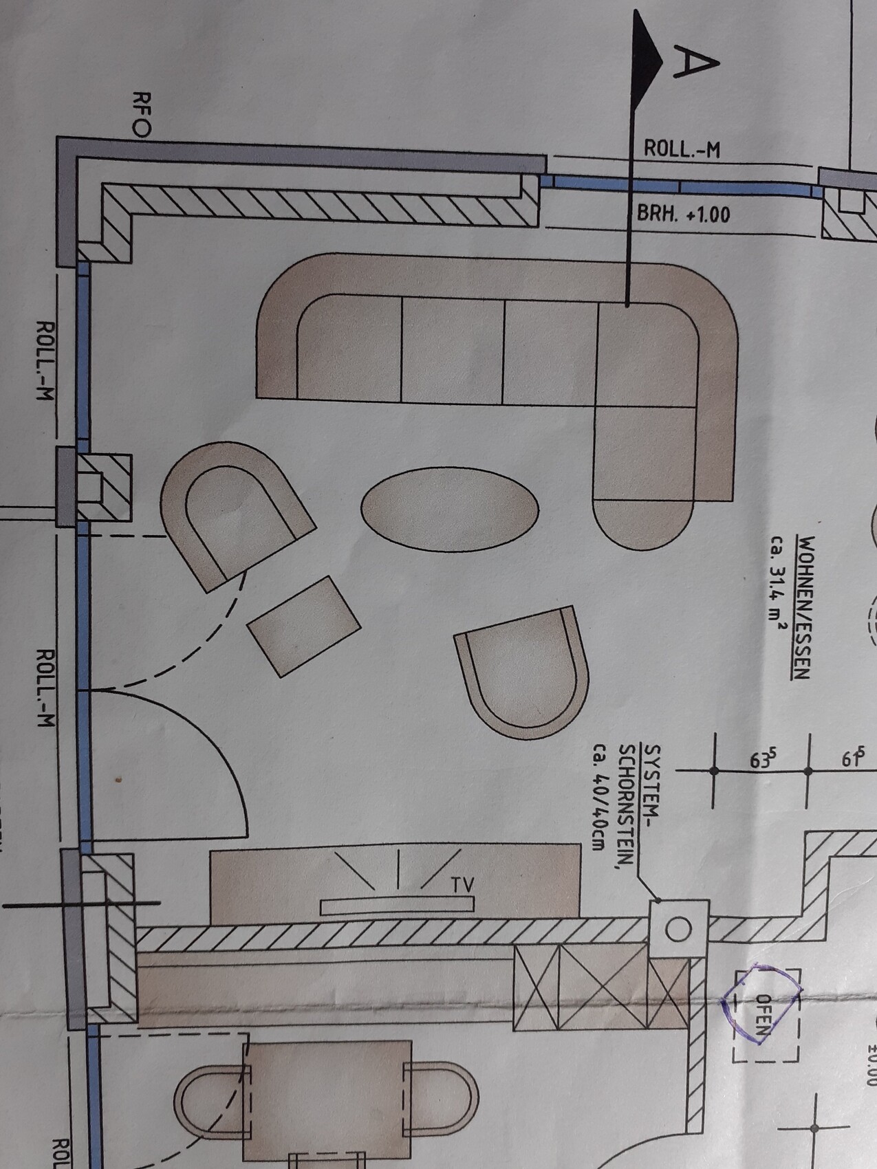

In our drawing, the kitchen window sill height is listed as +1.06 m (3 ft 6 in). To me, this means a sill height of 1.06 m (3 ft 6 in) measured from the finished floor. With a kitchen counter height of 0.91 m (3 ft), this would leave 15 cm (6 inches) for things like power outlets. This is also how the kitchen designer calculated it. Now the bricklayer says that the sill height refers to the structural shell and that an additional 20 cm (8 inches) must be added to the raw floor level for underfloor heating and the screed. Then the window would only be 86 cm (2 ft 10 in) above the finished floor, making it 5 cm (2 inches) lower than the kitchen countertop. That can’t be right. What is correct?

Heidi1965
22 Jul 2020 22:55
Floor plan of a living room with U-shaped sofa, oval coffee table, armchair, TV area, and doorway
Modern kitchen with light-colored wall cabinets, oven, electric stove, sink, and kitchen island with window.
Sketch-style kitchen view featuring stove, sink, window, and cabinets.

Heidi1965
22 Jul 2020 22:56
The plan is from the architect.
