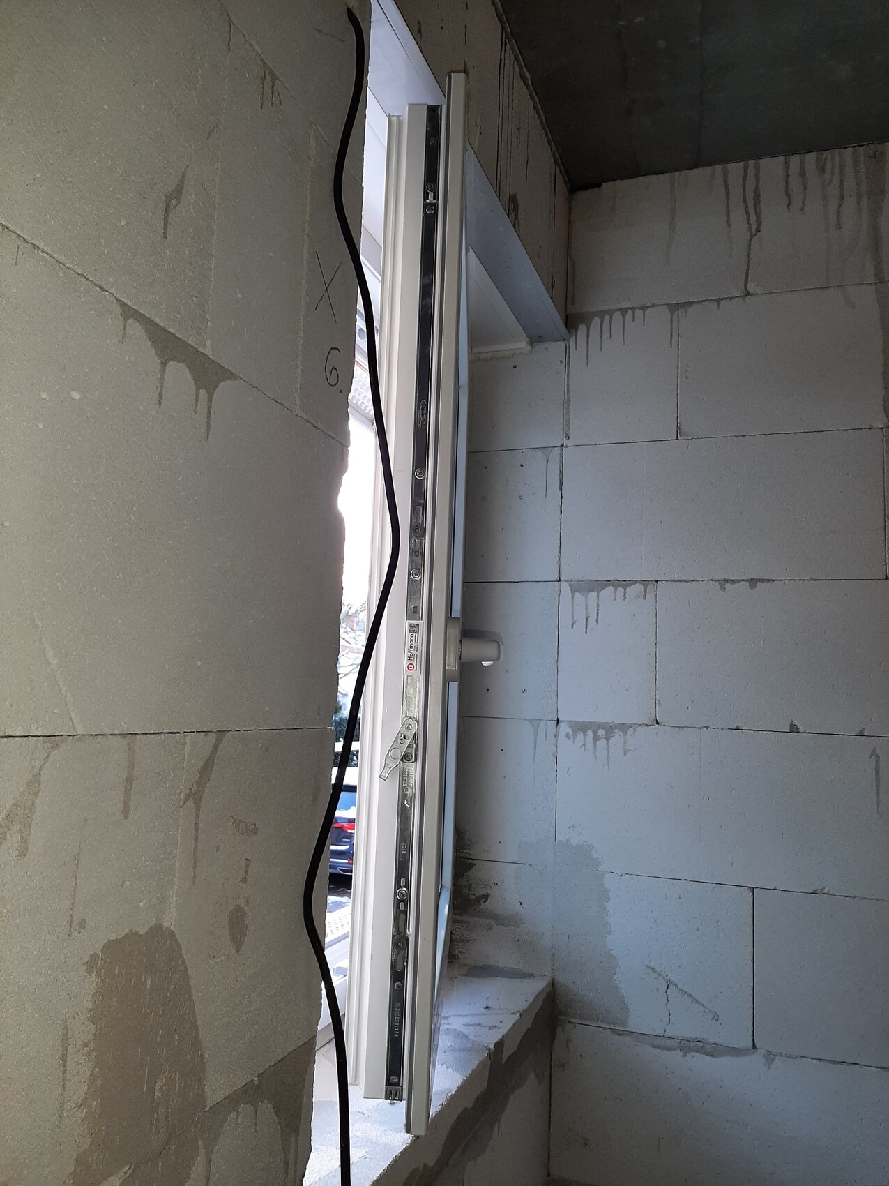

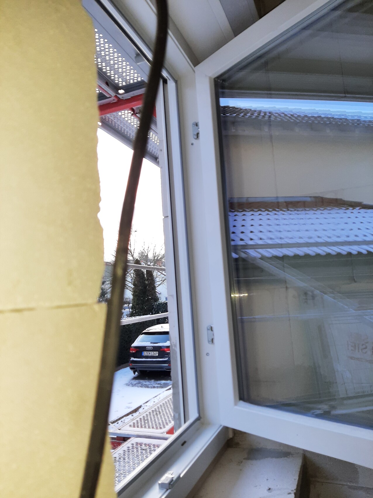

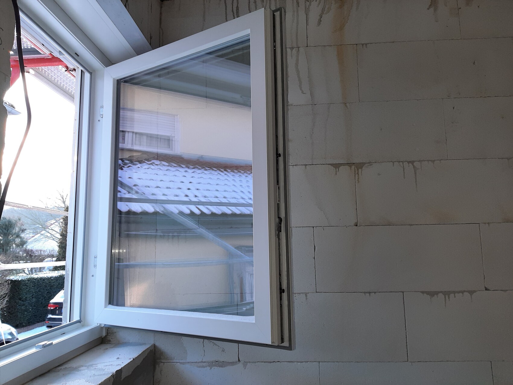

Here are pictures of the windows:
1. Height 113cm (45 inches), width 100cm (39 inches), 2 mushroom locks and 2 frame fasteners (3 pictures)
2. Height 128cm (50 inches), width 100cm (39 inches), 2 mushroom locks and 3 frame fasteners (1 picture)
