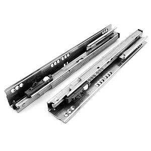

It depends on which manufacturer you have. IKEA in Germany has sold either Hettich or Blum drawer slides under the name Rationell (Tandembox type with minor modifications), depending on the catalog year. Take a photo of the cabinet rails with the drawer removed and show it to us.
Alternatively, check if the rail is identical to this one:
Blum Tandembox cabinet rail 578 plus BLUMOTION
Item No.: 89111612000
Another option would be to replace the entire drawer slide with a new one from Maximera. It generally fits into the cabinet, but you will likely need to drill new holes in the cabinet and on the front panel.
